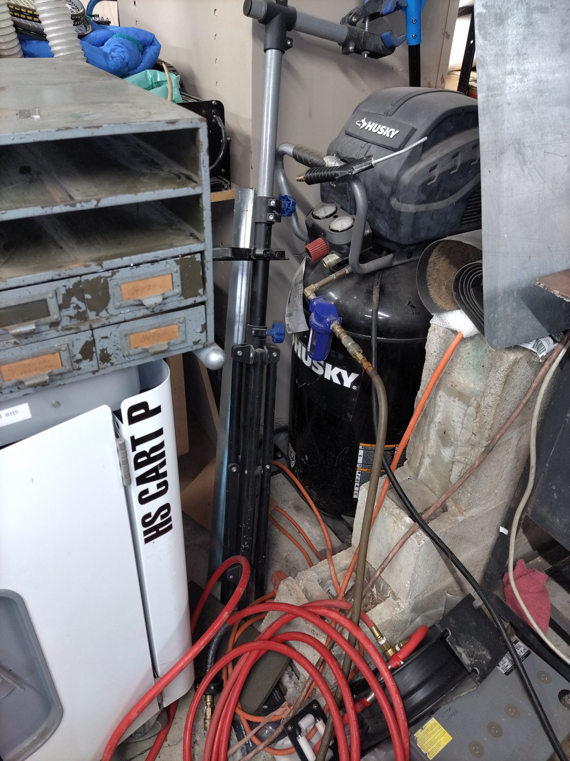

I have a run of the mill Husky compressor from Lowes. I wanted to put it outside to free up space in the shop and cut down on noise. I have a complete dry area under a roof to do this. What other considerations should I be concerned about. I probably need a better air drying system and have ample access to the petcock on bottom. Anything else I am missing?

Personally I don’t think the juice is worth the squeeze..
How much space are u REALLY gonna free up.??
I’ve got my 60 gal. in the corner and it isn’t that loud..

Freezing ... Water in lines, tank, regulator, etc. Cold start if oiled.

It doesn't look that tall, how about building a riser that would get it up near the ceiling. That would free up the space below it.
Years ago I helped a friend mount his compressor on the top shelf of his storage rack. Bolted it fast and ran the drain line down and into a catch can.

I have same compressor in one of my shops. Been a decent small compressor, but outside, even under a cover, it’ll look bad in a few years.

Ok, consensus is keep it inside, I can make that happen. I don't want to screw the thing up. just because I want another 3 sqft of floor space. Thanks TBN brainstrust!
