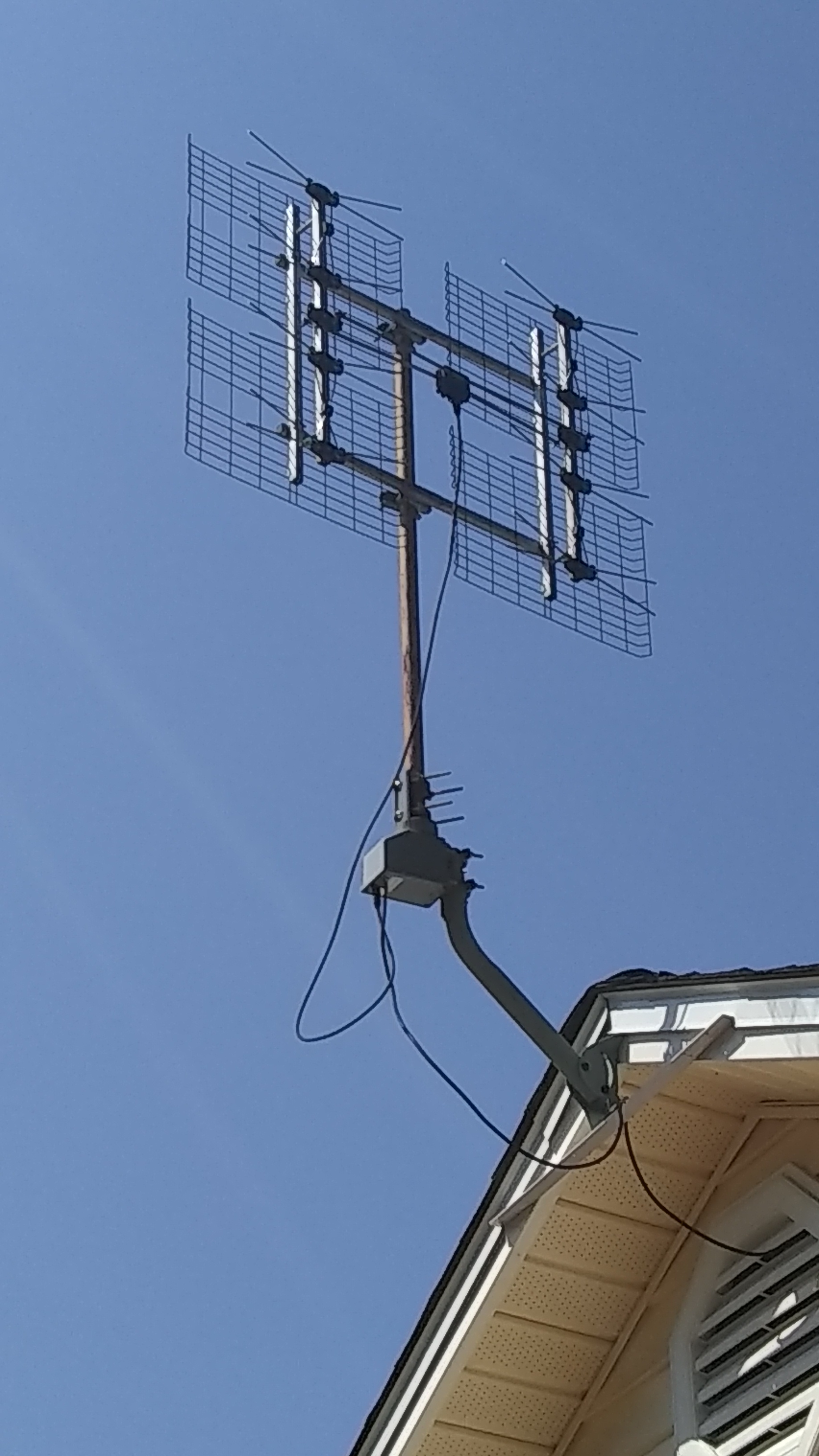

I've been looking at the different Channel Master models, but wasn't sure which one you had until you posted the picture.

I have a similar size/type made by Atennas Direct. It's mounted to a no longer made Eagle Aspen rotator. It's a pretty good setup for me however most of the station antennas are only about 15 miles away. I need to relocate it to the other end of the house because I have a large oak between it and the station antennas.
My PBS station is in the opposite direction and 40 miles away. I can get it and most of the network stations perfect. I have one network that is flakey at times. It's odd because their tower is located on the same property as the other networks.

im about 90 miles from the broadcast towers straight shot with hills in the way. the installer said he installs different antennas in different areas. he had some sort of signal meter when he came out and checked on the roof first. said he wouldn't install an antenna if he couldn't get a good enough signal.

some digital tv channels are on VHF, so don't buy a UHF only antenna!.. look here. https://www.fcc.gov/sites/default/files/antennas_and_digital_television.pdf
This is a very important point. Go to antennaweb.org and enter your address, then look at the resulting list of stations. If any desired stations show the RF channel of 2-6, you need a vhf low antenna. If any are 7-13, you need a vhf high antenna. In our Mid-Atlantic region, all local broadcasters are VHF-high or UHF, so I use Winegard HD7698P, which works very well for our needs.

I just went to antennaweb and put in my zip code, then clicked on the link to suggest an antenna for my area with Channel Master. It came back with this.
CM-4228HD EXTREMEtenna 80 | Channel Master
I think this is the same one that you have.

Your KLTV is on channel 7 which is a VHF-High channel. At roughly 15 miles distant, I don't think that 8 bay UHF antenna will be a problem though. You might be a little better served by using the CH-4221HD 4 bay UHF. The reason being that it has a broader capture area. You might even get by very well with a little Eagle Aspen 2 bay UHF for $20 ( DTV2BUHF) or an Antennas Direct DB-2.
The biggest challenge for reception in Tyler, TX is that the four potential broadcasters are in four different compass directions, from 17 to 180 degrees. Terrain likely makes one of the four less likely to receive. I'd get the biggest antenna reasonably available, plus an amplifier to overcome coax and splitter loss.
