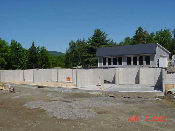

Wsp617 (op) When building new, you have an oportunity to build with some of the "newer" thinking on insulation. You don't need to live in some weirdo caazy "greenie guy" *house. Conventional construction can be built to give you an excelent insulation and more importantly air infiltration results. Every penny spent on insulation will benefit you regardless of how you heat it. The savings can be a big difference both in heating and cooling. Those savings will continue month after month, for the life of the house. I did this on my place, being in the building business all my life, I was amazed at the return on investment over a "normal" or "to code" insulating job. If you have the opportunity, a few small "free" choices can also be made to reduse your heating needs like "orientation" of your home for some solar gains, minimise windows on the north side, etc.
I think one problem with any non traditional heating systems is that they are sold by the s/f of the bldg. A proper heat load needs to be done for your particular home and your window count and "u" rating, wall const. & insulation, etc, will all be considered and make your heating & cooling work efficiently and comfortably. I know that it is easy to just go with the "normal" insul. job, esp if your making dicisions in the spring or summer, but if you double your budget, it will pay you back soon.
First start by thinking about how you're going to keep your heat in! Then about how you're going to make it.
* not a derogatory comment on anything! It's just a hard sell for the general public.
Greenie Guy! Hey, I resemble that remark :laughing:
The pic on the left is my house at the point where all the concrete work was done and we were ready to start framing. You can see it is very similar to a walk-out basement that is facing south. The only difference really is I have several interior concrete wall sections to add thermal mass (absorb and store heat). The building behind the house is a 28 x 48 garage which is also earth-bermed on the north and west ends.
The second pic is from this summer when we had our solar pv installed, you can get an idea of how the house looks finished. It could be sided with anything, I prefer the low maintenance of vinyl, even if it isn't the prettiest thing around. For more money, more attractive windows could be have been used. The large windows were running about $115 each in 2006. They are a commodity-type commercial store front unit.
RustyIron is correct that some people just aren't going to see this as a traditional home no matter how cheap it is to heat, and banks may turn up their noses too.
If you prefer a traditional look, then I recommend looking into Passive House designs: What is a Passive House?
Whatever you do, think carefully about building an energy dinosaur and the money and comfort you will be throwing away for years to come if you build one.
Sorry for derailing the OWB question, but I am not sure you are asking the right questions, so to speak.

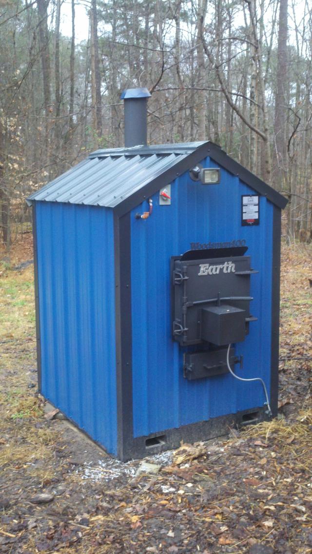

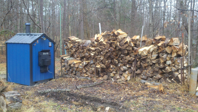

21 years for us. We live in NC and installed a Hardy woodstove in 1992 and just replaced it this year just because it became high maintenance over the last year or two. Generally just small issues like having to replace a pump or valve, but we had a small leak that was giving us trouble so we just decided it was time to purchase a new one.
After much due diligence, we opted for a Woodsman 400 Woodsman 400 Series because 1) has a good warranty 2) the dealer will service our area 3) has an ash cleanout and 4) is simpler, less to go wrong (circulation pump runs all the time instead of controlled by thermostat).
Too early to tell, but i'm happy with the quality construction so far. The biggest difference we are trying to get used to is the fact that, since the Woodsman is more efficient, when we look out the window we dont see any smoke.
