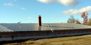

Dave 1949- Cool house, is your (unseen in pics) roof burried also?
No, I am not that brave. Too many horror stories about leaks. Maybe in a drier climate I would try it, I do like the concept.
One thing I didn't figure on, is I have to clear snow from behind the house with the tractor so the next storm/slide-off has somewhere to go. That 4' height gets filled up pretty fast.
