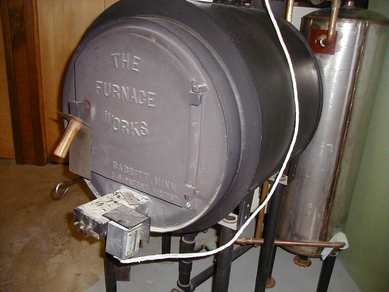

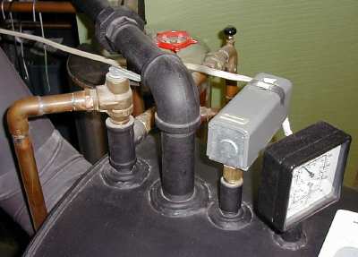

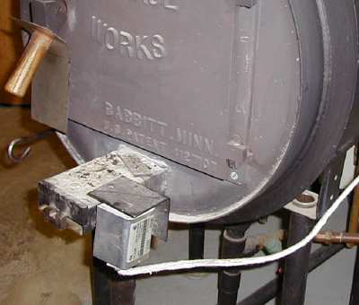

I have had a round boiler heating my house for just close to 35 years now. It basically consists of two round tubes, one 24" diam just inside the other 28" diam to form the water jacket that is about 9 gal. Easy to make if can get the steel rolled. The draft is controlled by an aquastat that opens and closes a damper to shut the fire down.
The only tough part that I see is getting a door that will seal tight. It has a pressure relief valve and is not much different from a regular domestic hot water heater for controls. As said, it has worked well for 35 years. I figured if it stopped working, I'd have another welded up. The company in northern MN went out of business a number of years ago. The door and frame is a cast part and possibly a substitute could be found.
A couple pics.
The length of the inside tube is about 3" longer than the outside jacket tube. 6" flue thimble in the back. This one takes 20" sticks. The stainless steel tank to the back is a 30 gal pre-heat for water going to the domestic hot water heater. Just pre-warms the cold water. Works by gravity, and this is a closed system.

I've heard that one of the companies around here will sell you a complete door and latch system, but even with a very good air control system they still burn a lot of wood (inefficient) due to the cool burn temp. Firebricks are a good step in increasing the temp.
My air control system works well, and does shut down the fire so there is less than a 10 deg rise above the set point. There are no firebricks (I see no practical use for firebrick as I want the wood fire heat to go directly into the adjacent water), as the water jacket is all around (except for the ends which are 1/4" plate). The fire temp at the steel doesn't get more than the temp. of the water in the jacket. An ash bed on the bottom and the efficiency is pretty darn good (as long as the wood is dry).
I've never seen a need for more than the 9 gal of water jacket. The water heats up fast, responding quickly to a quick fire when the damper opens for more draft and the house runs call for heat. When the room temps are satisfied, the water temp rises to set point, and the damper closes. No big swings in the water temp that I'd expect in a large gallon supply. Must be the reason the outdoor units try to keep water temps at 180 deg consistently. I'd look at that as a waste of energy.
As implied, it is a simple, easy-to-build system with simple parts and simple control. It works very well.
