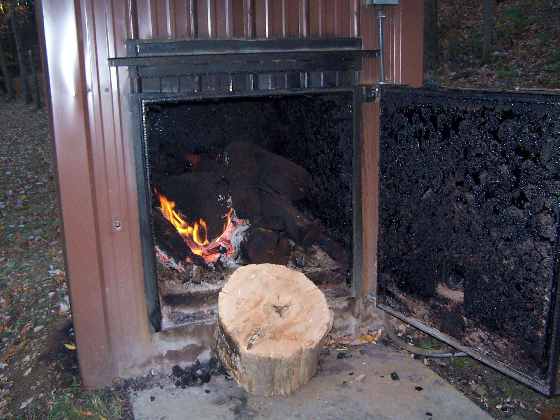

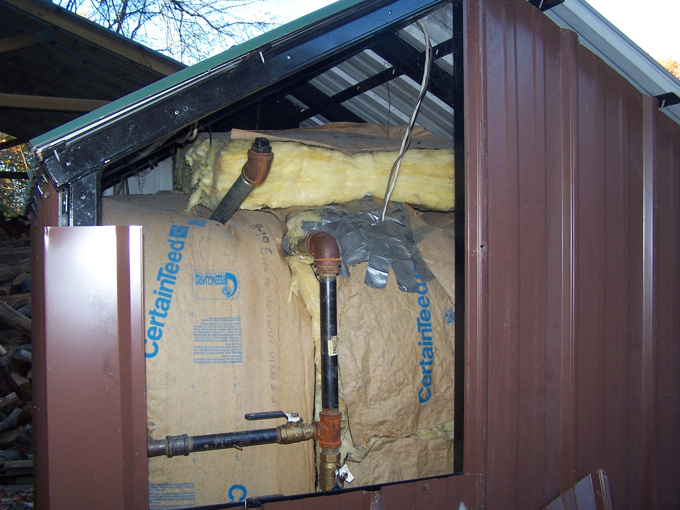

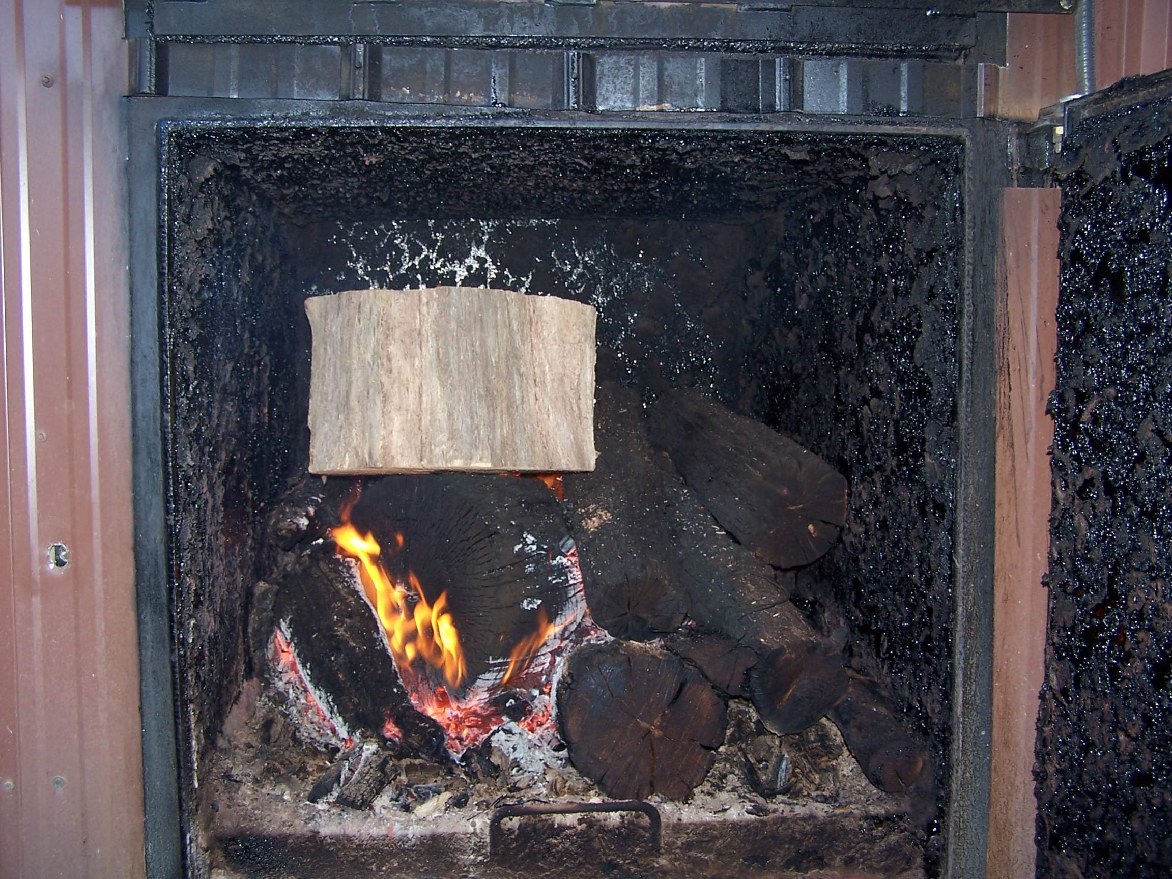

This is the picture of the wood boiler I was given last year. It looks similar to beenthere's. I currently have one of those US Stove indoor Furnaces. It works ok, eats alot of wood. I was thinking maybe the boiler was a better alternative for my 1000sq ft cottage with very little insulation. I'm really sick of waking up cold and didn't know if radiator heat would keep it a little more even.

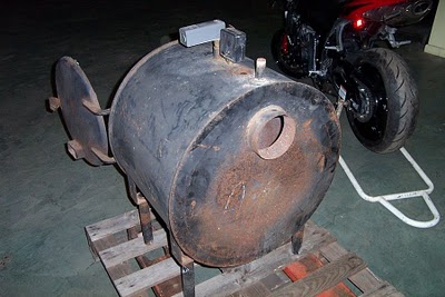

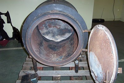

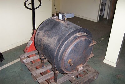

Yours sounds really similar to what I want to build can you give me a idea on how much area you heat, burn times? Can you also post some pictures and maybe some more information on items used. Thanks
I agree it sounds like the direction that you are heading. Jeepnford is correct in saying that you can get the basic info from Deb Design. I will try to get some pics tonight. I did and would change a few things from the plans that I can share. Things like the draft/blower assembly ( maybe delete the blower), better thermostat and so on.

I'll give you my 2 cents on the draft blower. I have a Aqua-Therm 145 outdoor wood boiler. It is basically a barrel (firebox) in a barrel (water jacket). It does have a draft blower and I think you will want one. Unless you like alot of smoking and have good seasoned wood I'd put a draft blower in. A couple of people in my area have older Central boiler OWBs without a draft blower and those things smoke alot. I get compliments on how little mine smokes. Think about it, when the aquastat calls for heat it opens the draft door to restart the fire. With a draft blower and flap it opens the draft and starts the fan. Your fire restarts quicker and gets up to temp quicker with less smoke. My OWB smokes the most when the aquastat closes the draft flapper and shuts the draft blower off (smoldering the fire). Like I said, it works better with green or damp wood also. I reseached building my own and I was going to, but ended up finding a deal on my Aqua-Therm used. When my Aqua-Therm dies I'll most likely build my own replacement. Have you ever took a look at the Seton style OWBs? They are a different design and use a heavily insulated firebox with a steel tube heat exchanger in the exhaust path. They look very easy to build and I'll most likely go that route when mine gives up.
