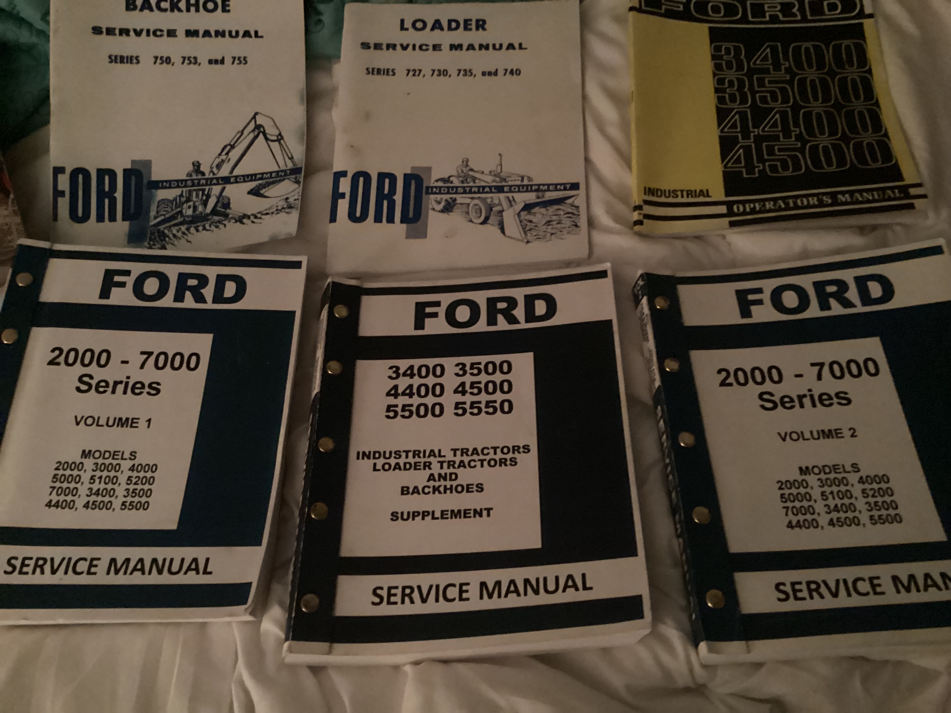

Yes, I have all the manuals you’re right my mind is going. I forgot I had them. I’m gonna go pull them out today. My wife’s husband is an idiot.

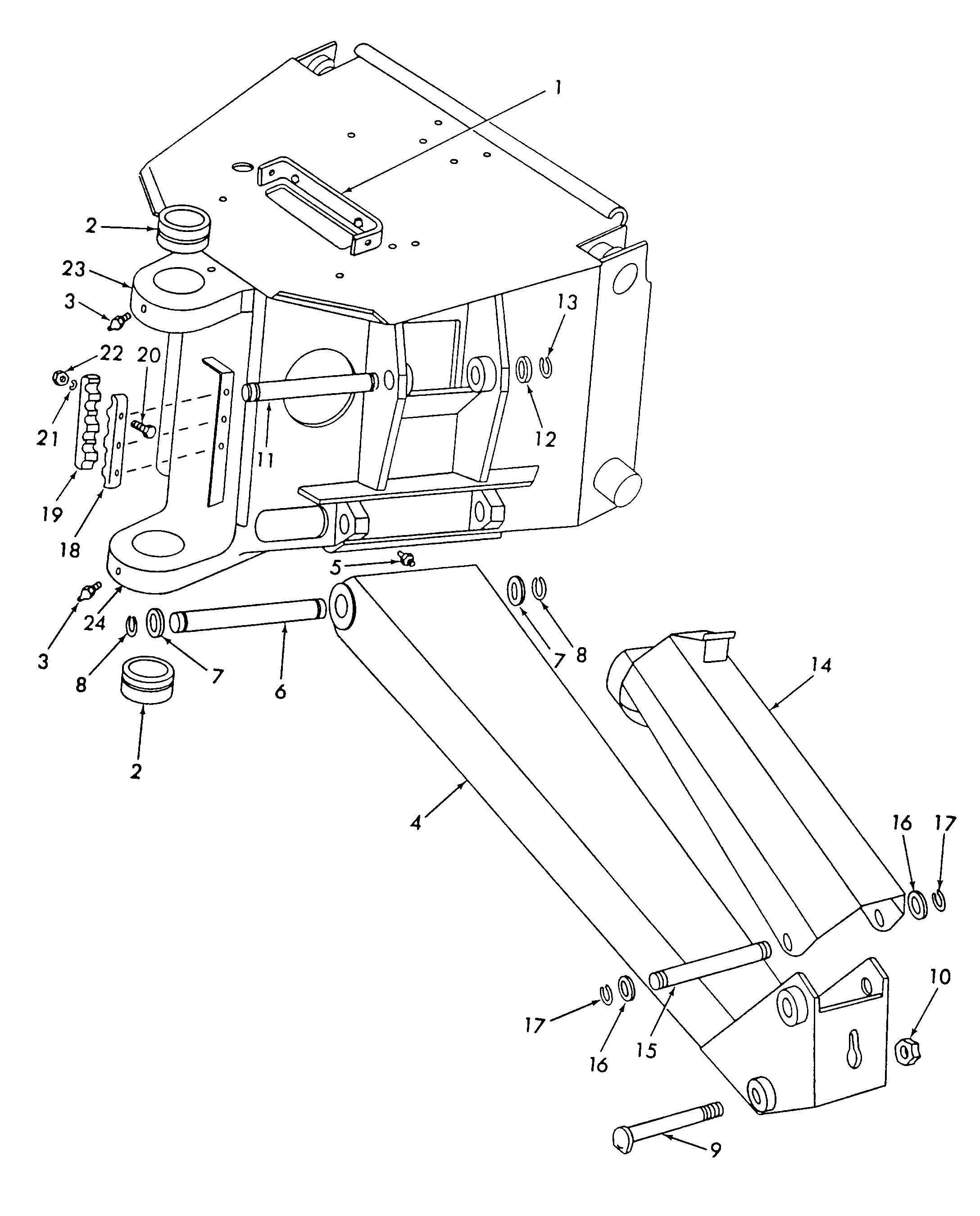

I spent a few ours going over my manuals could not find any good diagram went to parts book for pivot rod and bushings no luck will try again
   / Outrigger levers Ford 4500 industrial stuck together
#17
Look at the picture. Top and bottom pivots
OK, I am getting ready to take the pivot rods out to check them out to see if the bushing is bad but first I’m looking to see if I can replace those pivot rods and or bushings. Where could I find those parts? I have tried Steiner Tractor no luck.
