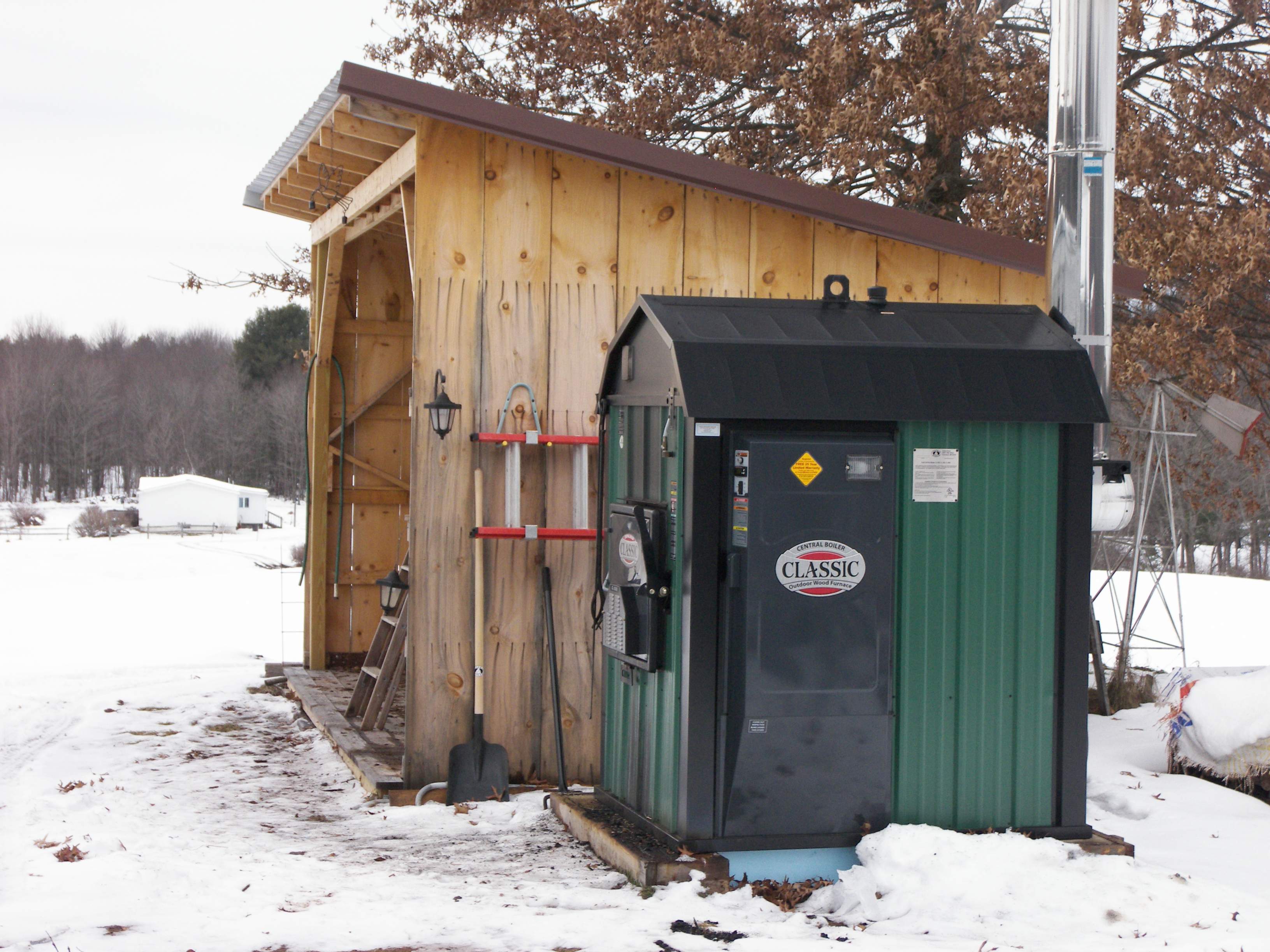

View attachment 280124I have a "Classic" outside Central Boiler that is not EPA certified and to be honest i really dont care either. I have had one for 4 years now and its great! in fact we have 8 of them in our family. Ours doesn't eat wood like people would think, their very easy to tend to and the mess is all outside and risk of a chimney fire is non threatening to your house. I burn only seasoned wood but can burn any type of wood (meaning hard wood or soft wood) with the same heating results only thing is soft wood . . .(IE, pine, hemlock . . .ect) leave no coals and when the woods gone so is your heat. I'm heating 1600 sq ft of floor space averagiing 78 degrees and last year burning 9 months i used 12 face cords of 20" wood. i have my own wood, equipment to cut and move it so and OSB is a no brainer for me. When i cleaned my OSB out this june all the ashes fit in the bucket of my Kioti FEL bucket which is a 66"er. it looked like "baby Powder except greyish in color. For me, no one can ever talk me out of my OSB, nor will i allow any one to shut me down from operating it! I LOVE MY CENTRAL OUTSIDE BOILER! ! ! . . .John
