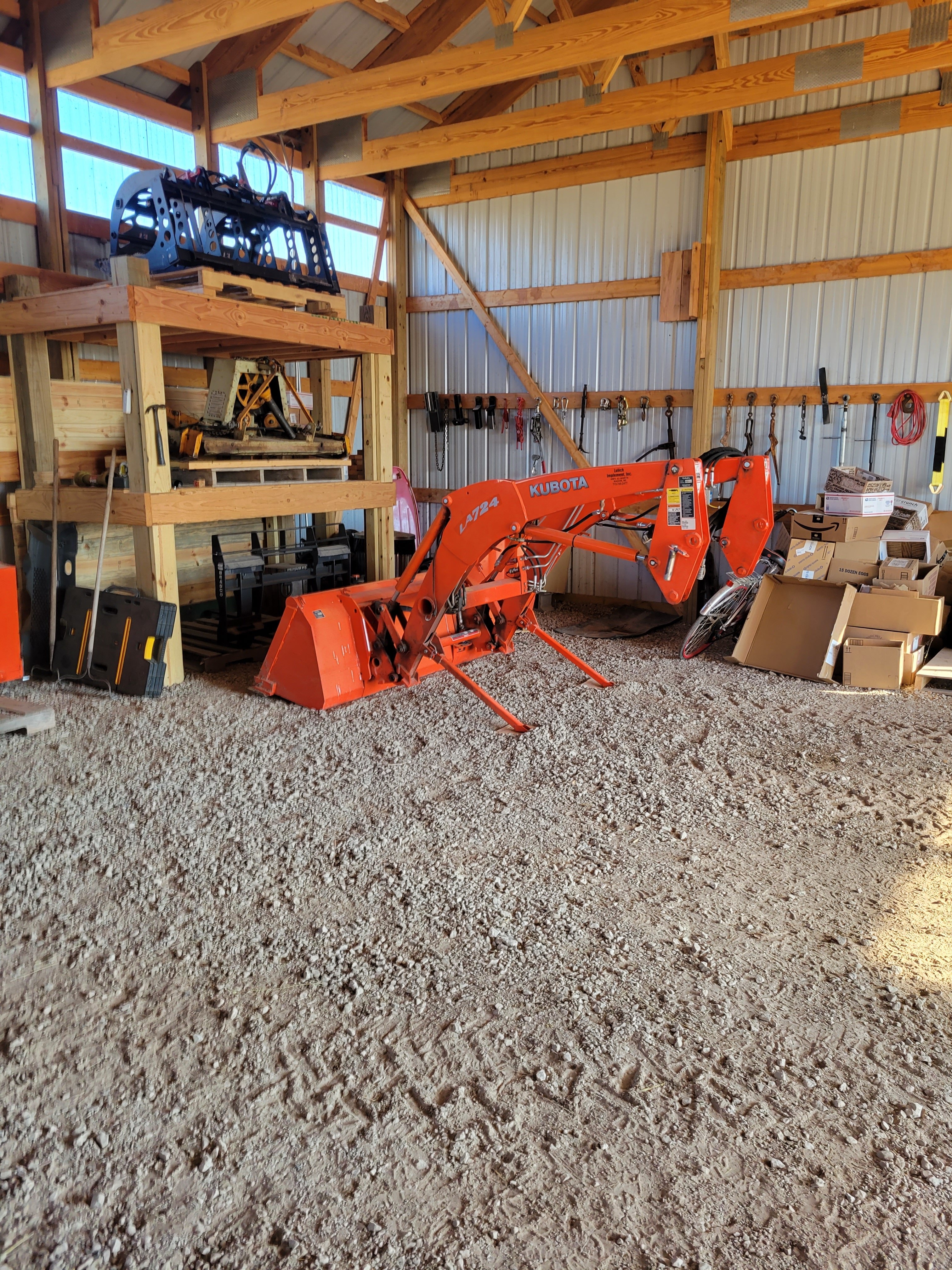

Build a shelf. You should be able to get your zero turn on top and storage for something on the bottom. I have forks, Woods
RM48 and grapple. Saves space.
