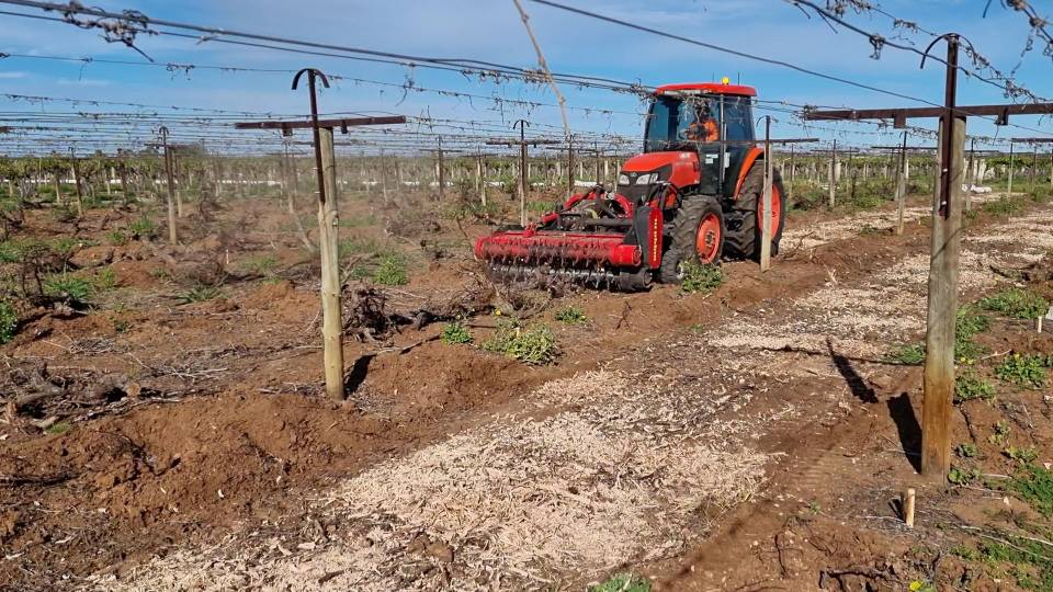

Hi,

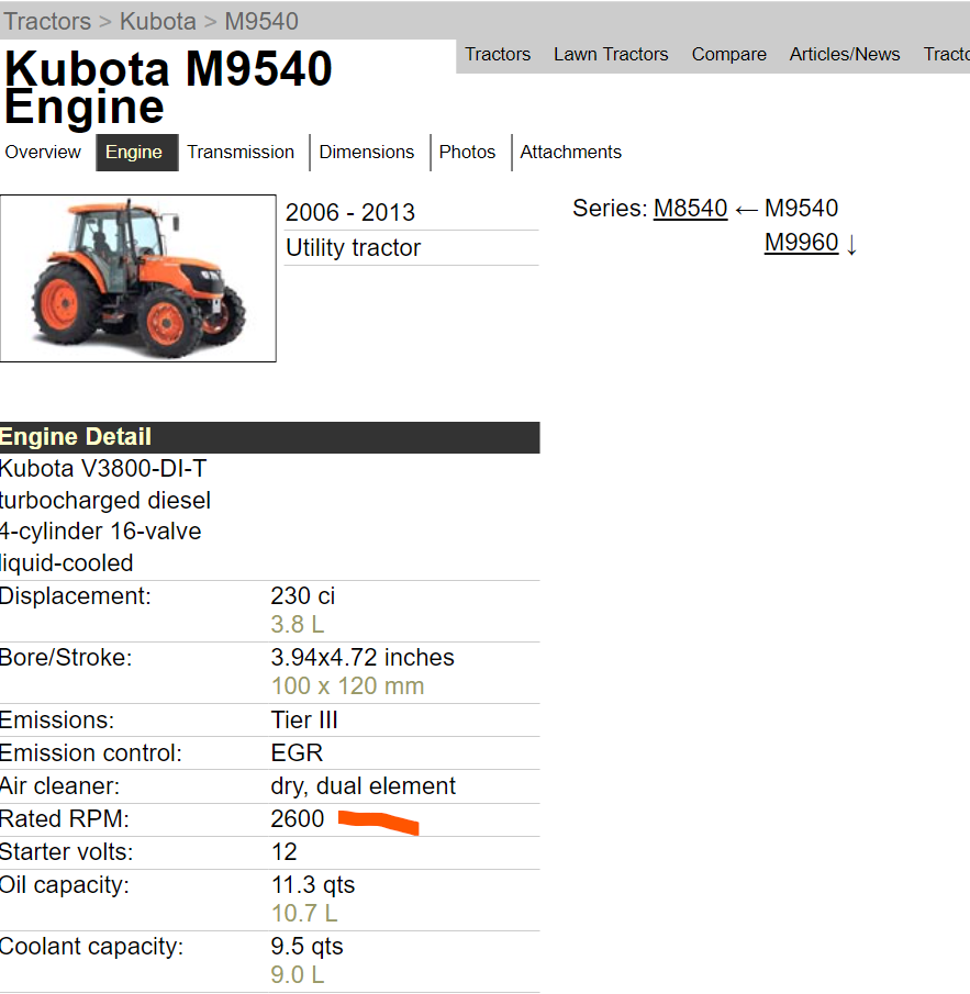

A friend recently bought a M9540 with a front 3 point linkage to run a mulcher. He's new to tractors and he was complaining about it overheating, then he proceeded to tell me it is running at 2600rpm. I have very little experience with kubotas, is this normal? It seems very high and can't be good in the long run.
/ Overheating M9540 #2
According to Tractordata.com Kubota M9540 engine is rated at 2600 rpm. Are radiator fins free of debris? It's possible thermostat is stuck. What condition is fan belt & is it snug. When engine is cool remove radiator cap, start engine & look inside radiator neck for tiny bubbles. Bubbles indicate engine compression is getting into cooling system.

Sounds to me like it could be a number of issues but most likely a plugged with crud radiator. Tell him to get a Radiator Genie and clean it out and clean it often, along with all the other heat exchangers out front like the charge air cooler, the AC condenser (of it has one) and the transmission oil cooler. as well. I clean mine daily when farming, every evening.
In fact I carry a small HF Bauer 20 volt blower behind the seat to blow out the rad and components in the field if chaff gets to be an issue. Only takes a few seconds to clear them.
Any implement like a mulcher out front will produce a lot of chaff and fines that get sucked right into the radiator immediately. Overheating the engine consistently will eventually cause severe mechanical issues.

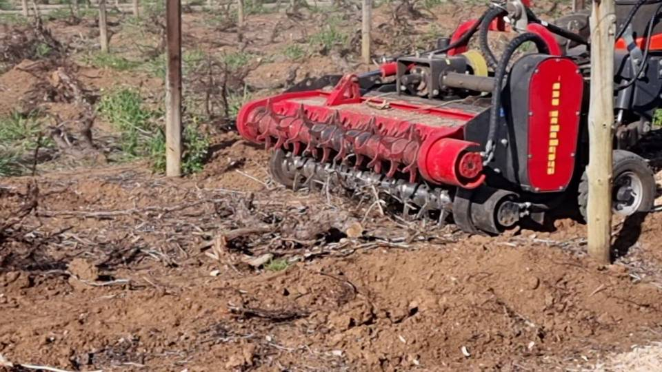

With any front mount PTO implements kicking up dust, you are bound to get the radiators dirty, which will raise temps.

Best investment I ever made was a cordless blower, in my case a Bauer 20 volt blower with a concentrator (tapered snout) on the business end. I carry it behind the seat and blow out the rad from the fan side out when I'm out shredding or running hay, the chaff always finds it's way into the radiator.
Not expensive either. Tool only is about 35 bucks.
