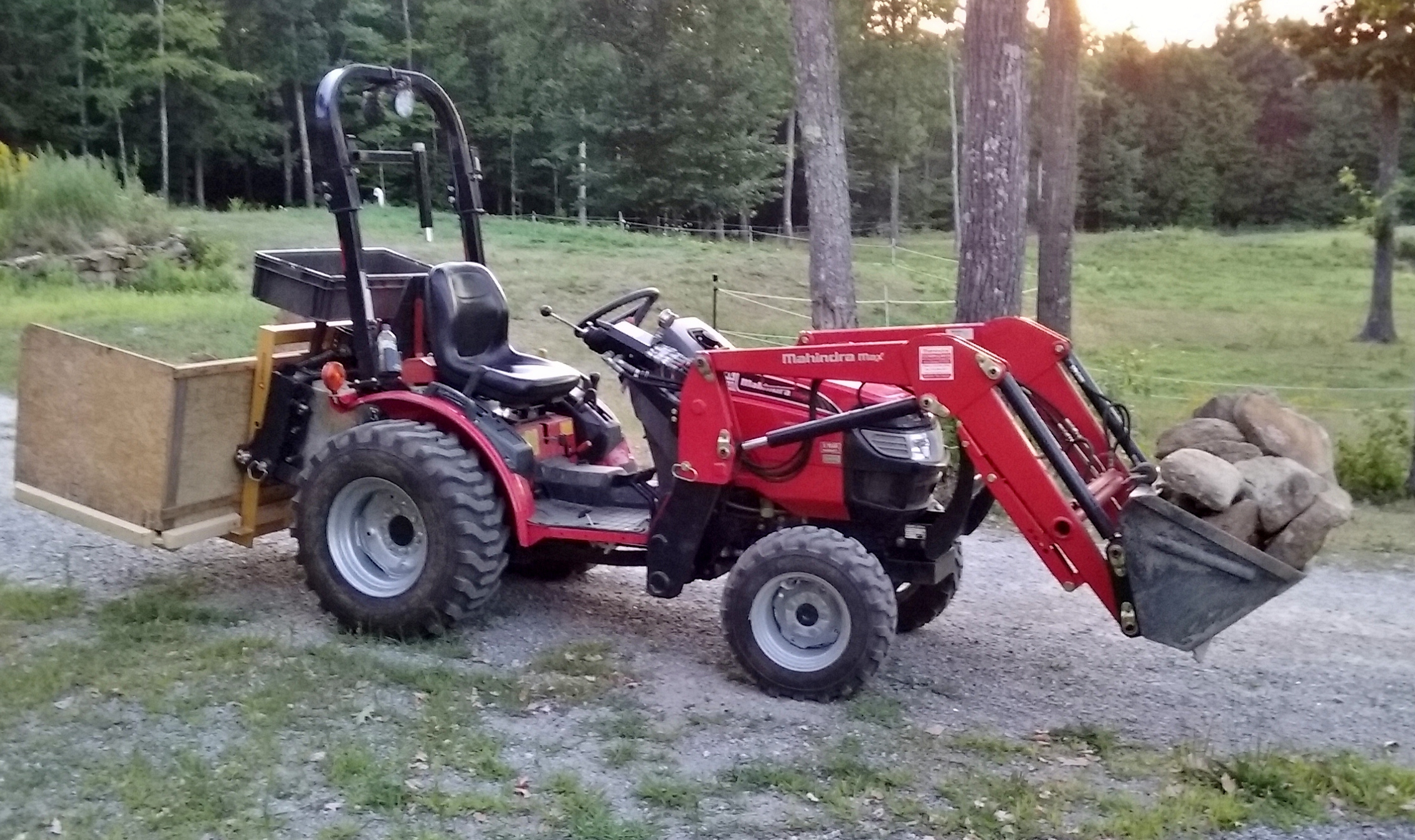

+Overladed, it should go into relief before it breaks, but hit a big bump at speed, something will give.

Nice "scoop job" on the bucket load of rocks....wish I could do that...:D
