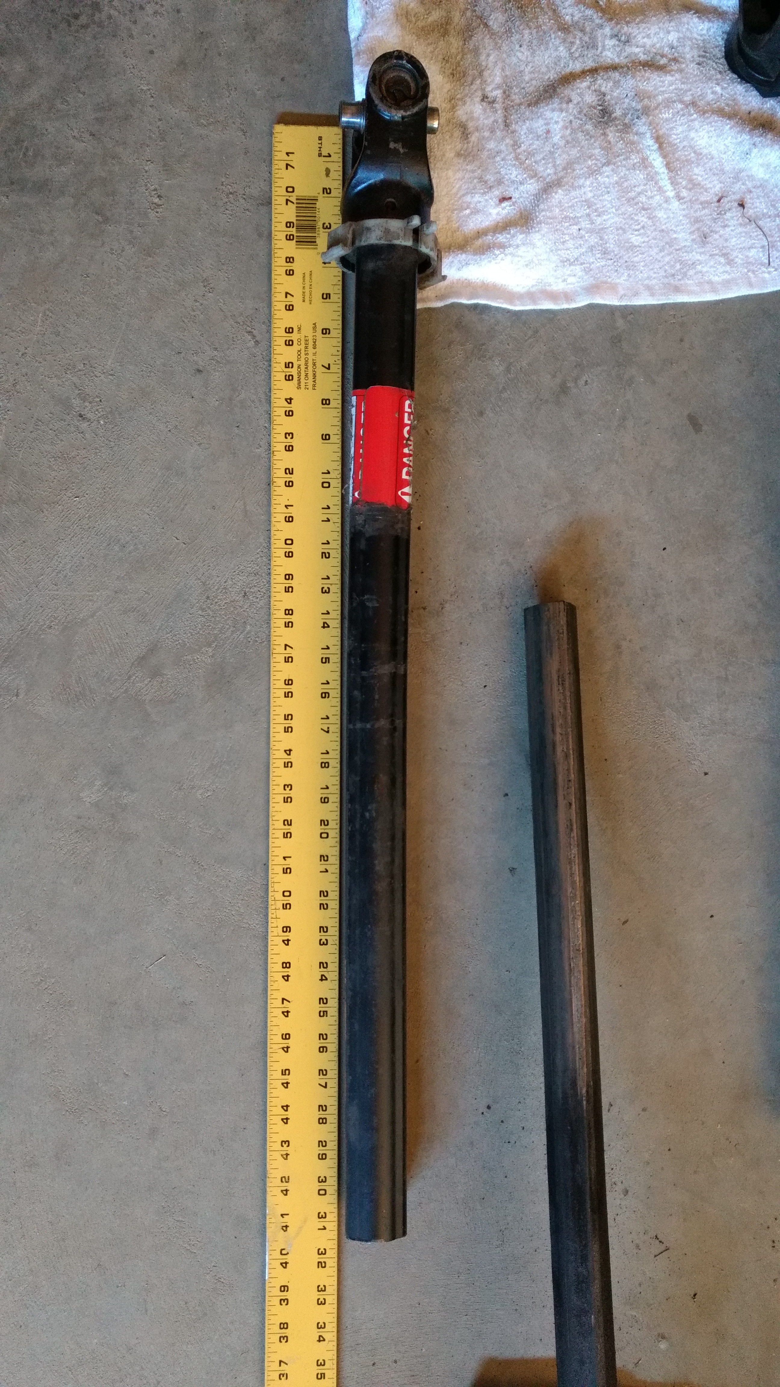

Took some pictures of the carnage.
Here's one showing the bend on the "shaft" piece. Also shows the "tube" piece, and from that you should see how well worn it is (metal is really gouged up; and, the range of travel seems pretty well established, predating my use); there seems to be a slight distortion in this piece, though it's very slight (almost looks like it twisted a bit). The pieces don't slide together fully, which shouldn't be any surprise. I failed to fully inspect the PTO shaft before and after purchase.:eek:
Here's one showing the slip clutch and the U-joint there. Kind of hard to see, but one of the end caps is cracked/broken. And the U-joint itself is loose/failing.
Note the pin walking out in that second picture (tube yoke). I'm wanting to say that it's happening on the shaft yoke as well. That rust isn't new!
The shaft yoke is beat up from the event I encountered. I suspect it's not reusable. And given that the guard is also beat up it's looking like I'll be needing everything except the slip clutch (though now I'm not certain what condition that it is in- I thought that I was able to get it to slip; I set it to just shy of spec (a bit looser).

Time to buy a new shaft? The Bare Company PTO shafts that Washington Tractor sells are really nice.
   / Overstressing PTO U-joints? #33
No question about it, buy an entire new shaft assembly. If that means a new slip clutch, then so be it. Cut it to your tractor/implement distance and keep that shaft dedicated to that implement only.

Yeah, pretty much figured this thing was toast. Wanted to know what may have happened so that I don't replicate this situation.
Rock knocker, thanks for the pointer there. I will talk to these folks and see if I wouldn't be best off with a 6 series shaft. They mention that one should reduce the HP rating by 40% for severe duty. I don't think I'm operating at a "severe duty" level, but it's not a bad idea to be a bit beefier. Series 6 is rated 64hp (PTO), and de-rating by 40% gives 40hp; tractor's PTO is rated at 43hp (it's an HST), so I'd be pretty close here. Also, the shaft length seems more appropriate: 65" open and 39" closed- I will remeasure, but I believe that I was about 58" open (maximum, a distance that I wouldn't likely see when in use, but it's the physical maximum based on my top link's extension); minimum number looks good as well; I'd have a normal working overlap of about 14" (vs. 6 1/2" with the series 4).
No pricing info, but would I be correct in figuring that I'd be looking at around $500?
I'm really figuring that the previous owner was undersized on the PTO shaft. As mentioned, I'm guessing his JD was about 45hp, which is about 37hp at the PTO. He ran this thing in what was obviously a "severe duty" application. A series 4 PTO wasn't the right match, especially if he didn't adjust the slip clutch properly (if ever).
It looks to me (by way of your photo) that the shaft is too short for the application. The previous user simply used a shaft that he had 'at hand' that 'sort of' fit and he wouldn't have to spend money on an extra, new one.
My recommendation is to measure the distance from your PTO to the implement (whilst mounted) and take that measurement to wherever you decide to purchase a new shaft. Do Not take the old shaft, or the measurement of the old shaft, as a guide.

Wagtail, the previous owner had said that he had to buy a new shaft because he couldn't get U-joints for the previous one. Although he seemed like an honest guy it's hard to say what the real story is: clearly, it was disingenuous for him to make this point as it inferred that it was a good shaft, and, clearly, it was not. Yeah, not going to use this one to spec out a new one: I've talked to a local tractor dealer and they told me to bring it in- I told them NO.

Well, Washington Tractor punted on me. I'd asked if they could find out if I was OK to run a series 6 shaft on the Bush Hog 286 and they said they'd check with Bush Hog. The next day (they were prompt!) they left a message telling me to talk to the Kioti dealer (I'd told them I had a Kioti). Lame... SO, after more research (and everyone here's input) I think that I'm a fair bit wiser and should be able to locate what I need w/o the assistance of the "professionals."
I measured 58 1/2" from tip to tip: cutter disconnected, so it's perhaps a little on the long side (cutter sitting down on the ground). I think that in the EA video Ted measures to one of the notches; that adds 1 3/8", so 58 1/2" plus 1 3/8" comes out roughly to 60". Reading on Royal Brass' web site they mention that shaft overlap should be no less than 1/3 the compressed length. If I take my 60" and divide by 1 1/3 I get roughly 45" as my collapsed size.
I'm going to measure the possible extremes (based on full extension and collapsing of my hydraulic top link) just to check that the shaft overlap could be properly maintained.
Realizing that I've bought several implements from EA (and that their video was mentioned in this thread!) I decided to see what they offer in the way of shafts and, lo and behold, I see this:
Class 5 Eurocardan PTO Shaft for 5, 6, and 7 Rotary Cutters
Series 5. 45" collapsed.
Pretty sure that this is a perfect match. And looking at it I can see how TOTALLY wrong the previous shaft was (not only for MY use, but almost certainly for the previous owner's use as well).
