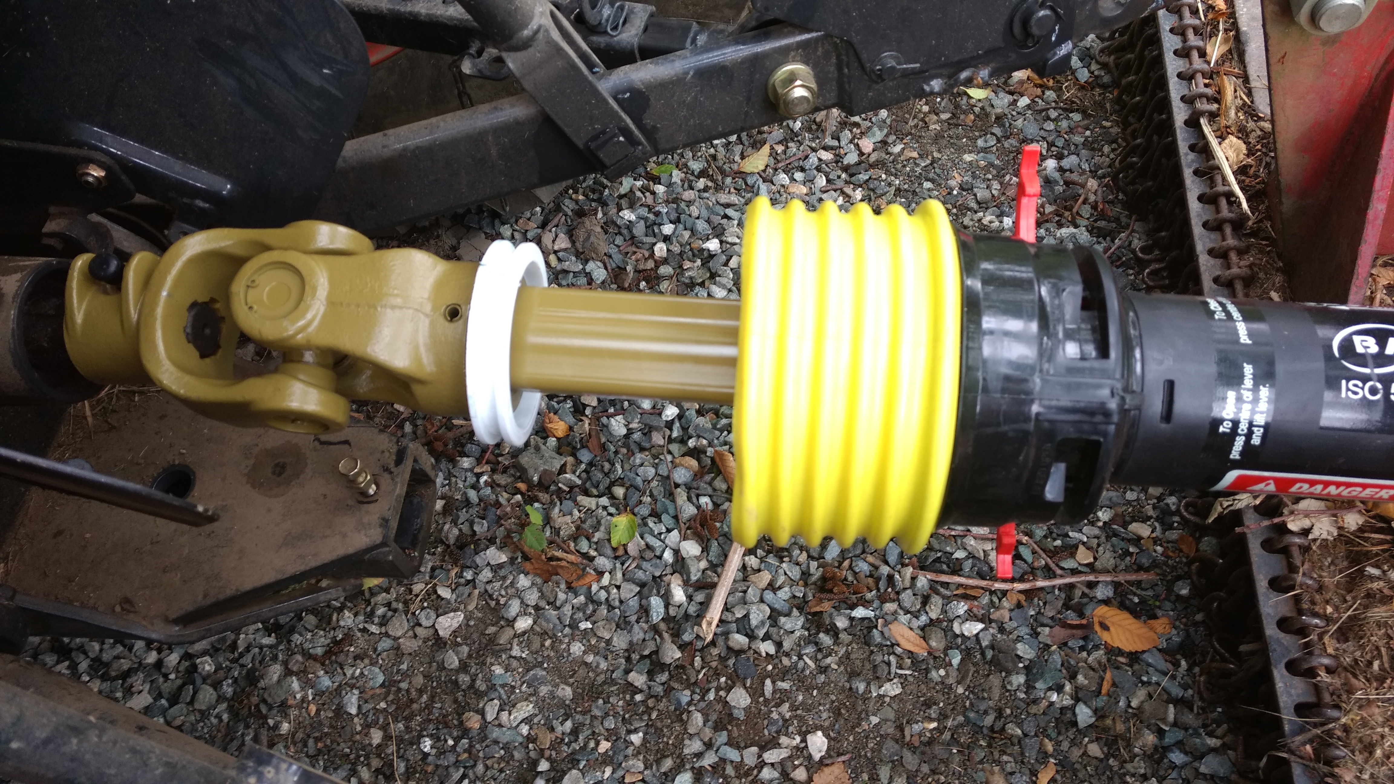

Ordered the SB6501 Bare Co PTO shaft from Mount Vernon Washington Tractor.
I got a response back from Bare about what their overlap is at their stated 65" extension and they said it was 15" (apparently their shaft sections are longer than the 39" collapsed- I'd calc'd based on 39" and got 13" as the overlap). Since I'll be operating at 60" (max) that would mean I'll be running with a 20" overlap. So, WAY better overlap, series 6 (beefier) and NEW should keep me from reporting on any more PTO shaft issues!
   / Overstressing PTO U-joints?
#56
Picked up the Bare Co PTO shaft today. A BIG thank you to Rock knocker for mentioning these! Being that it's a series 6 it's a bit heavy. But, the collar releases makes it a LOT easier to connect up:
   / Overstressing PTO U-joints? #57
Those are sweet, aren't they? Since they're 60hp rated and I'm using them on a 27 PTO hp machine I've loosened the bolts quite a bit and scribe them with a sharpie before each use, and then examine for slip. I think I want to see a tiny bit after each use, because better safe than sorry.
