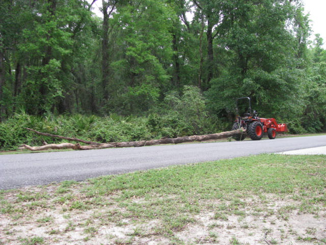

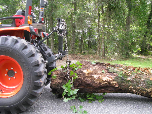

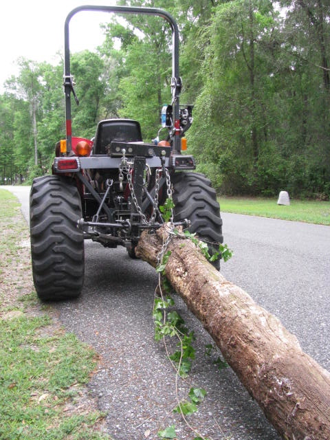

You should not plan to pull logs out of the woods with the FEL. Skidding logs should be done from the Three Point Hitch, with the proper skidding gear installed on it. I am attaching a few pictures of my prior Kubota B3300SU skidding logs.
