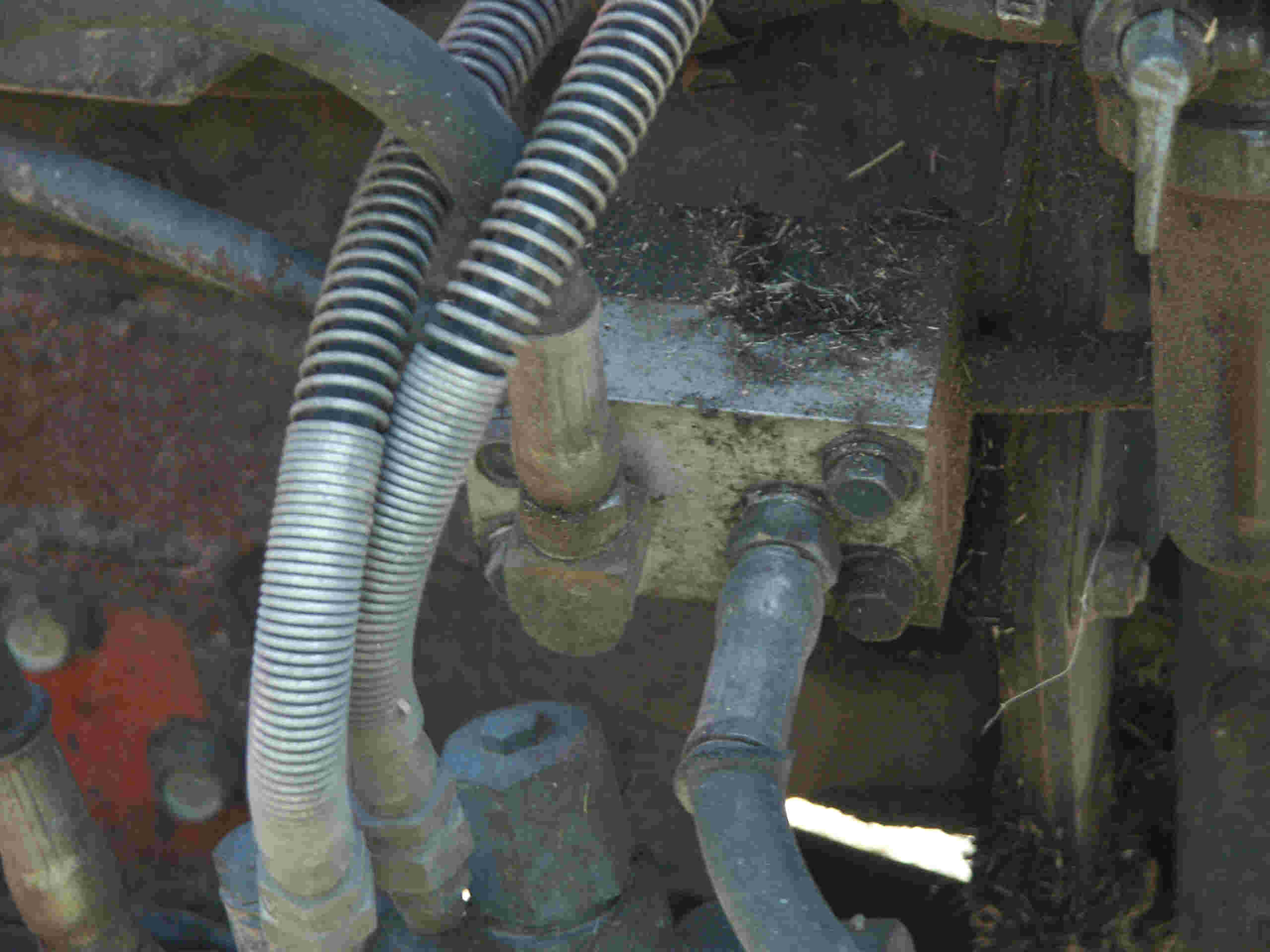

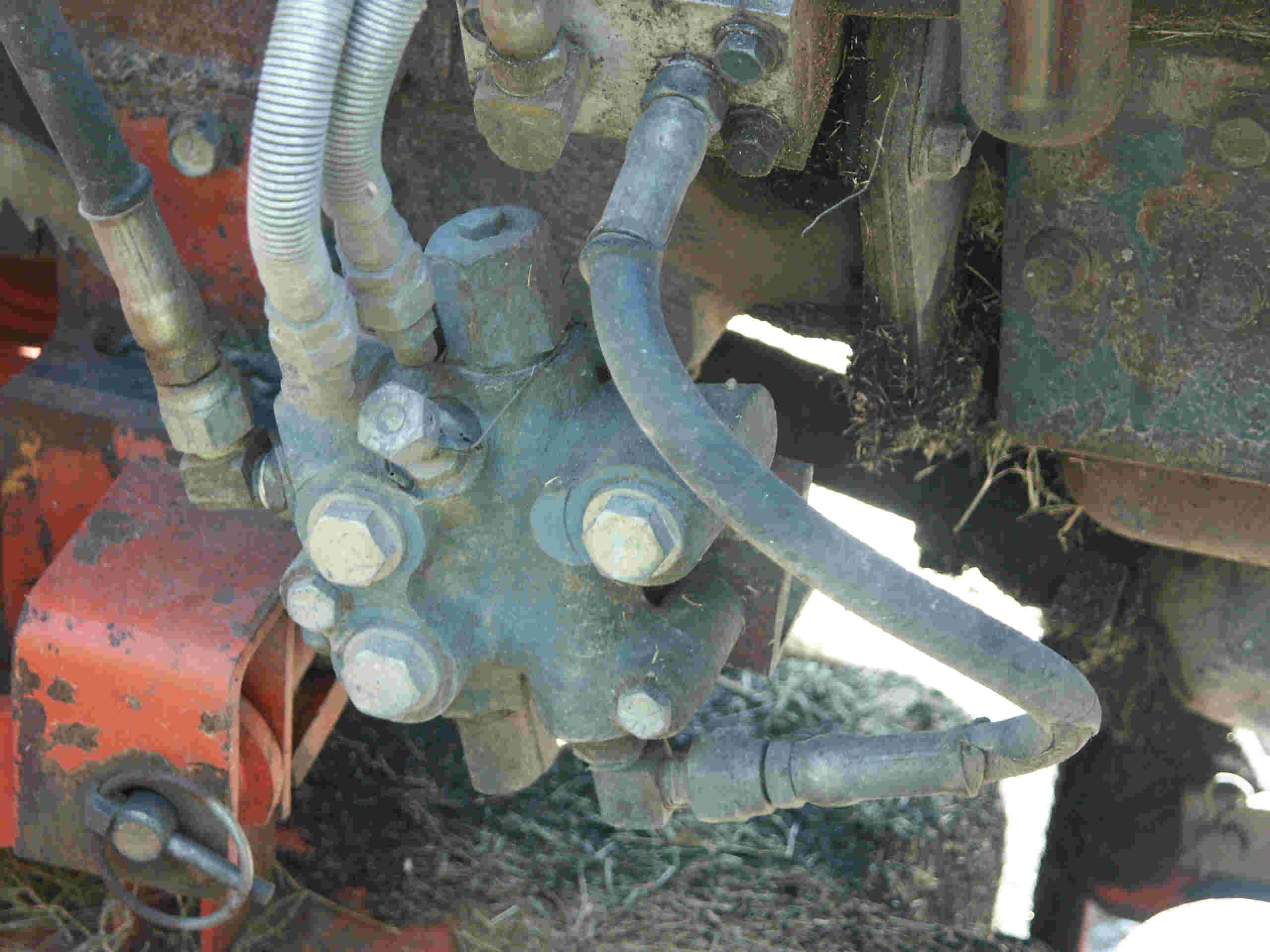

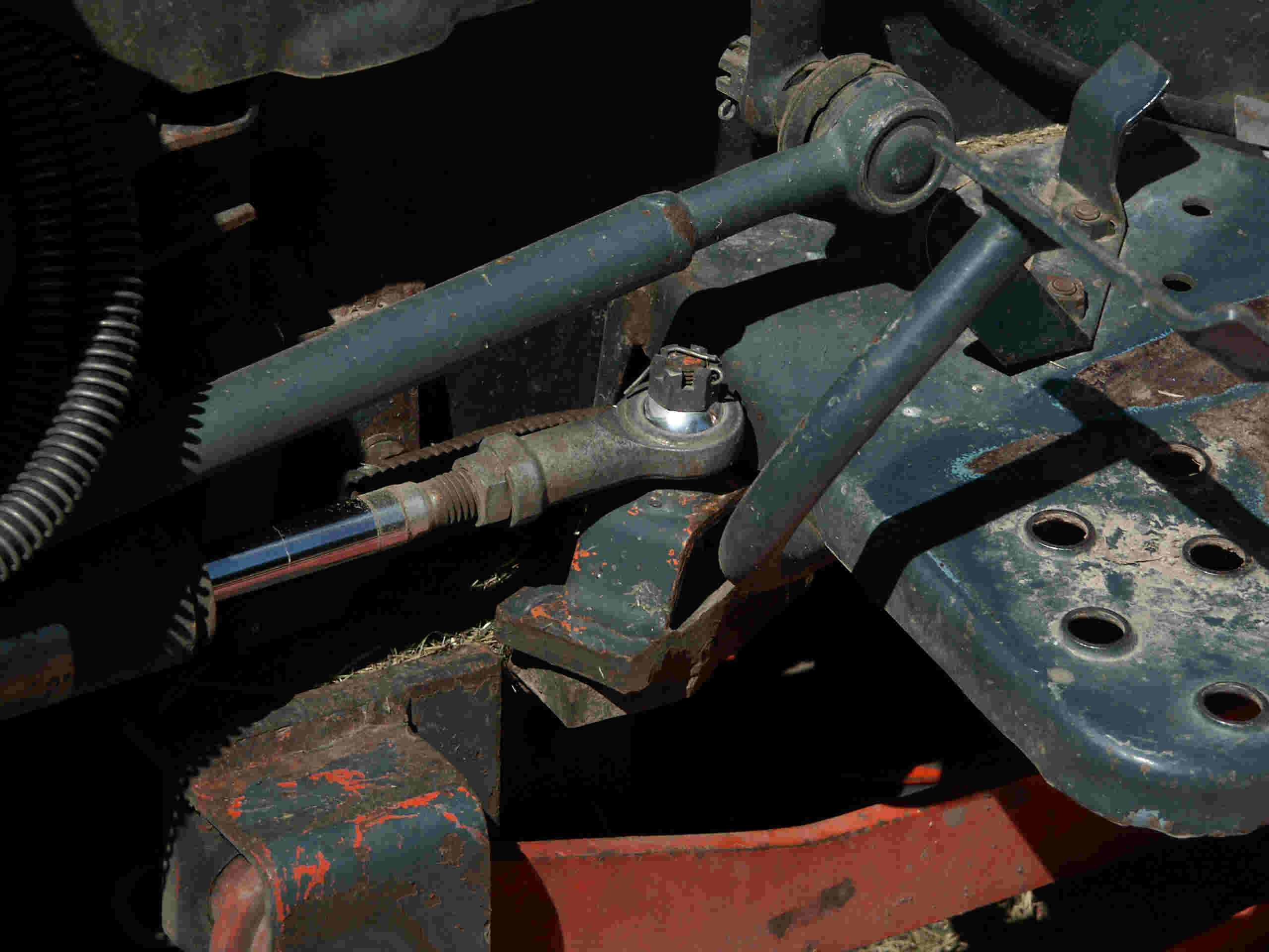

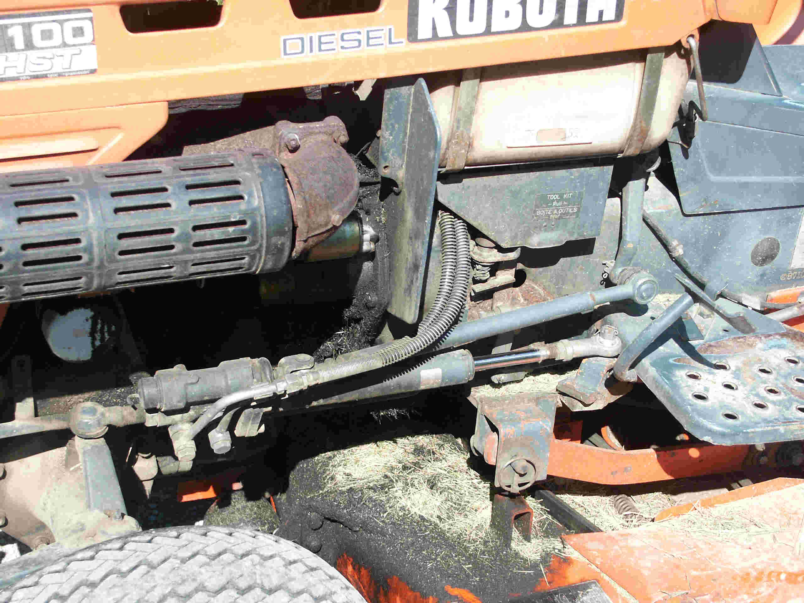

Here are some pictures. This is my first try at this, so I hope it works. You can see I had to fabricate some attachment brackets, but hhis wan not difficult.

Does the unit on the left side sense your input and then add assist? All the stuff on the right side is just additional hydraulic block?
Thanks!
/ P/S B7100/7200
You are correct. The unit on the left is activated from the pitman arm through the drag link. As you turn the wheel it pushes or pulls the drag link which then turns the wheels right or left. This is all fed from the hydraulics on the right side of the tractor. It has worked very well for me for many years.

Elsie, could you please explain what's going on inside the hydraulic mechanism on the right side of the tractor?
I see you've got two of the lines going to the factory hydraulic splice location, and the other two (those with springy strain relief) appear to go to the actuator over on the left side.
Is this device just a tap? some kind of flow divider?
I can't understand why the 3pt will not raise at idle unless hydraulic fluid coming out of the pump side of the splice returns to the trans some way other than through the 3pt side of the splice.
Thanks for posting this very interesting information.
/chris

Chris -
This hydraulic mechanism/device is actually the hydraulic block off a B8200. It already had an outlet for power steering, and you are right, the two springy looking lines run to the actuator on the power steering cylinder. The other two lines just complete the circuit to the factory hydraulics for the 3 pt. (and/or the extra outlet under the seat for a remote cylinder). I assume that since the volume created by the hydraulic pump is so low, the flow divider built into the hydraulic block sends all the fluid to the power steering at idle. I looked for just a flow divider, but I could not find one at the time that was either adjustable or that would not send all the fluid to the power steering. This has not been a big problem. I don稚 have to run at full throttle for the 3 pt. to work, just a little above idle speed. The 3 pt. lifting capacity does not seem to be less than before. It will easily lift anything I need, including my snow blower, rear mower or anything else I have tried.
I also had to replace the top/front half of the original hydraulic block on the tractor to provide a place to tap into the tractor hydraulics. It was a stock item normally used for a front blade, snow blower, loader or other attachments that needed hydraulics.

It may be a little hard to explain, but I intercepted the hydraulic flow with the block on the side of the tractor. The additional block from a B8200/9200 has a built-in flow divider and diverts approximately 1 gal./min. to the power steering cylinder. The rest of the flow runs through the second block on to the original tractor hydraulics to run the 3 pt. hitch. The flow from the pump is only about 3.7 gal./min., if I recall correctly, so the power steering circuit uses up a substantial portion of that, and that is the reason that I have to have a little throttle for the 3 pt. hitch to work. The oil returns exactly as it did before. The 1 gal. flow circulates through the power steering cylinder control to push or pull the cylinder, depending on the input from the steering wheel. The first small block was designed to provide hydraulic flow for a front snow blower, loader, or other attachments on the 7100. The second block was all I could find at the time to divide the flow for the power steering. It also has outlets for other attachments, but I don稚 use them. As I stated, the oil returns to the pump just like it did before, so I don稚 think that is any different. The benefits from the power steering far outweigh the slight inconvenience of the three point not working at idle. I suppose I could try to see if a pump from a larger or newer tractor would fit on my 7100, but I don稚 think it would be worth the cost or effort.
Let me know if you need any more information.
