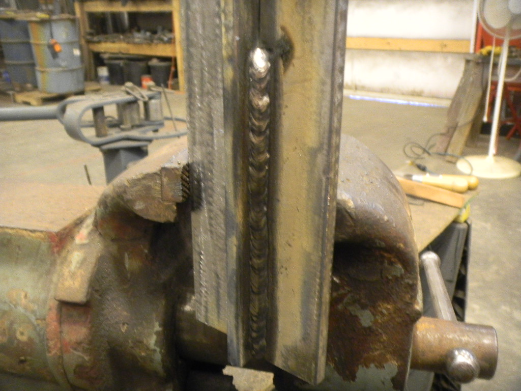

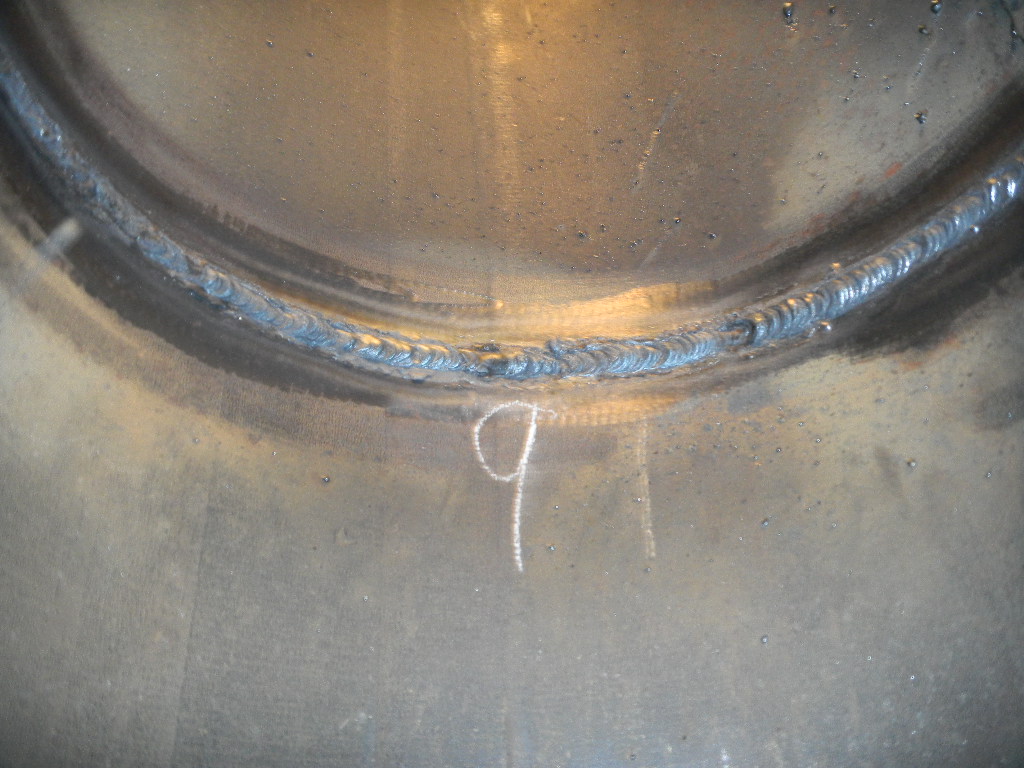

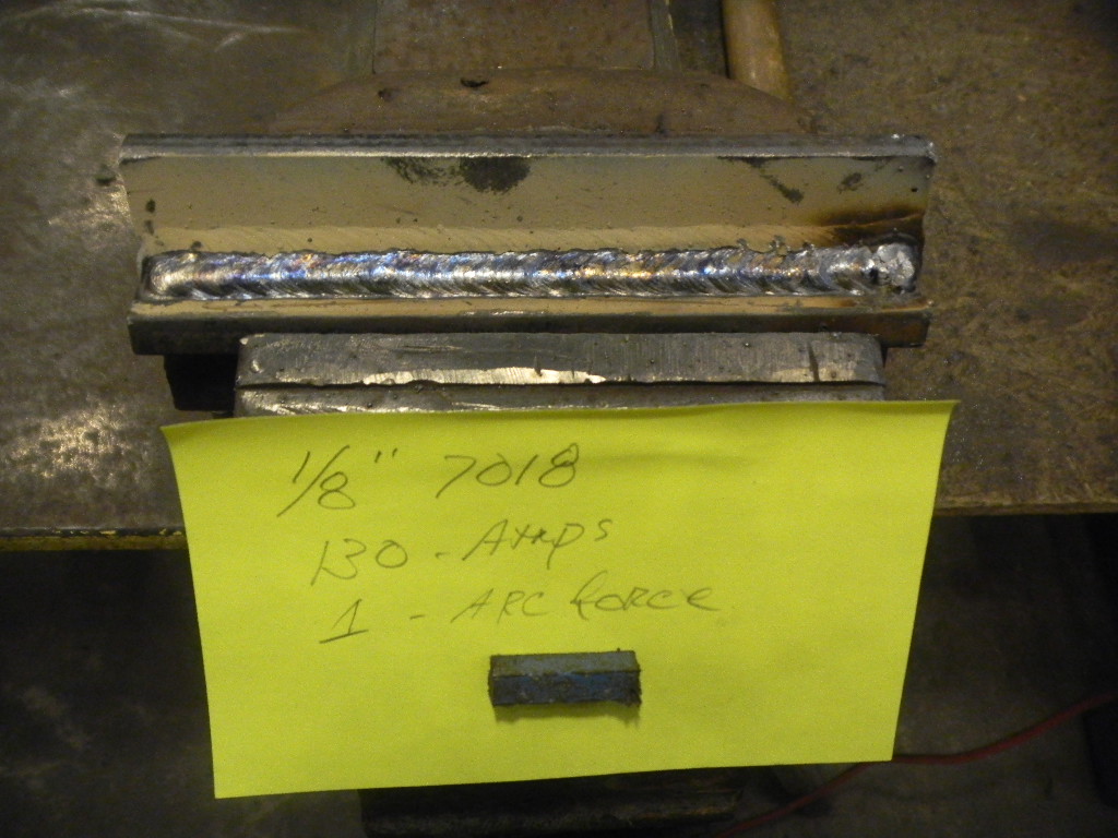

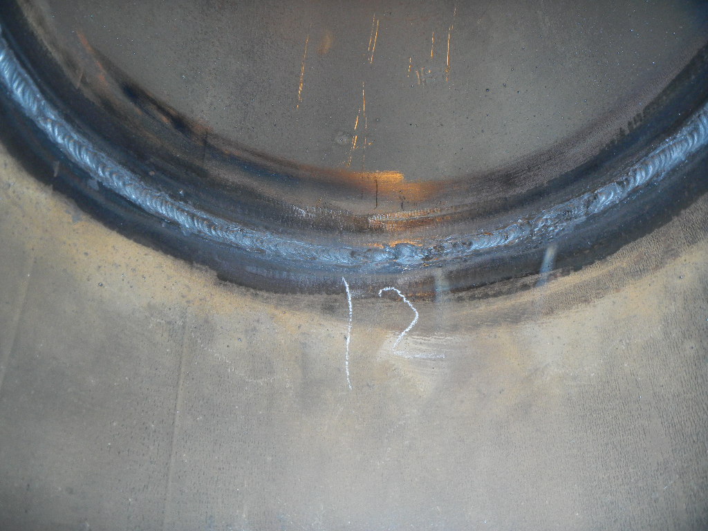

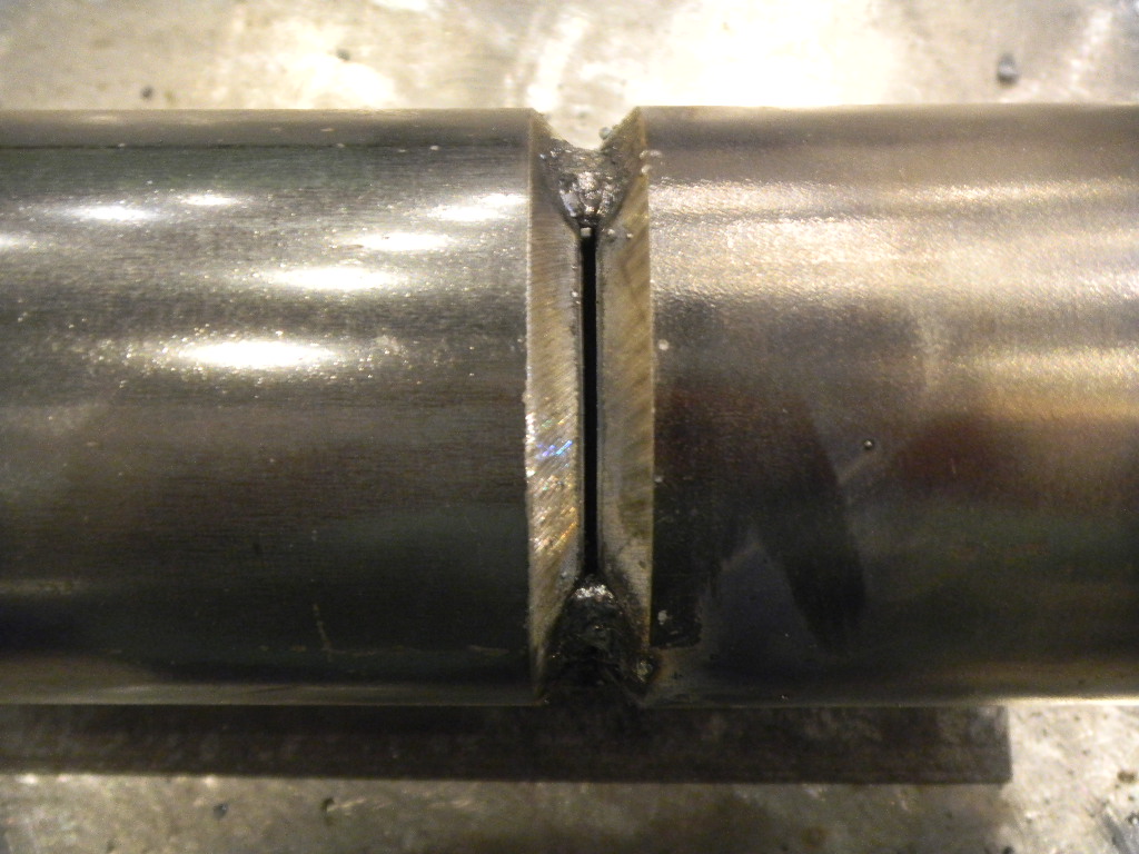

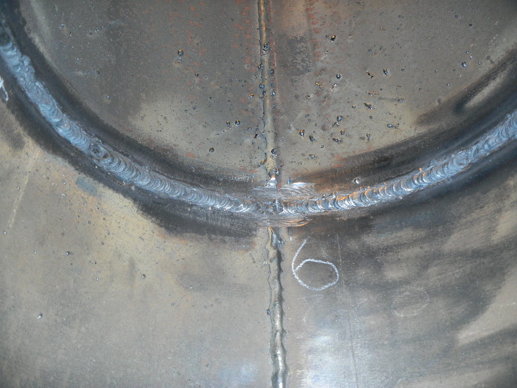

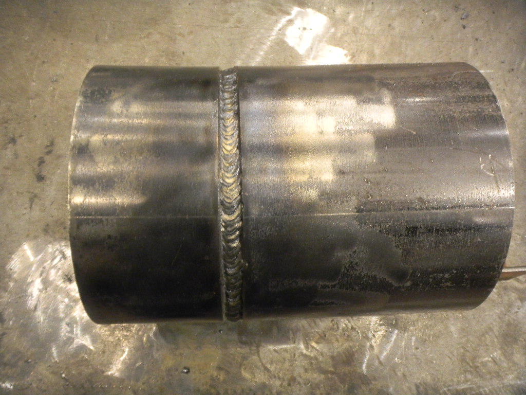

Played around with the new machine this morning. Trying to learn where I like to run it.
Did an open root pipe. I forgot to turn the arc force all the way to 10:mad:. I left it at 5.:rolleyes:
30-degree bevel.
7/64-inch gap.
No land, knife edge.
1/8-inch 6010.
50-amps.
5-arc force.
Fill pass.
5/32-inch 6010.
120-amps.
1-arc force.
1/8-inch 7018 flat.
130-amps.
1-arc force.
1/8-inch 7018 vertical up
125-amps.
1-arc force.

   / PA-300, my opinion. #23
Looks good except just to the right of "12" there is a closed up gap. Was that too low of arc force or too low of amps? Was it that the gap closed up or something else like the arc went out???
   / PA-300, my opinion. #24
Looks nice! Thanks for posting your settings, that will help me a lot! :thumbsup:
#25
After tacking up, 3, 6, 9, 12. The whole top half of the pipe was a tight gap. I always weld the tightest gap first. In this case I think I welded from 3 to 12. Then 9 to 12. The last inch or two of the section 9 to 12, the gap was really closing up on me:mad:. I'll bet, if I had the arc force all the way up, I could have just punched through! As you know Mark, I'm no pipe welder, by any stretch of the imagination!:eek:
You're welcome!;)

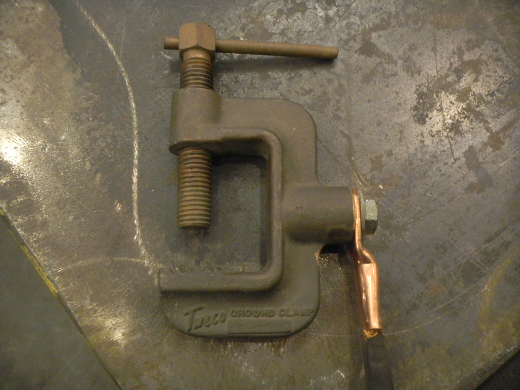

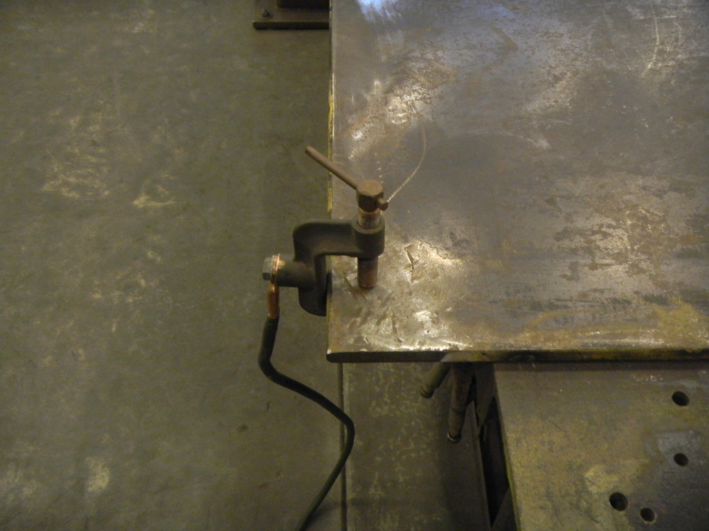

I got one of the the 300's also and really like it. Just seems well made! I have an old lincoln A/C buzz box and don't know much about what I am doing but my welds always hold so I guess they are not too too bad.... With the 300 I expect they will get much better over time.
I notice the 300 seems much Hotter - I was undercutting until I figured out to cut it back a bit. Can anyone recommend a good book on stick welding that may help me understand more and learn more? Also it seems I have more trouble finding a GOOD ground, is that a difference been using AC and a DC machine? Just noticed that with my old AC machine I could hook the ground clamp 5' from where I was working and the rod would strike, but with the DC I seems to have to have it within several inches and make sure I have a very well cleaned area. Am I doing something wrong perhaps? The 300 seems like a VERY nice solid machine and once I learn more about it and how to use it I think I really become a much better welder!
On another note.... what is open root pipe - keep seeing it mentioned and was wondering what it means?
#27
Code54 here is a really good book. Lincoln sells them the cheapest.
You tube has some really good videos about welding.
Your ground issue seems strange to me, you may need to replace the ground clamp, or at least check the connection.
Open root pipe is when two piece of pipe are beveled, and a small gap between them. You weld from the outside, but end up with a bead on the inside of the pipe. With your new PA-300 you'll be there by next weekend.;)
