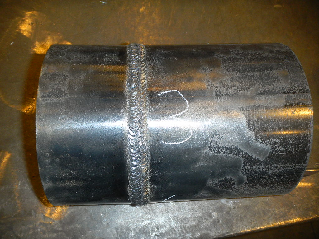

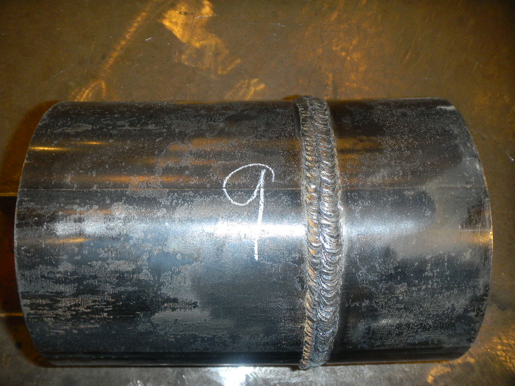

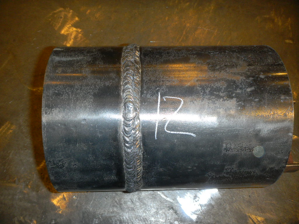

I did a little more playing around with the new machine this morning.
5/32-inch Lincoln 5P-Plus 6010. 115-amps, 5-arc force.
This PA-300 runs 6010 so much better than my PA-200. I have a lot more control of the puddle just with arc length! :cool2:

   / PA-300, my opinion. #46
The newer 200ST units are supposed to handle a "little" longer arc length on 6010. (Theoretically speaking that is...though that may be a subjective claim that has been made, {not by me}).
