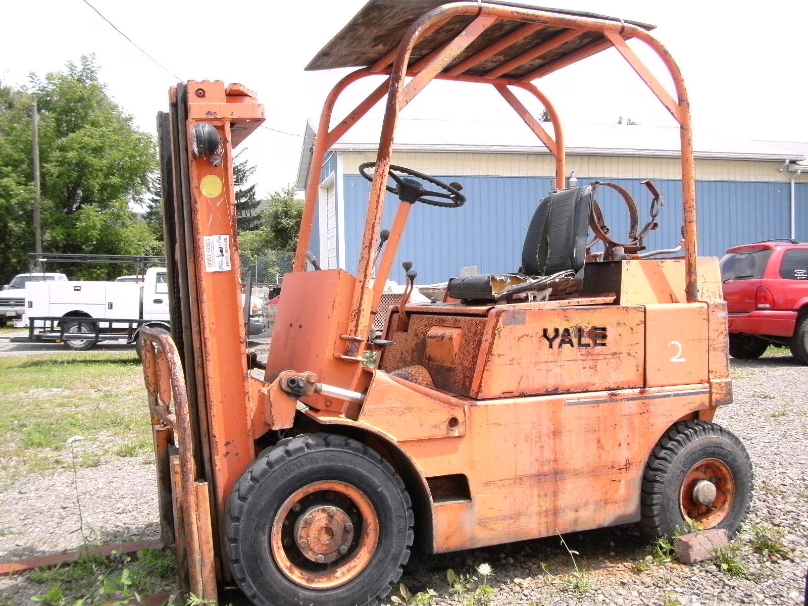

Thanks for the replys...I'll be spraying (Rust-oleum) with a HF HLVP gun, I might just get 2 quarts instead of a gallon which is probably an excessive amount for a 5k sized forklift. I wanted AC orange, nothing regionally in quarts or gallons, so Kubota orange it will be. Back around 1991 I sprayed TC 'tractor paint' with hardener on my IH330, must be that was the Valspar stuff? Still holding up very well all these years later.

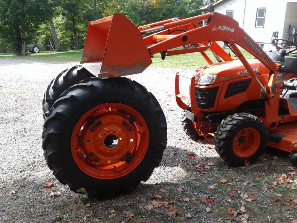

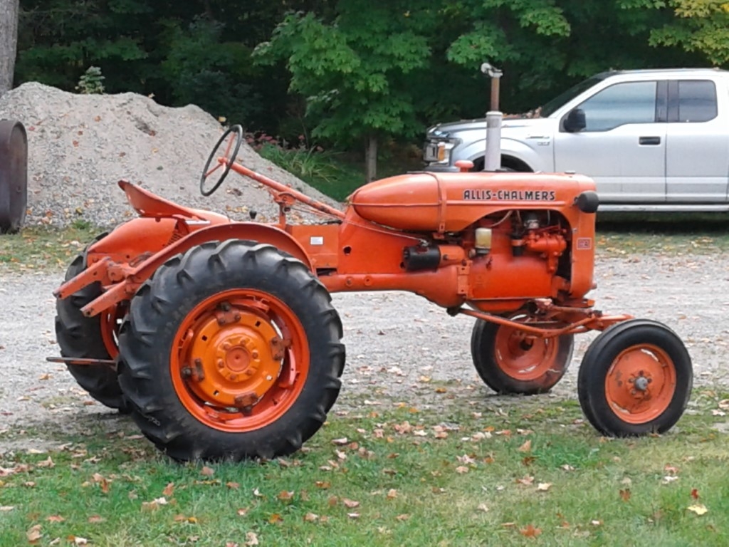

If you can find New Kubota orange it matches my CA pretty good. But if you look at the center dishes in my rear rims, that is OLD Kubota orange and it looks terrible, LOL
The rims are actual AC Persian Orange.
