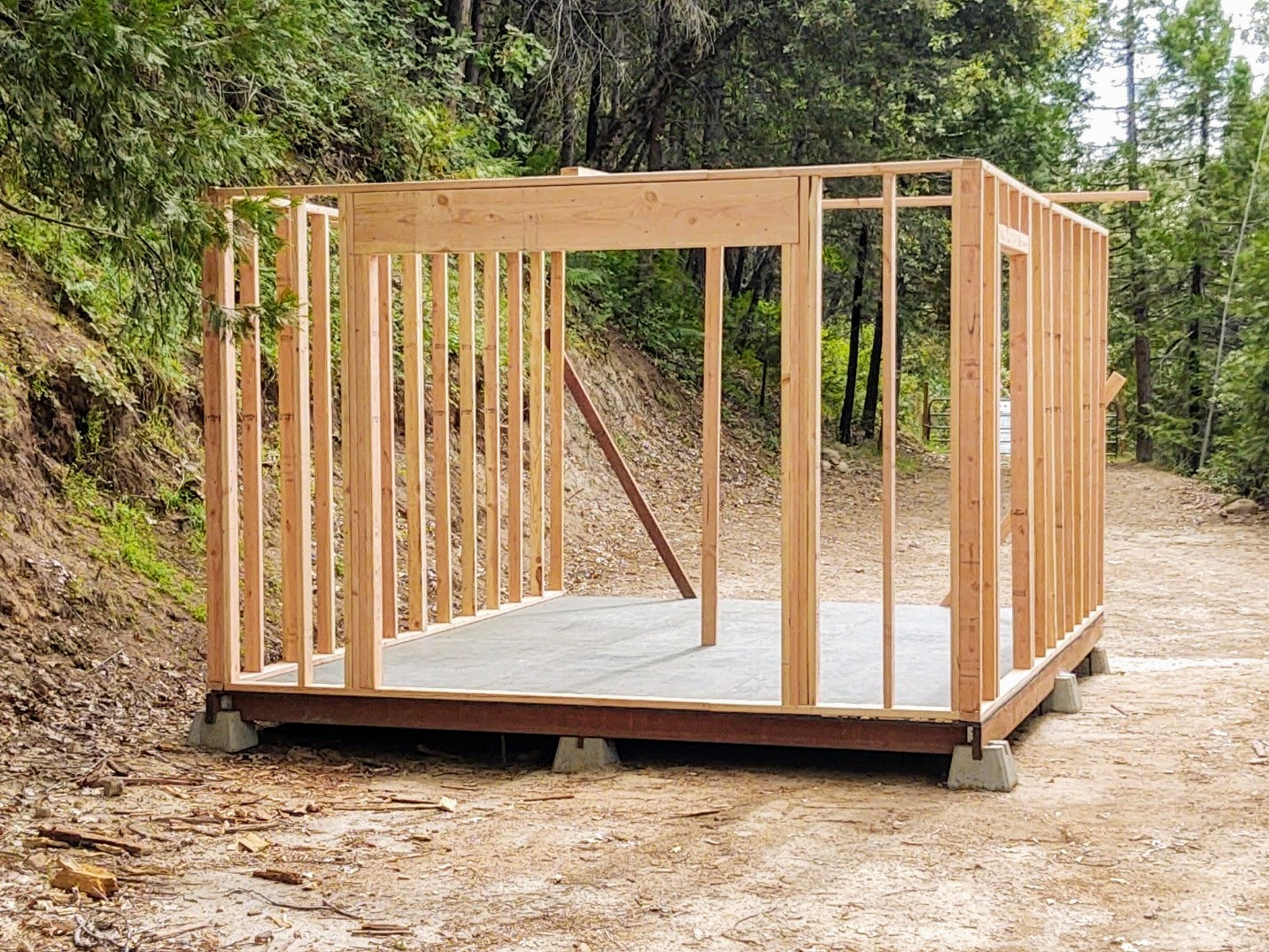

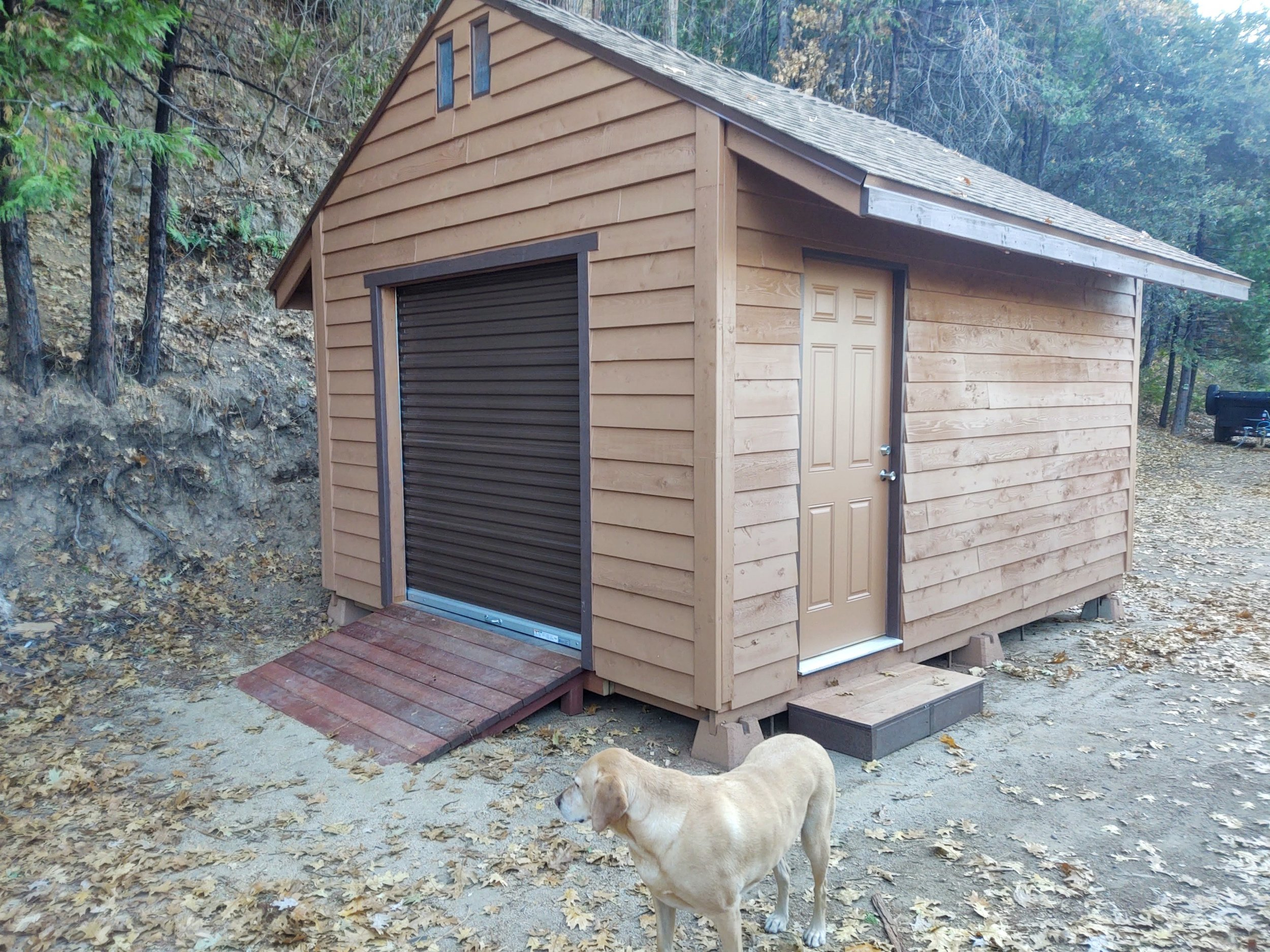

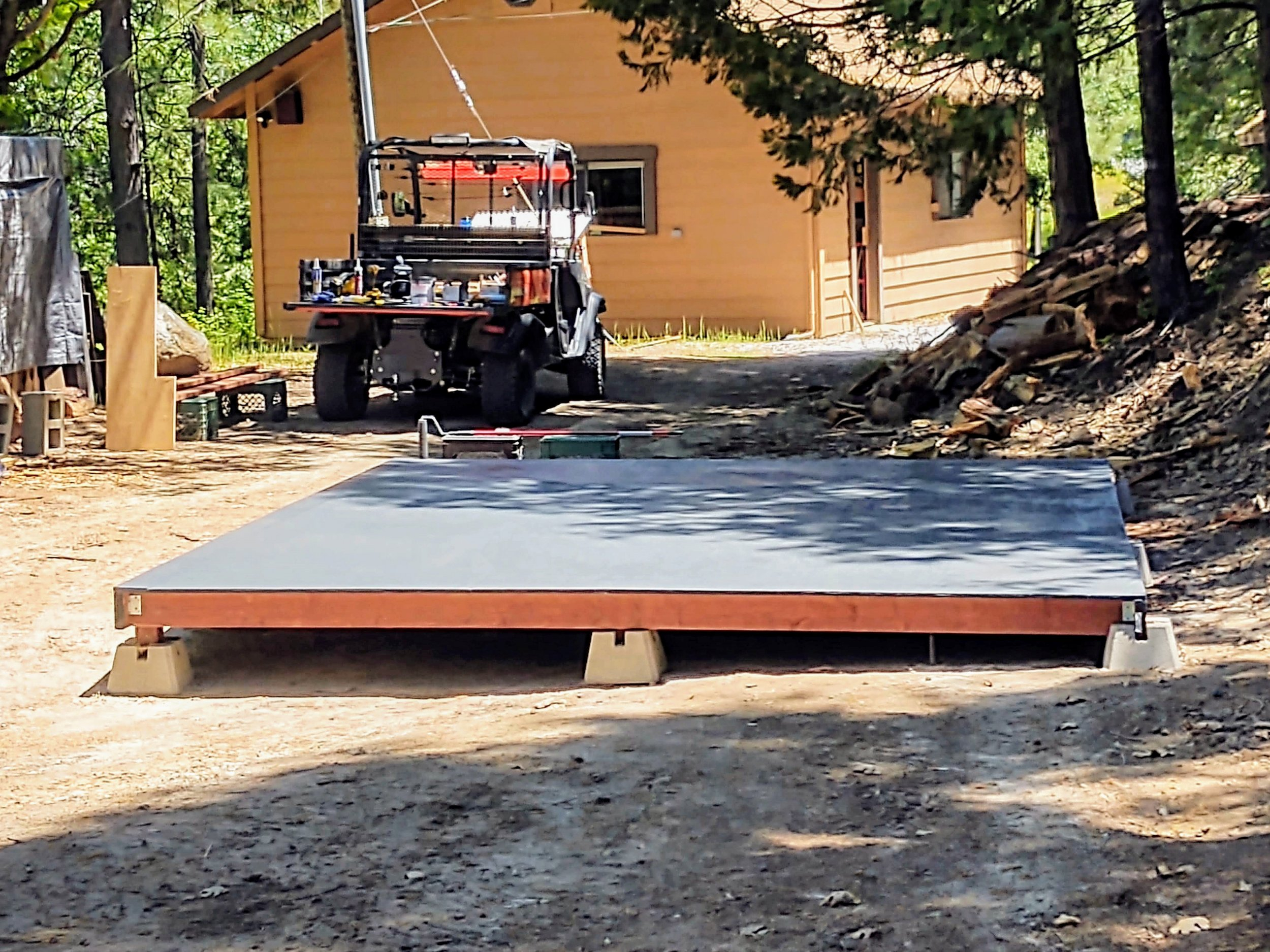

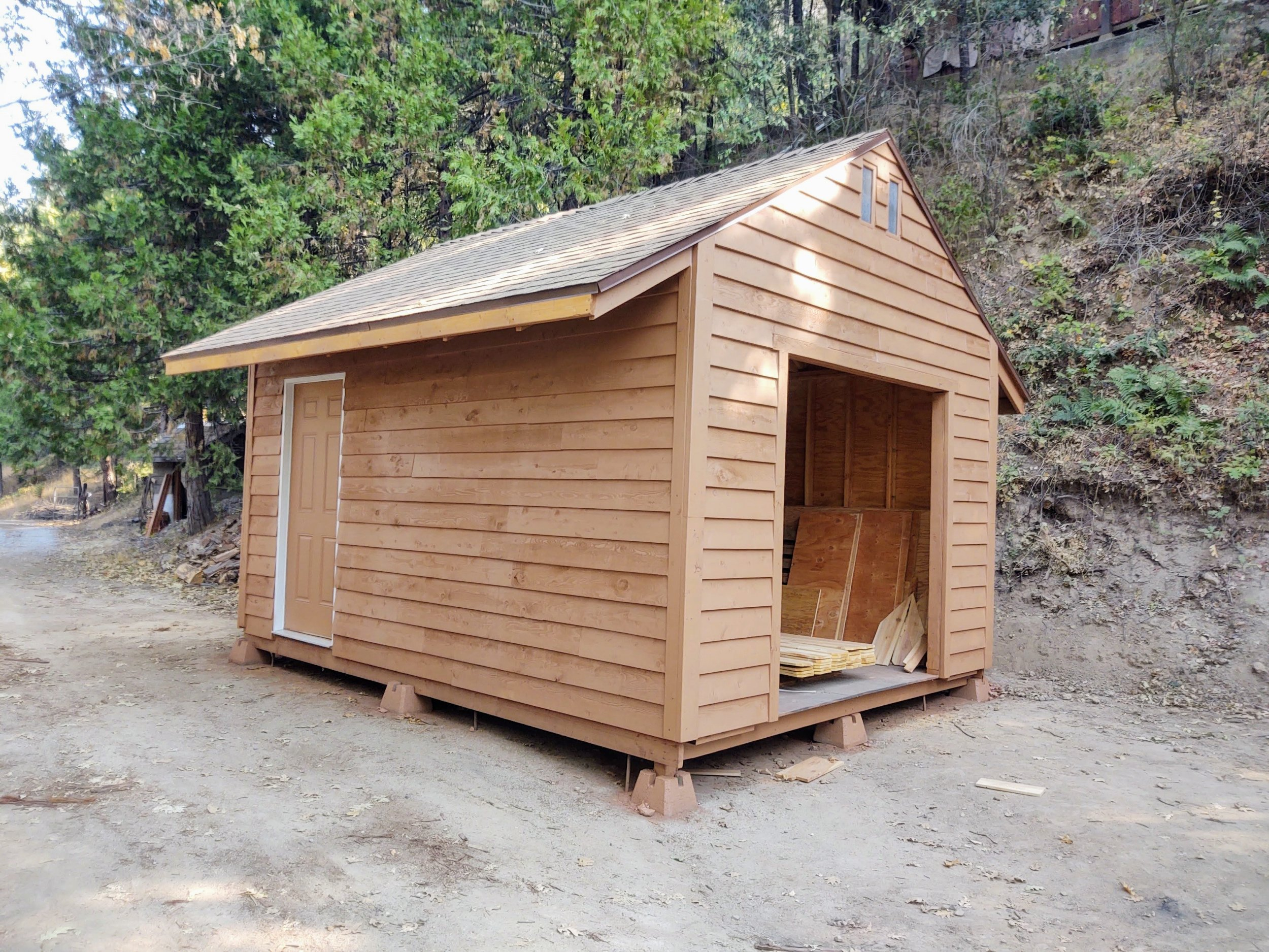

Looks good, nice job. When I built mine it was my first one too, I watched lots of you tube videos. Lifting the walls and putting up the ridge beam was tough, also putting on the shingles wasn't fun. But so glad I did it myself, and didn't pay anyone IMG_20201211_155739989~2.jpgIMG_20201210_154417207~2.jpgIMG_20201016_143819817~2.jpgIMG_20200515_123305642~2.jpgIMG_20200615_055803190~2.jpg3197~2.jpeg

Semi-solid oil based stain hands down. Latex Solid stains and paint can peel. The solid stains in particular are prone to chalking and can fade fast. A good semisolid oil will soak in and give some nice color. You'll never have to scrape it and it's likely a 1 coat application. Use a brush to work it in instead of spray. You'll get about 250-275sq ft per gallon on bare wood. A quick power wash and recoat every 8-10 yrs is all it'll need
