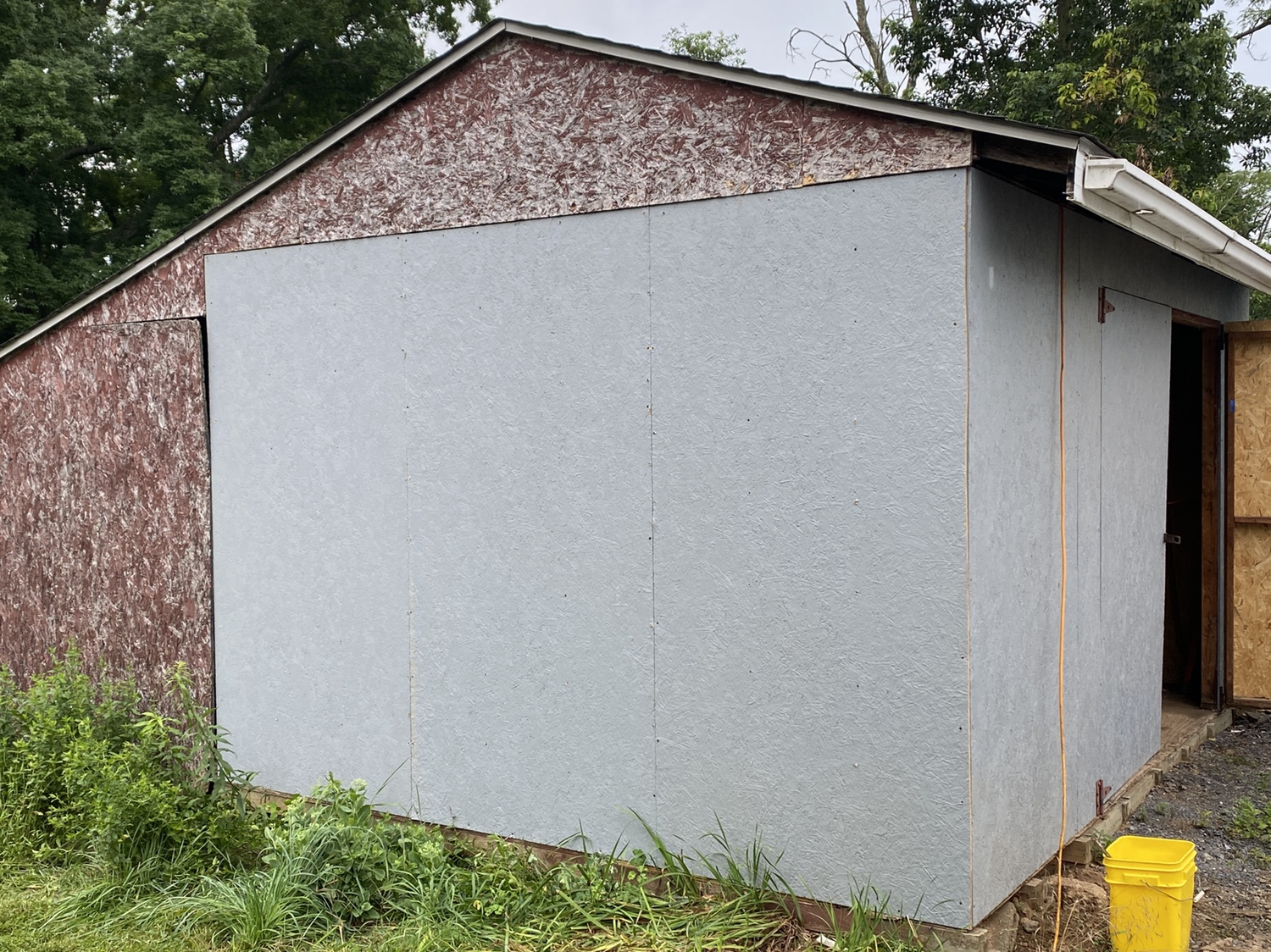

I built my shed 25 years ago with osb. Replacing it now with osb, because I already had it.
I remember your thread about replacing the siding, but don't remember if you mentioned painting the bottom edge and a bit of the back before installing. Jon
   / Paint or Stain on Shed #32
Thanks for all the responses. I have already bought the T1-11 so I am going to put it on. My Dad's shed is 30 years old and just got stained a year ago when Mom had her house painted. The T1-11 is still in pretty good shape. Everyone has given me a lot to think about and I am definitely second guessing the T1-11 but I am not a shed expert and made a decision to go that route. Based on everything I have heard I am thinking about a high quality paint.
I wish I had known more about the smart siding. It just looked thin to me and I did not realize it was as strong as Eddie said.
T-11 siding is IMHO - horrible product depending on your climate. I do not even like the primer most manufacturers use, cheap cheap. Since you already have the siding, my personal recommendation would be to prime and paint with the best products you can afford, taking extra care on the bottom edges and seams. Also, look into a drip edge / flashing for the bottom and possibly between sheets. I have not used the product in many many years after having to cut 3' off the bottom because it rotted. It lasted about 5-7 years and the worst part was from the outside it looked ok until one day I noticed a small spot that looked bad. Probing around I discovered it was all rot. Also noticed in places with a lot of Sun (Texas) small vertical splits were developing.
I would use and breathable underlayment and screws to attach. Removal if needed is somewhat easier down the road ? Novice 2 cents opinions here.
   / Paint or Stain on Shed #33
Edges got painted this time. Last time they weren’t. Did not paint back side. I am putting z channel between top and bottom pieces this time also.
