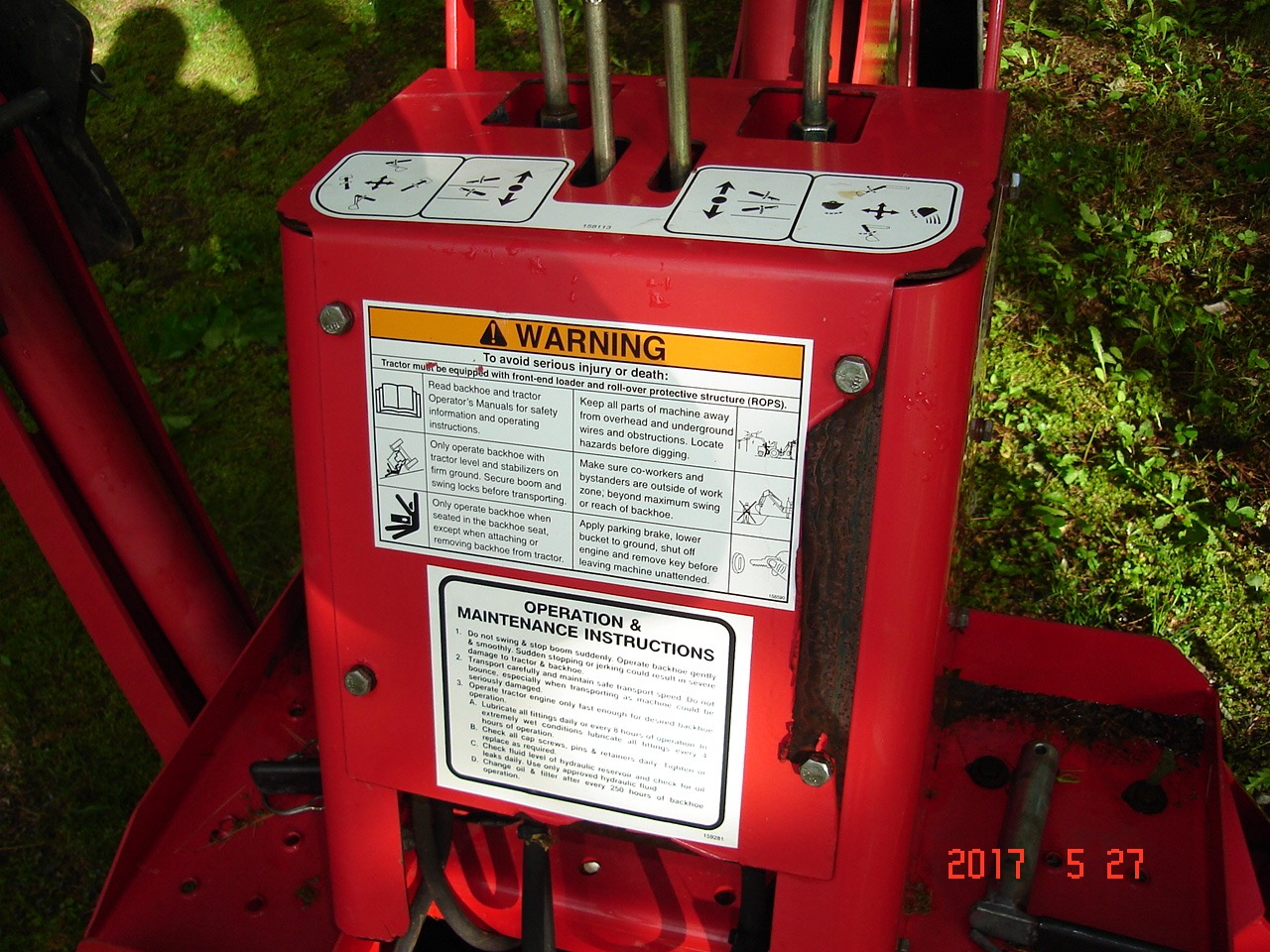

The paint on my backhoe, on the relatively sharp edges of the steel parts, was not great. I made the mistake of driving it on the road -- which had been salted-- to plow/blow a friend's driveway and the edges of the steel started rusting, then began to lift the paint, working its way inward further & further. I eventually removed the "control panel" and had it sand-blasted and powder-coated. Rust also appeared on the edges of the steel rear fenders.
Moral: DON"T drive it on salted roads.

I can live with the color fading, but I can't live with the paint not protecting the metal from corrosion. The undercoats, (the metal prep, and primers), is where they all skimp the most. Irving's photo is a classic example of this.

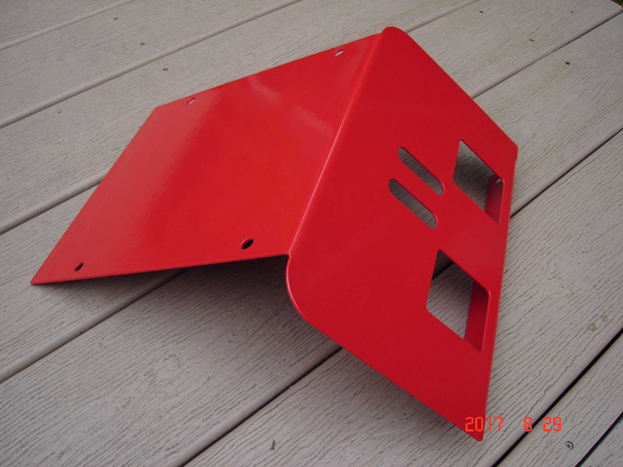

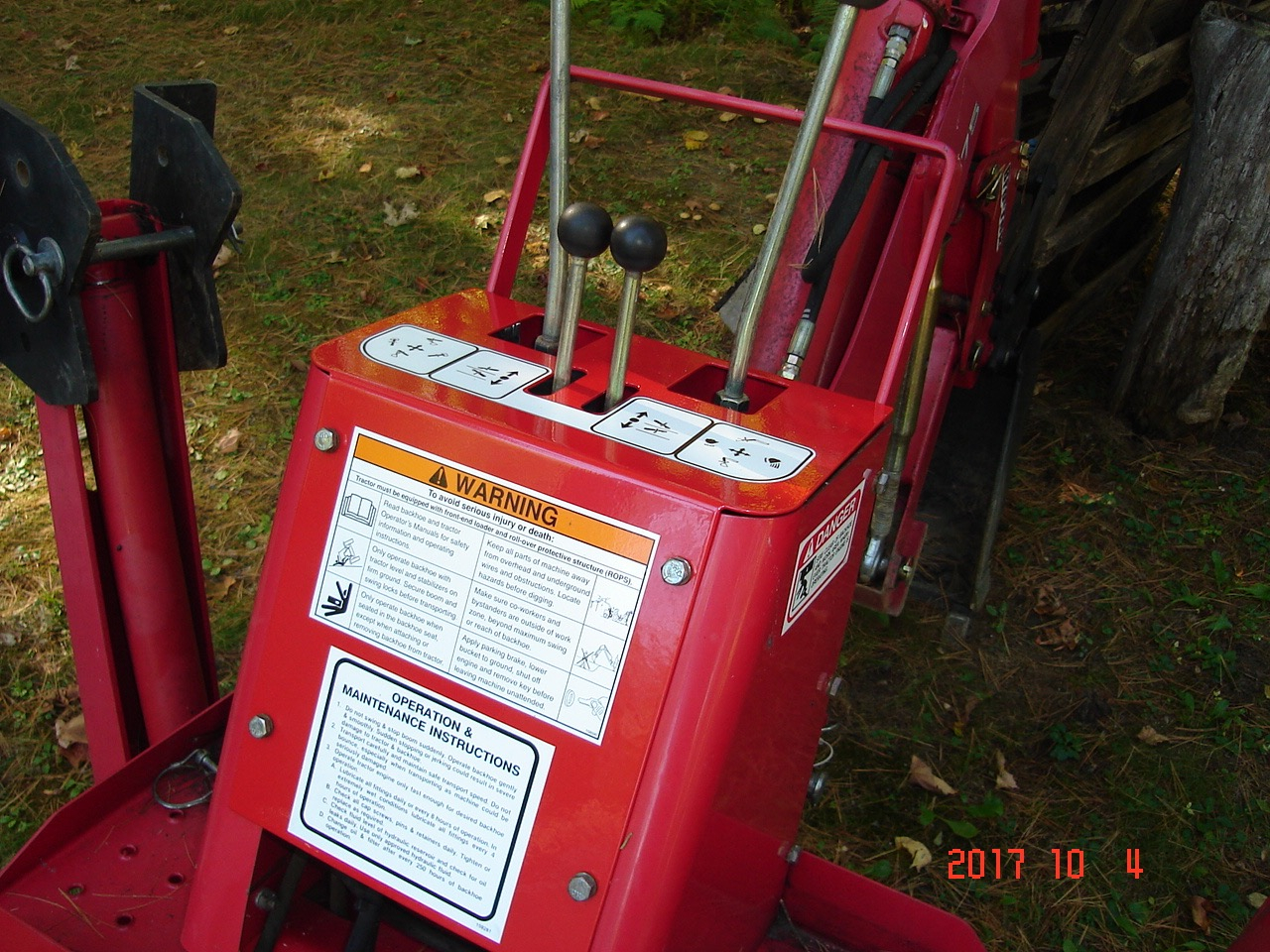

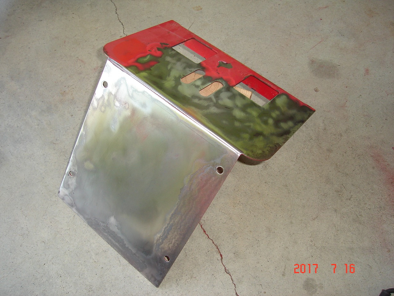

I suspect you're right, Ray. When I started to sand mine off (prior to deciding it was worth it to have it blasted instead), there wasn't much evidence of primer. I'll put a photo below that shows how extensive the rust "creep" had become -- look at the metal discoloration; I was getting more & more large flakes peeling off as time went on, very annoying to an OCD person like me! :)
The other thing I felt was that the relatively sharp edges of the original piece of steel made it so paint on the 90 degree edges was extremely thin-- that's where the problems started. The nice thing about the media blasting was that all the edges became rounded a bit, an improvement, I think.
I thought I'd be able to re-use the old stickers, but it wasn't worth it -- for less than $30 I got a new set from AGCO. The red powder-coat paint isn't a perfect match, but it's close enough for me. Result was I'm happy, and it shouldn't have any paint peeling & rust issues again... at least that one part!
BTW -- you can see this was done in 2017; I got the tractor in Feb of 2008.

The undercoats, (primer), should bond to the topcoats. So you won't commonly see primer if you scrape the paint off. If you do, they didn't bond, and that's bad.
To find evidence of any undercoat, you need to look at the back side of the paint chips that came off. If they used primer, you'll see it there. If it's the same color as the top coats, they used a "direct to metal" finish, which is fine, if your painting your metal building.
It's about more than just spraying a coat of primer on something before you paint it. It's about how you prep the steel, (cleaning and sanding), how you chemically prepare the metal, to begin with. And, what you use to create a barrier, (primers, sealers), before the paint is applied.

Nice job. The cover is different on yours than mine. Mine is just one big opening up there for the joysticks and stabilizer levers. I like yours better.
