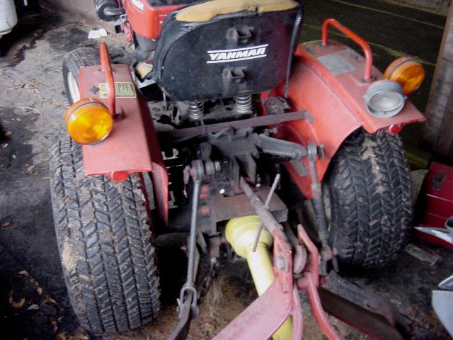

I kind of thought I would get a responce about repainting it. I understand most of the guy's here that own these little yannys like them to be keep origial in most aspects including paint.
I have tryed all kinds of rubbing compounds, buffers, this paint restoryer or that paint restoryer bla, bla, bla, bla washed it till I thought the paint was going to come off.
I have to agree with Calpryo on this one, I just want to keep my little jem looking it's best. Wifey has agreed to letting me get it done by someone who knows how to paint and a new decal package to boot!! so quilty is most likely not a problem if I go that route, but if I can save myself a little money and do it myself with a rattle can or the little Wanger spray painter I just may go that way.
OK, one more thingy to adress here, Normede2001 I will get her a new seat I know I should be ashamed posting a pic with that seat on her. It's on the list for the "over winter dressing up" of the little yanny, so when she gets her new color she'll get a new seat.
psst. Calpyro for rattel can that is sweeet!!!!! /w3tcompact/icons/smile.gif
