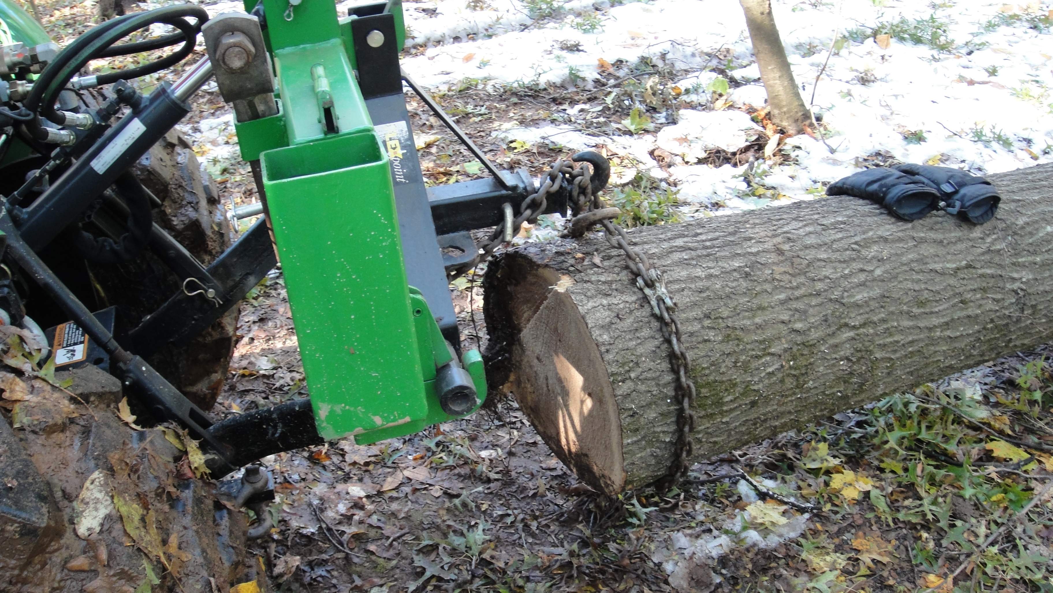

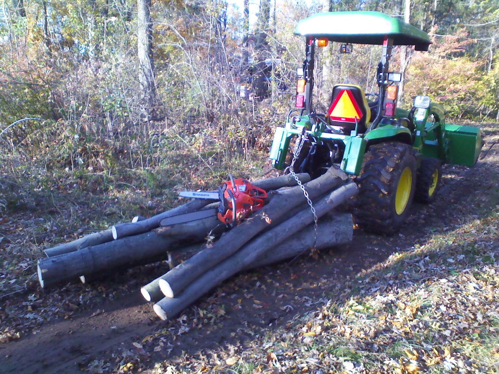

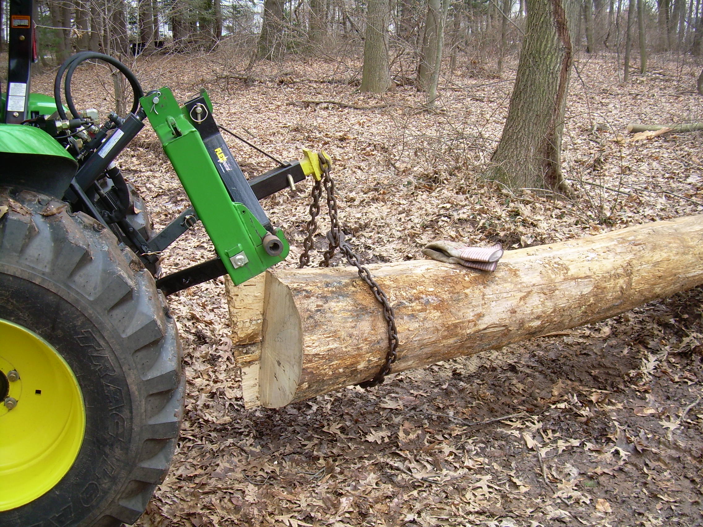

Looks good, but i don't get the need for the sticker.
Are you gonna make a log skidding attachment to fit the QH?
I made a couple of mods to my QH.
JB.

The sticker tops it off... it's a John Deere product and I want to note that. :thumbsup:
Yes the skidding attachment will the the QH.
Nice mods! :thumbsup:
I use a dedicated 3pt receiver for pulling heavier loads, because I don't want to pull to hard on the top link, which is where the modded hitch wants to pull from.
But for trailer jockying or pull smaller loads the QH hitch is great, able to lift higher off the ground.
JB.
