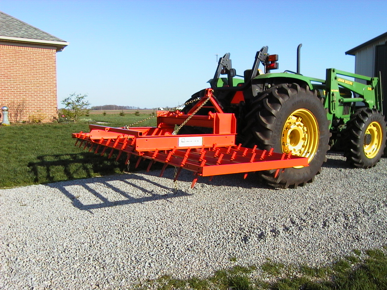

I wish I could convince others as to my post #11 above and how easy it is and how well it has worked for me. Over the years I have done the 100% perfect job and taken a lot of time to do it only to beat it in tillage work or upgrade to something else and have the new owner benefit from my efforts for little added cost.
Paint has never come off a clean, non-flaking rusty surface. The time saved gives me much more space for esoteric sfforts such as time with wife and dogs or perhaps pondering an occasional brew.
Attached is a photo of a spike harrow I made into 3-pt hitch and painted via the above method. It was a piece of rusty equipment I worked on and then painted.
It's not a Cadillac finish but for simple and easy looks surprisingly good. FYI.
