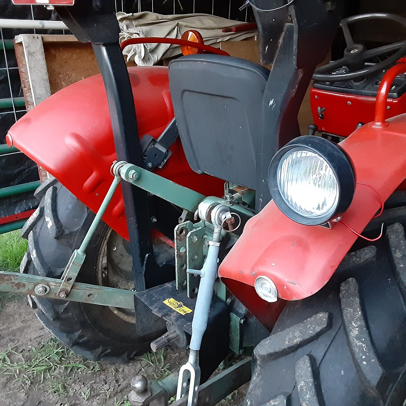

Now look at its real size.

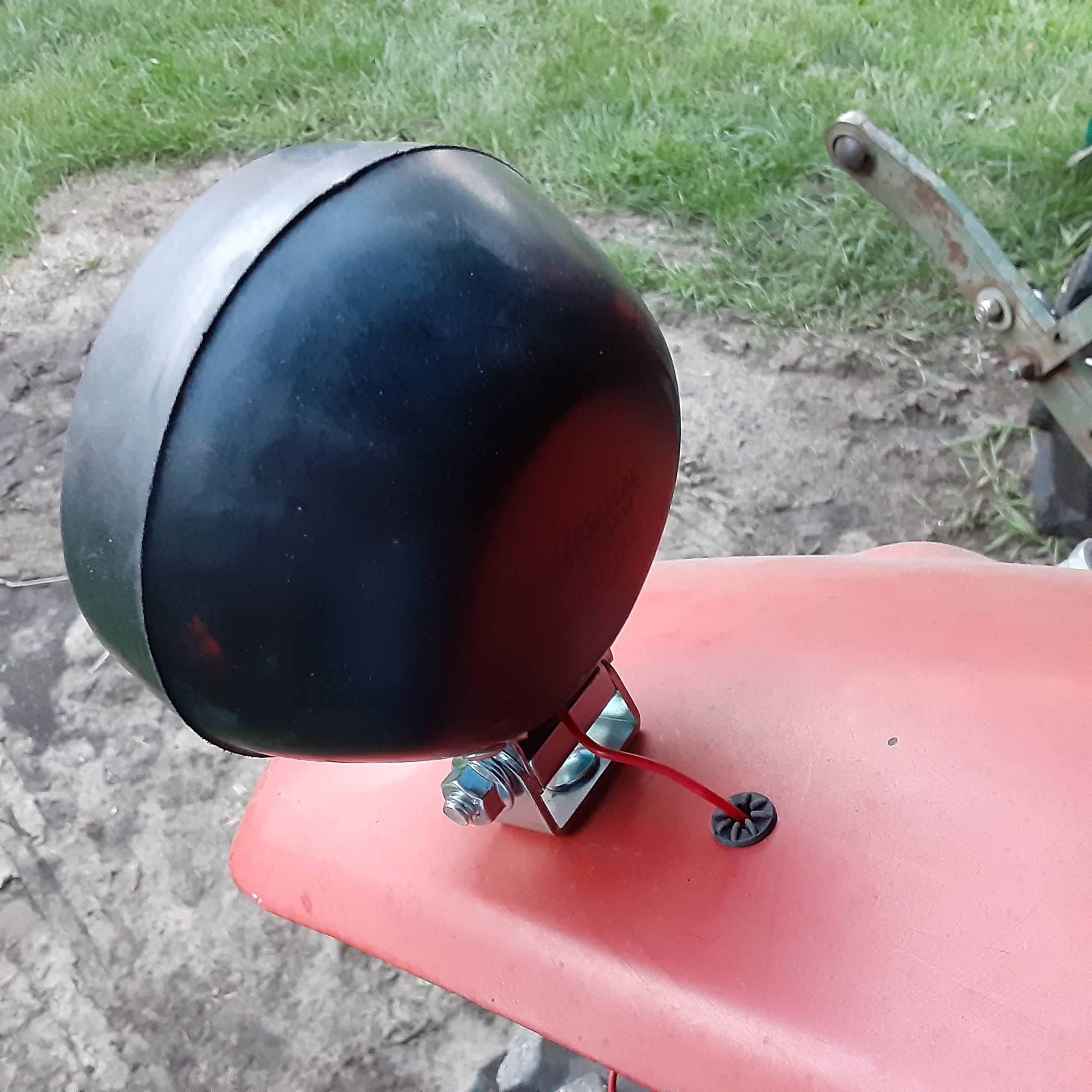

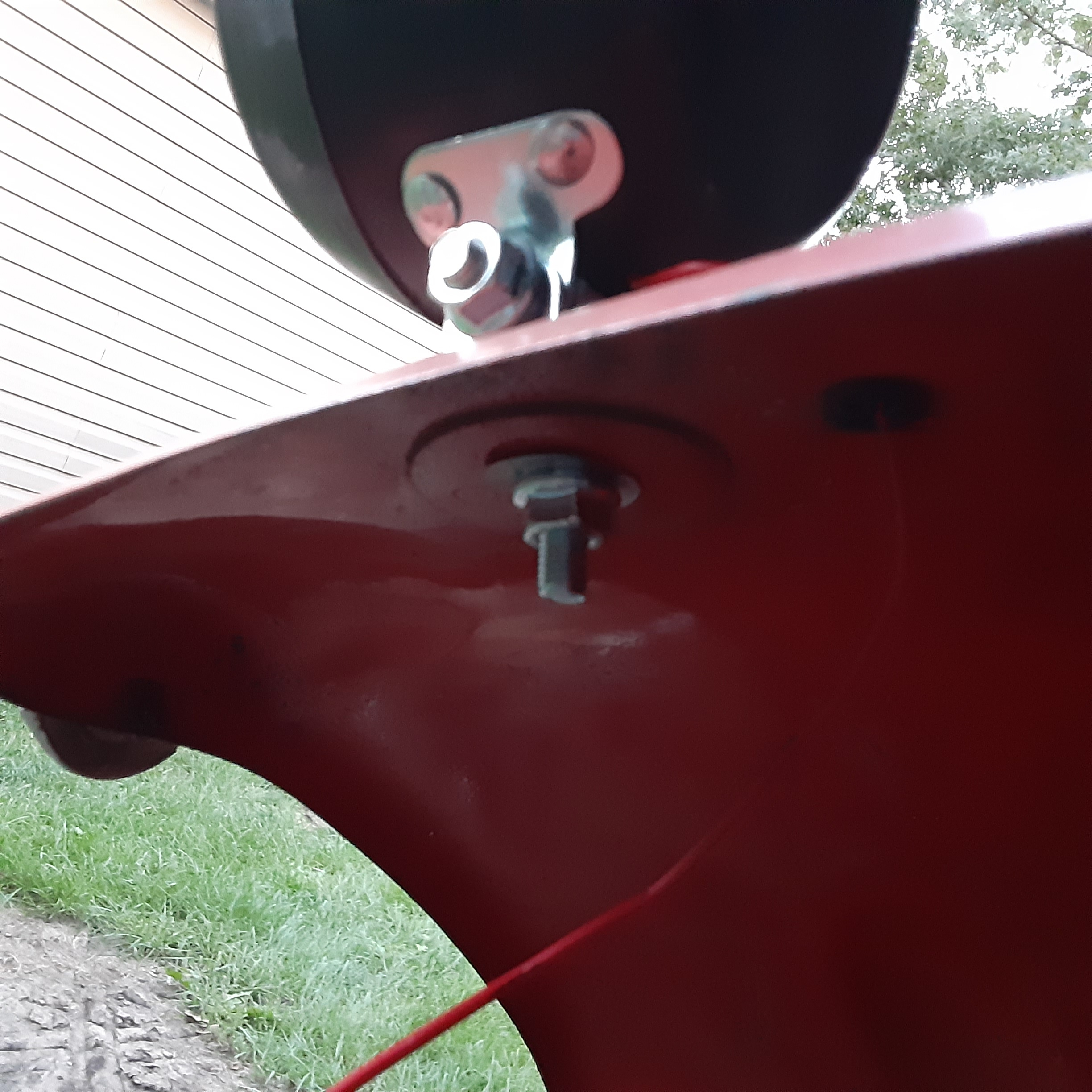

One hole in the fender is for the mounting and the other for the wire to pass under the fender and clip mounted to the wire harness of the 2-way flashers. I added a body grommet t protect the wire.

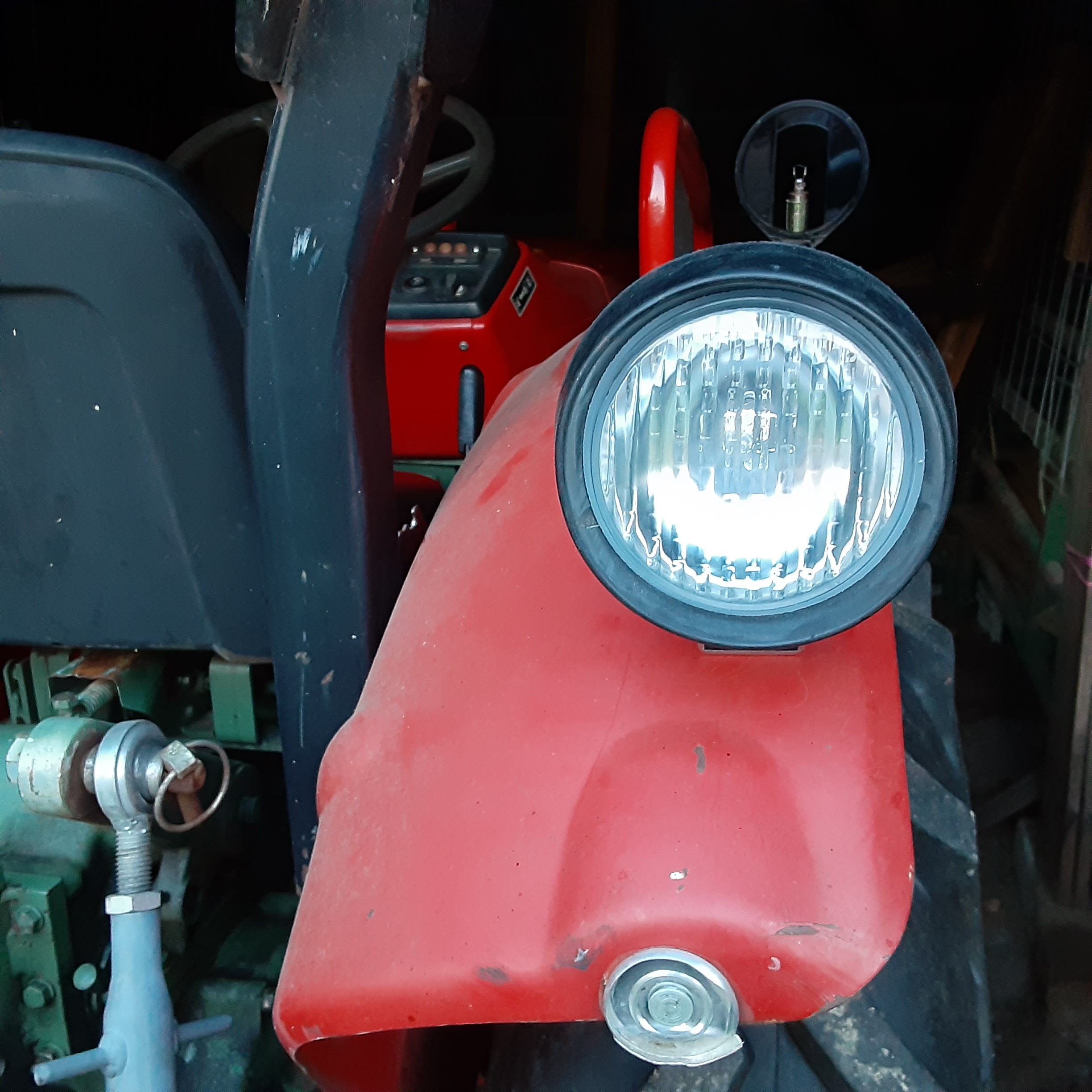

It nearly looks Yanmar OE. Just need a switch and a fuse next. :)

Looks original! I hope that yours lasts longer than mine did. Under 20 hours of use for my HF before it died...I switched to LED, and yes, it wouldn't look authentic.

I added a grommet for the tiny wire too. I may need to place a thick heat-shrink tube on it above the fender and thru the hole.
