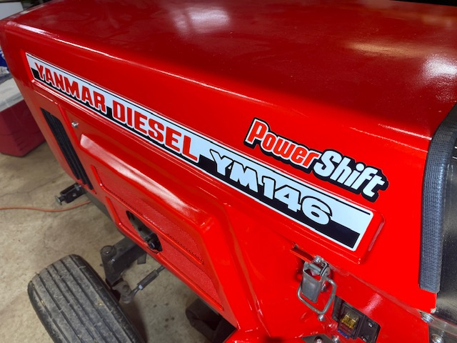

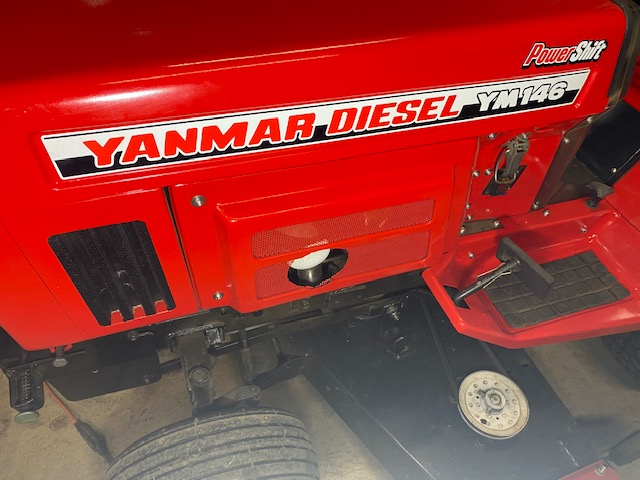

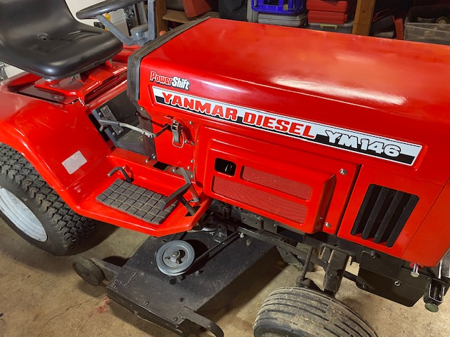

#15
The stickers are on looks great.

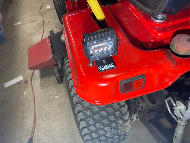

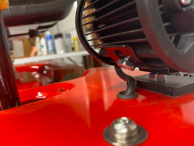

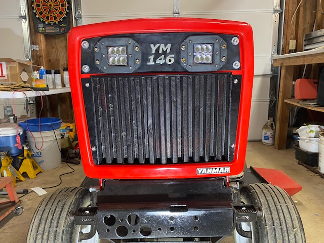

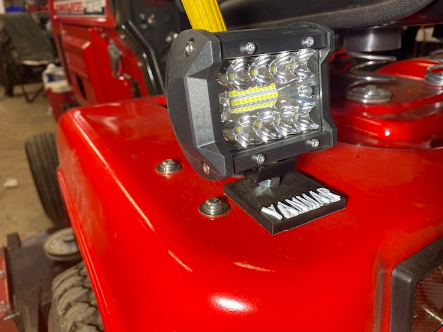

I also installed a rear LED work-light on the fender. Yanmar looks like they made the fender to add a light since they have an extra hole with a grommet through the fender and under the fender for the wire. I wired it to my head lights which are also custom LED with a plasma cut grill.

   / Painting YM-146 Clearcoat or no clearcoat any advice #17
Yes, there is a rear work light.
   / Painting YM-146 Clearcoat or no clearcoat any advice #18
Nice restore job. It would be great to take to some of the Old Day tractor shows. It would wins prizes.
