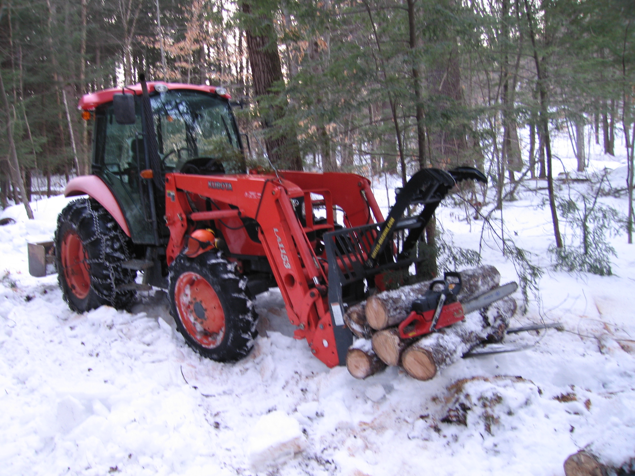

I use my rear remote to operate the Greens Machine "Thumb" 36 inch model, mounted on my forks.
It works fine but I should have mounted it either lower or at an angle to get some overlap between the forks for better grab on smaller stuff.
It is boltable [sp?] or doing the welding yourself will come in under $600 if you have remote hoses.
It doesn't have the 3rd function joystick convenience, but for the price it is a bargain to get a functional grapple

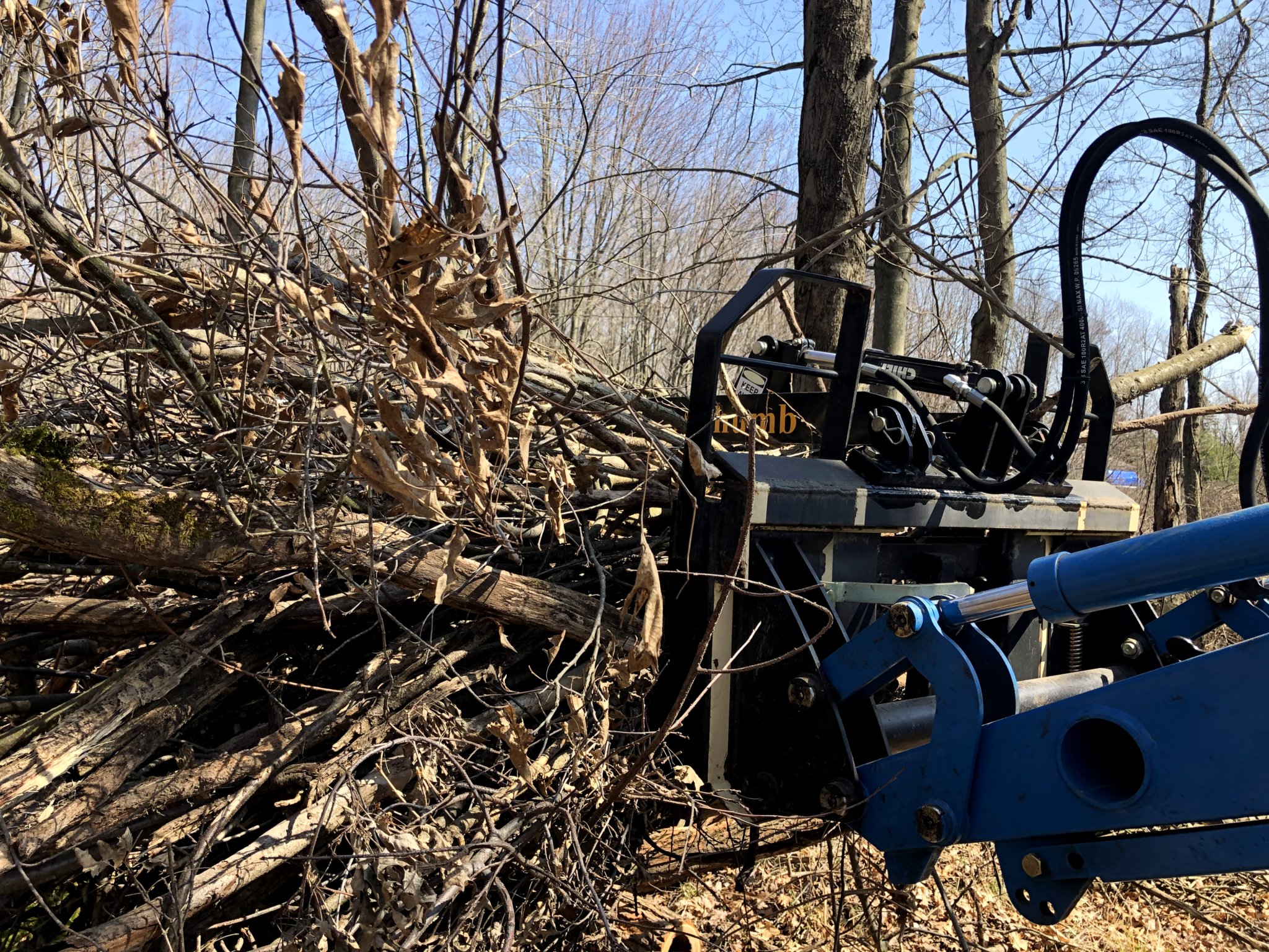

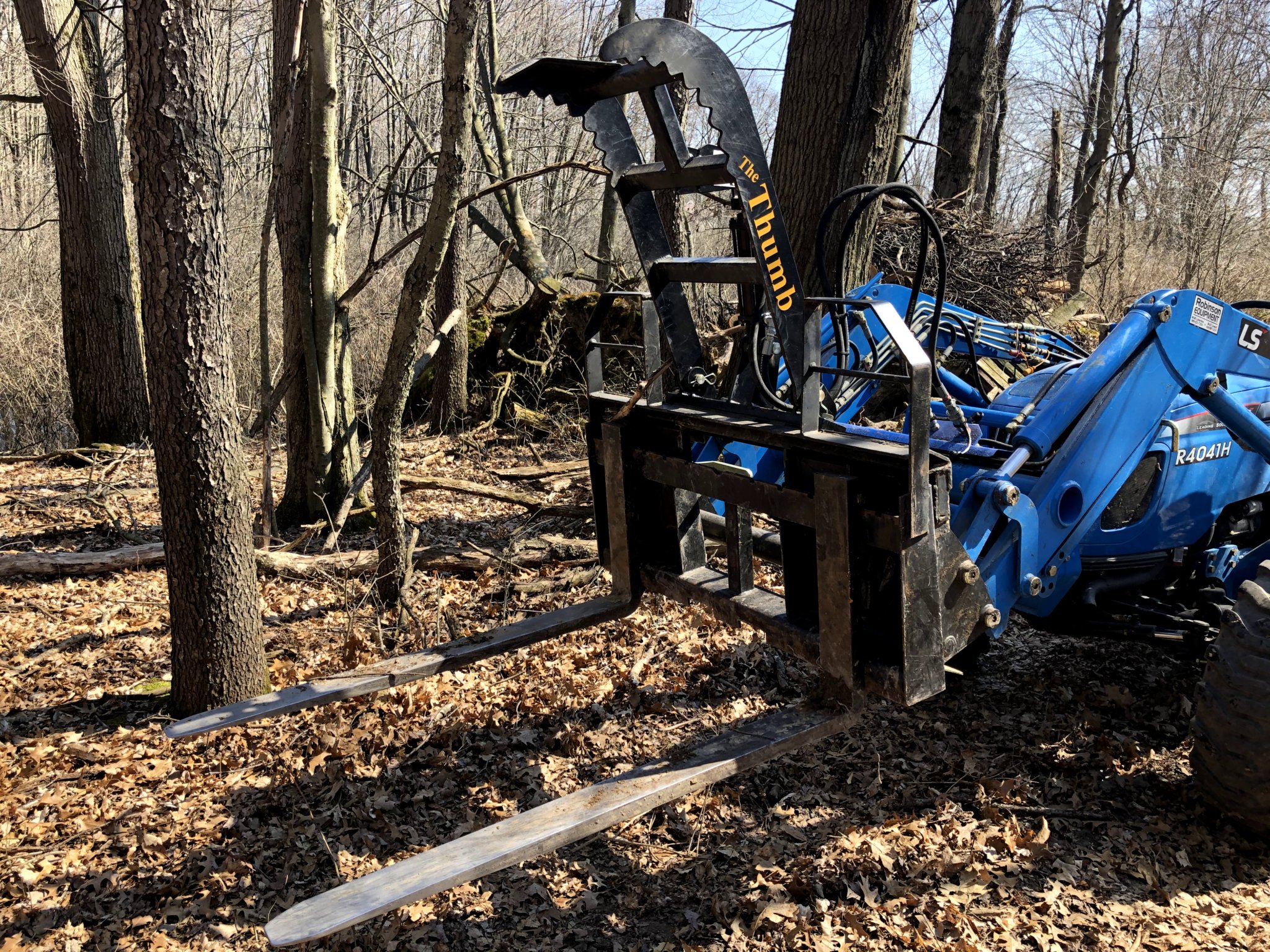

I run mine off the rear remotes also (I have 2). I can remove 4 bolts and mount it on my loader bucket also.
I usually don't have the thumb mounted most of the time, only when I have a lot of brush to move.

I also did not want to spend a lot on a rig that would sit much of the time and the Thumb fit the bill perfectly.
