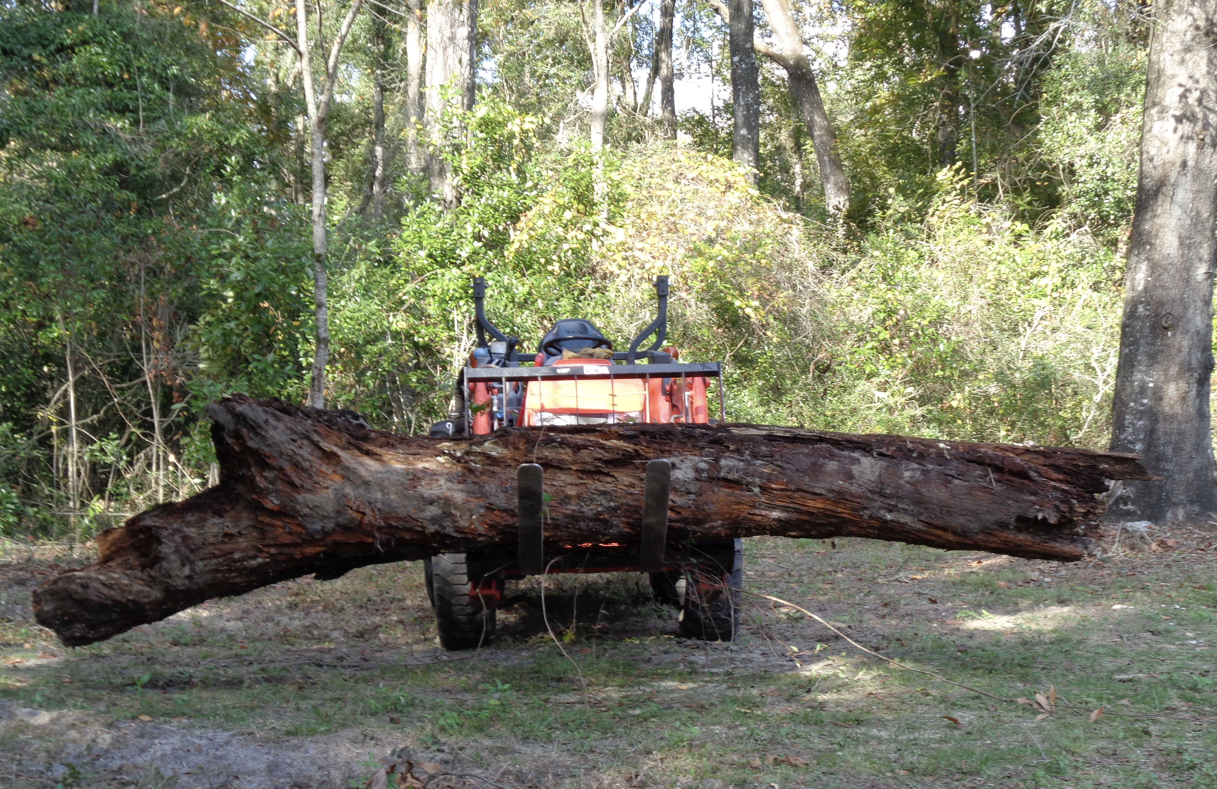

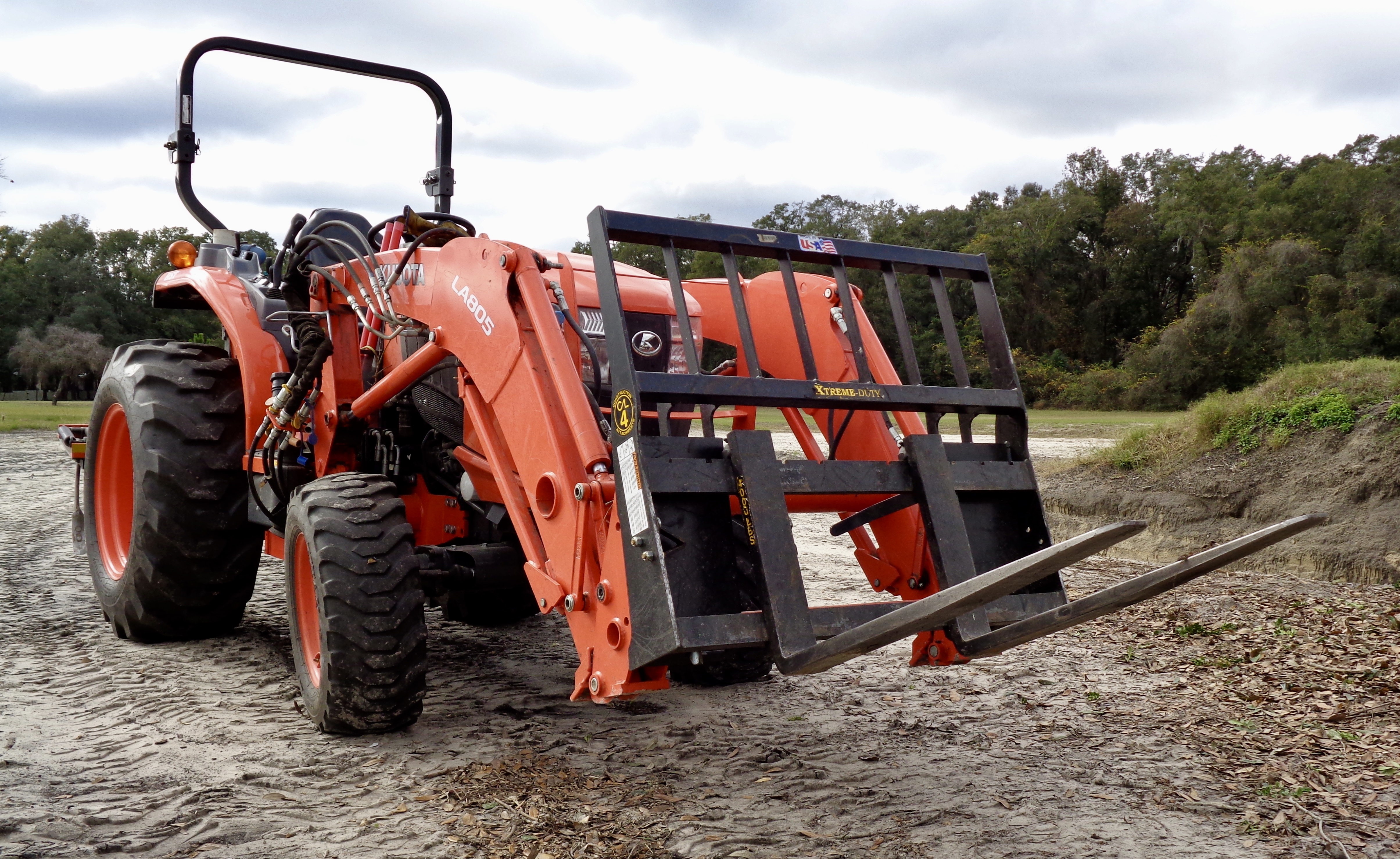

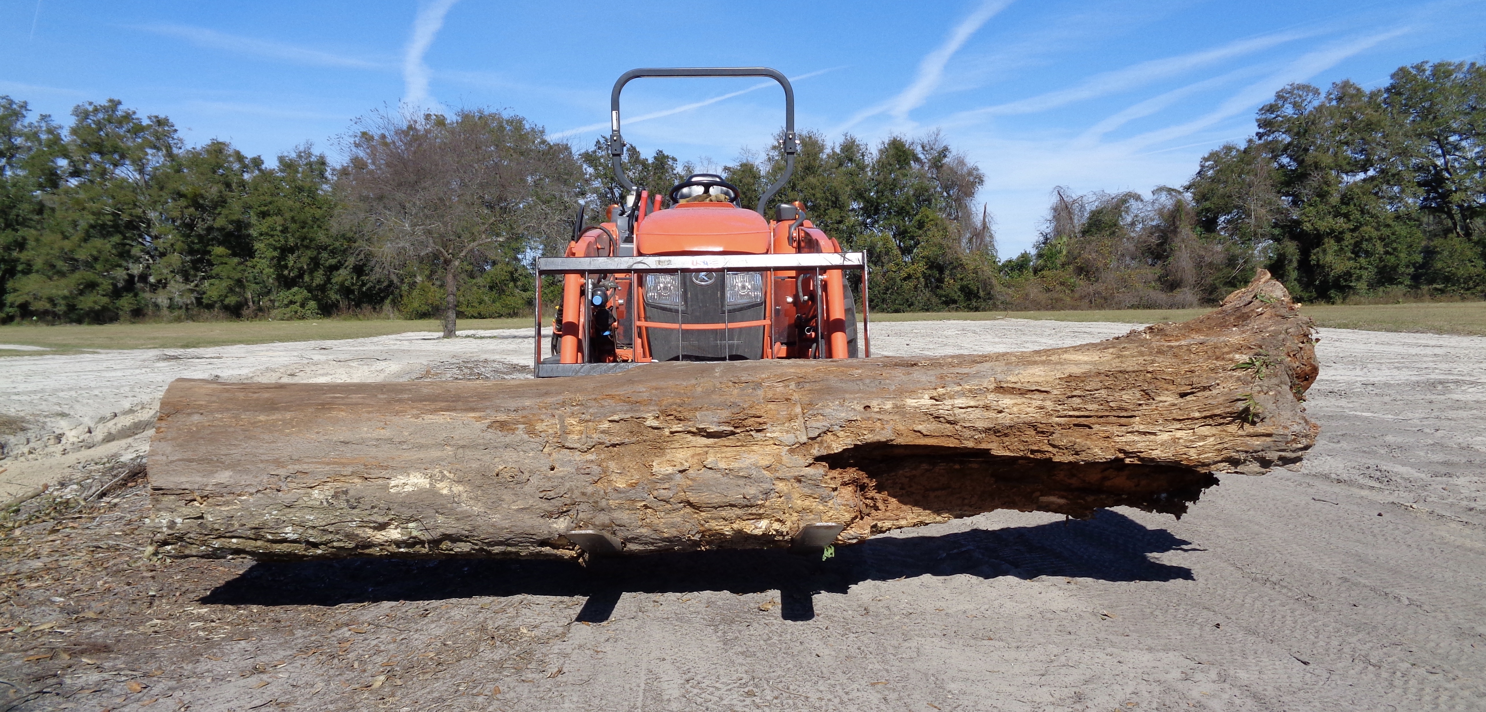

I have 38" SSQA Pallet Forks by Construction Attachments, sold by everytfhingattachments.com.
Pallet forks are often used to move material, often timber.
Shorter forks are more maneuverable in woodlands, yet manage to use all FEL lift capacity.
