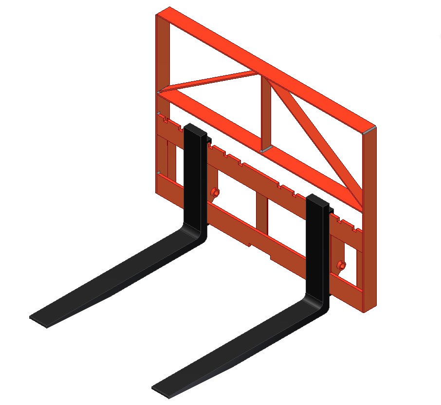

Hey MWB I seen were you had built a carrier that you posted a diagram of in another post and was wondering how it has held up and work out for you.
   / Pallet fork rail notch measurements #12
It works very well. It is often used for moving and loading logs, no problem. It is installed on a Kubota L3400.
Here is the quick sketch of the carrier. The flat stock that the forks hang from is 1/2", notched on the top for the fork lock pins. To save weight the QA connection was fabbed from some flat stock rather than a complete plate. I have not included all details, gussets and such but the general idea is here:

Great, I hope to get mine finished by the first of next week. I plan on working on it Friday evening and then finish it Monday, along with my brush grapple if the cylinder comes in.
   / Pallet fork rail notch measurements #14
CB,
Here is some info on the one I built. I still haven't taken any pics of the finished product, but it looks just like the 3D models. The spacing on mine ended up being 9, 17, 25, 33, & 41" O.C.
The drawings to build this are also attached with a complete parts list. Cost me about $100 in steel and $20 in paint plus consumables. Pay no mind to the attachment points as yours may be different, mine was built to fit a Kubota LA364 loader. My loader can lift around 1000 lbs at the pins, which according to computer models should no be a problem with this design (about 9 tenths of one one thousandth of an inch deflection in the center of the fork rails at full load) Notice the angle and the 3/8" x 1" flat bar used to stiffen everything up.
If you have any questions let me know. Oh and from what I found out afterward, the one I built is a couple inches taller and wider that the one I was going to buy from Kubota, but I don't think that matters.
Total weight of carrier is 125lbs as drawn.
