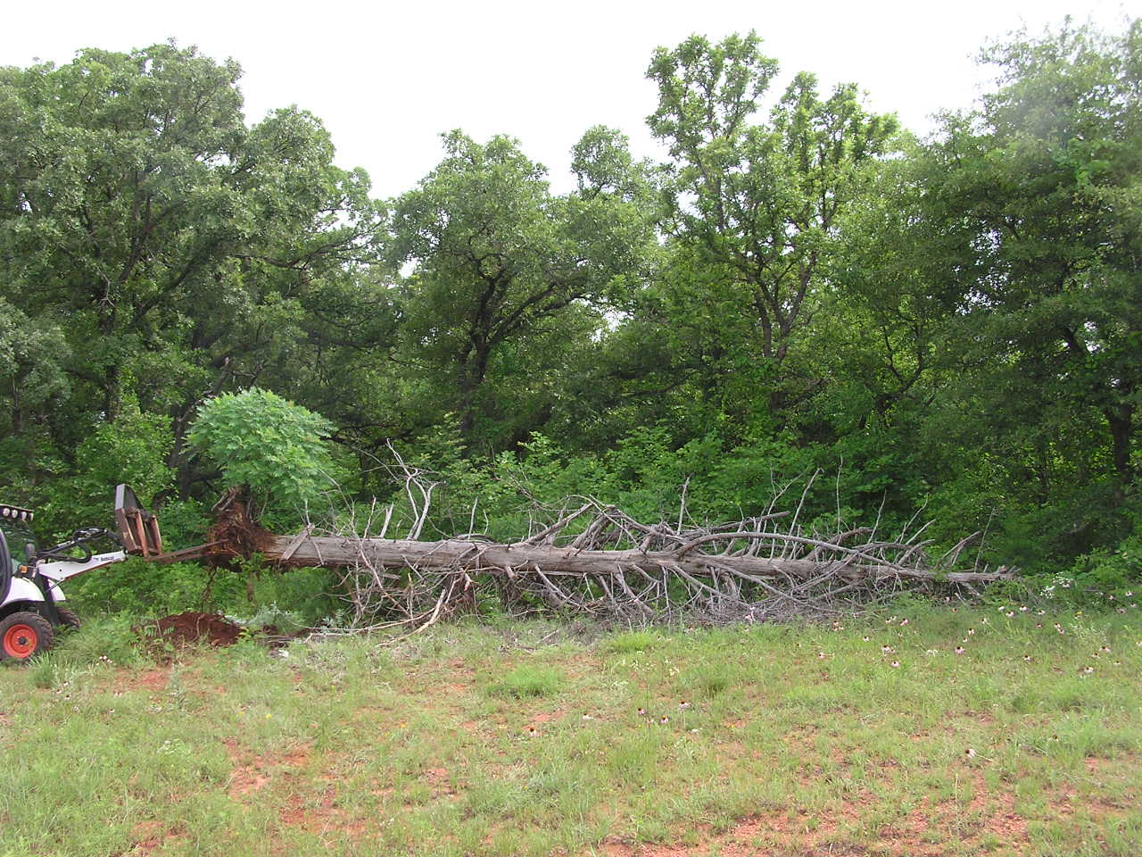

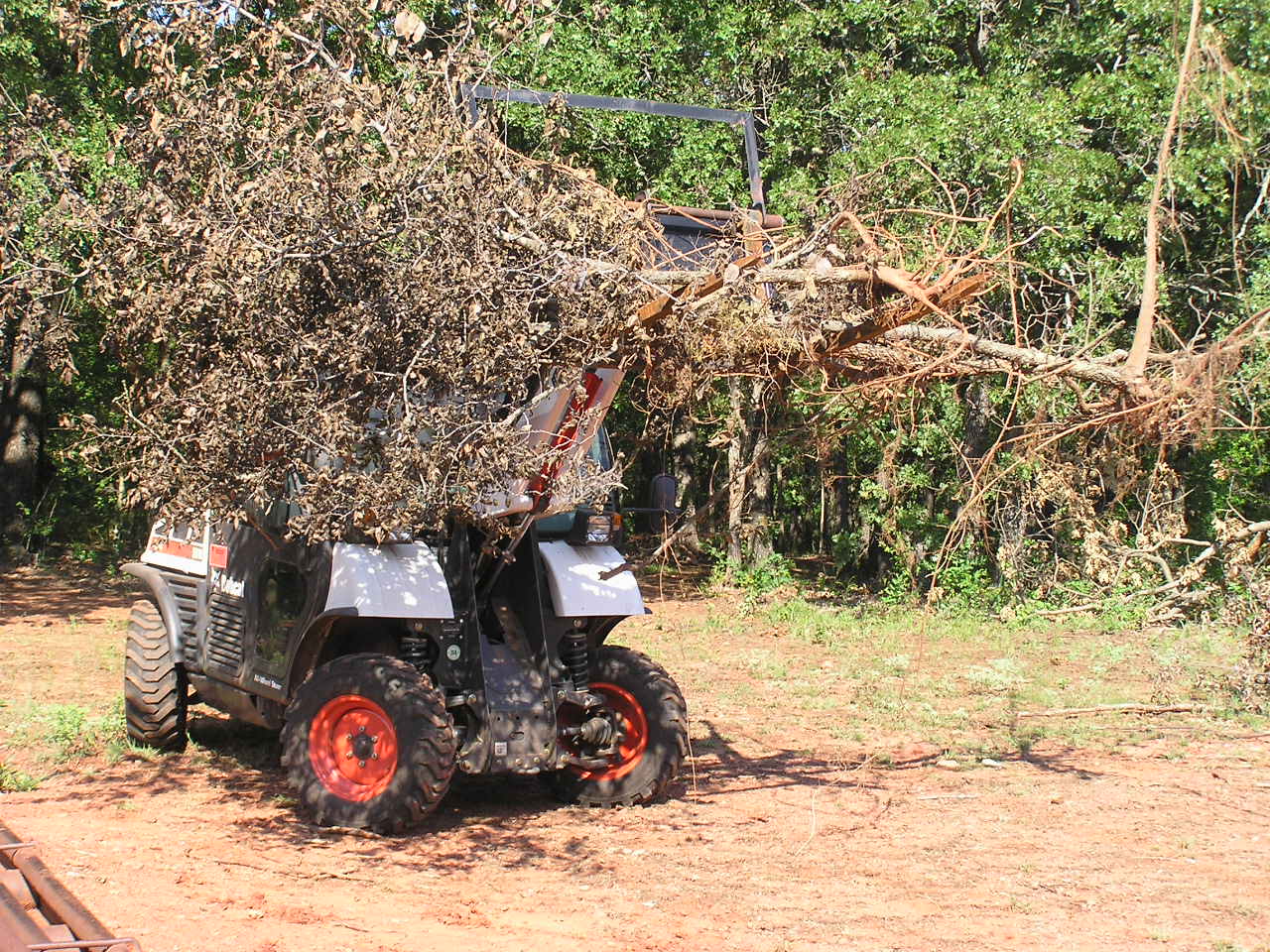

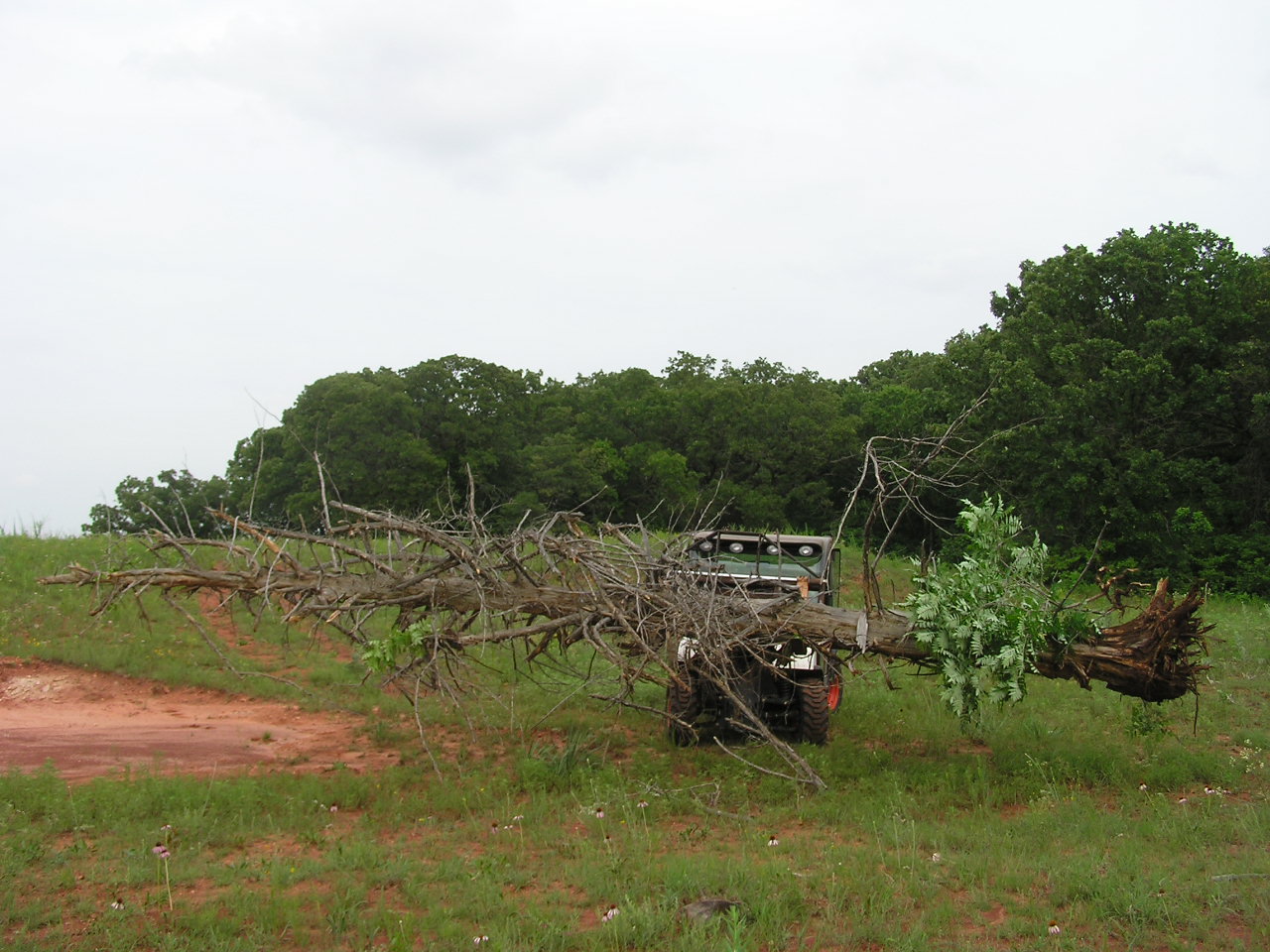

Short forks can be extended using a sleeve (made from channel stock that is wider than forks) for occasions that require long such as large piles of branches. The sleeve will work as being longer your weight capacity is greatly reduced.

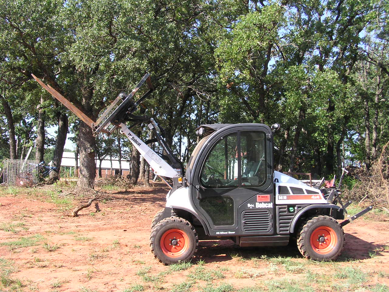

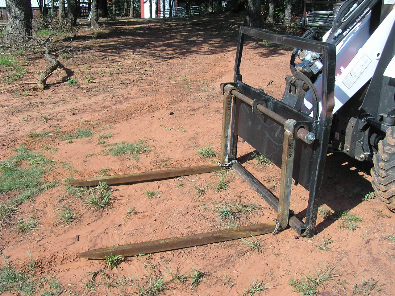

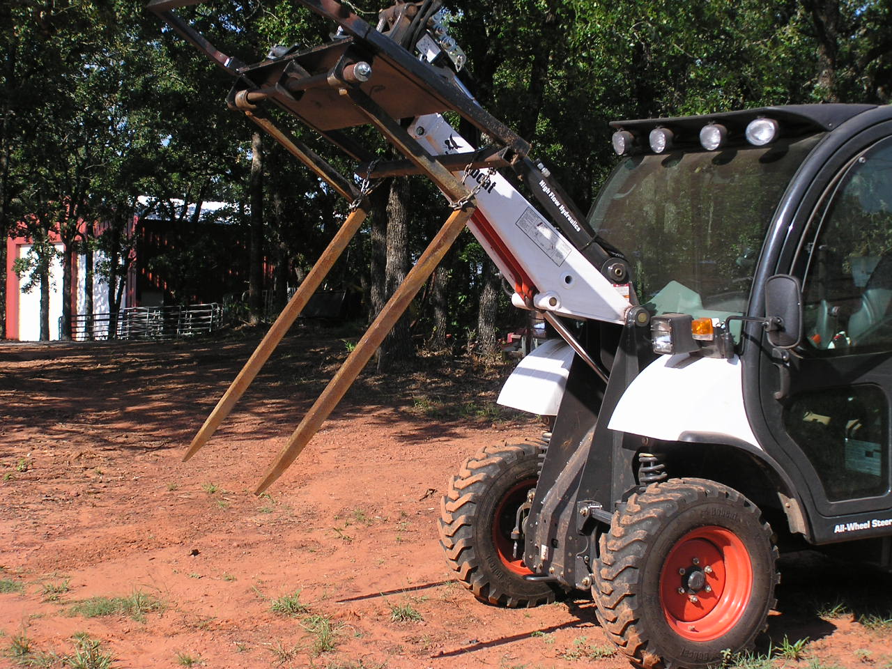

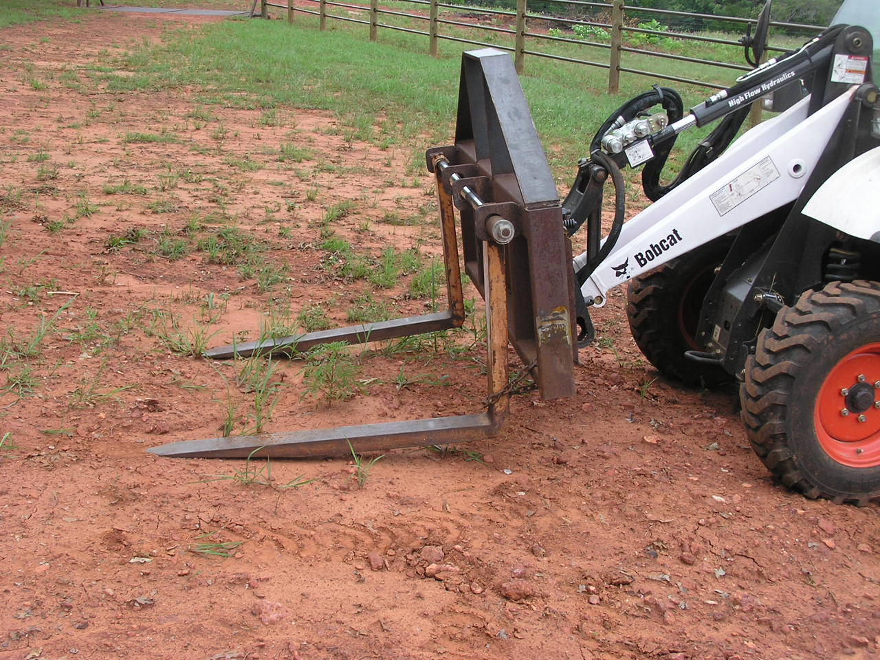

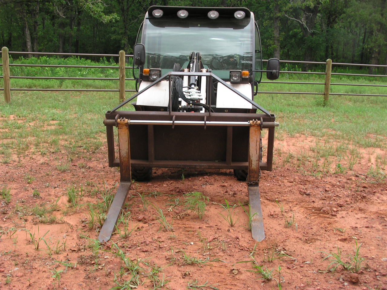

These are 42" pin top forks from a forklift repair shop. Each fork weighs 135 pounds, frame is 284 pounds.

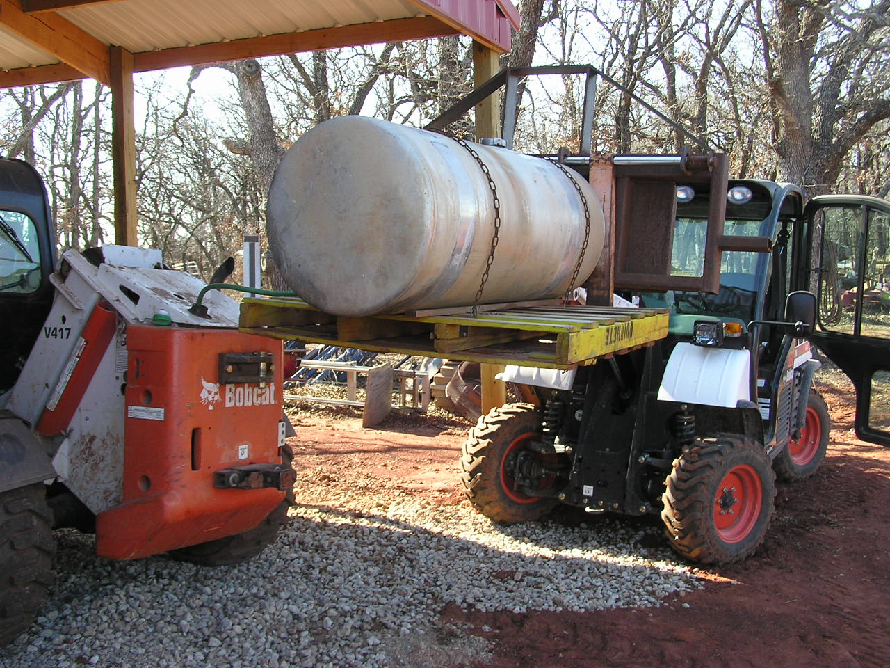

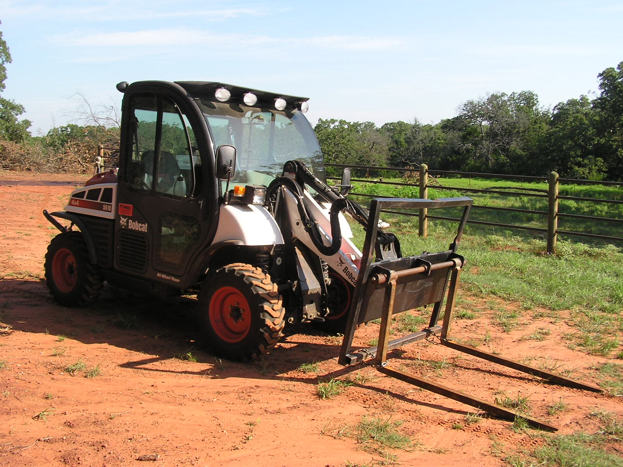

Found these 48" block forks on eBay. 2" square and weigh 80 pounds each. Already had the light frame.
