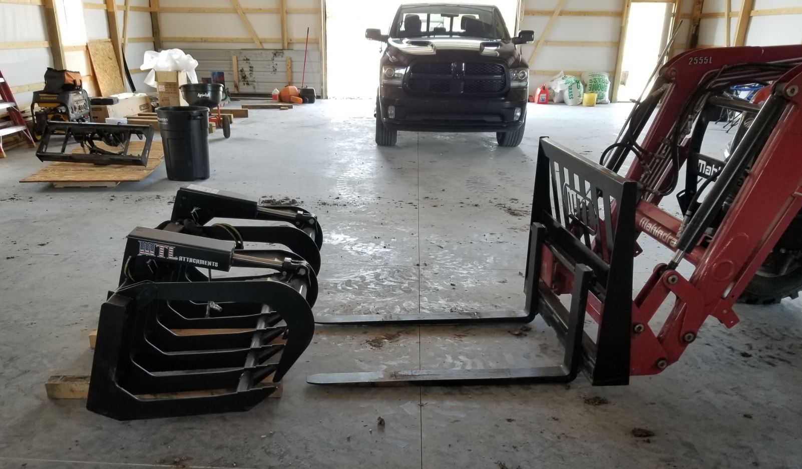

Just got these toys yesterday, and thought the price was right. Paint job sucks, but I expected that going in based on earlier reviews. I'll let it flake off for a while, and repaint at some point if I ever care enough.
I got the grapple and 48" pallet forks for $1500. May not be EA quality, but I bet they do everything I need from them. I was able to get both of these, plus 40 feet of pallet racking for considerably less than the EA grapple I originally considered.
Kind of been a big couple weeks. Got the grapple, the pallet forks, pallet racking all yesterday, and a couple weeks ago I ran into that HD25 post hole digger in the background for $1K, barely used. Already dug a handful of posts with it, works great until it hits the limestone rock bed under everything around here... :(

I bought the same setup (well I got the 60” grapple and orange) a few moths ago from MTL. I have been pleased for the money. I have had a Wild Kat grapple on my Mahindra for years with zero problems and it has been used hard. I just didn’t see paying twice as much for a grapple. I figure if something bends or breaks I will just have it welded back.
