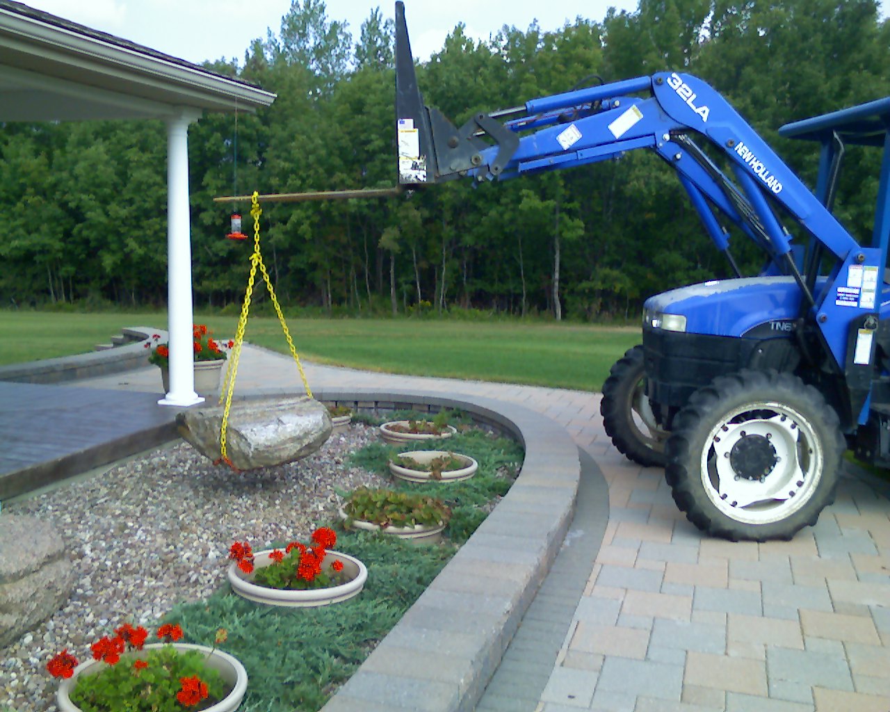

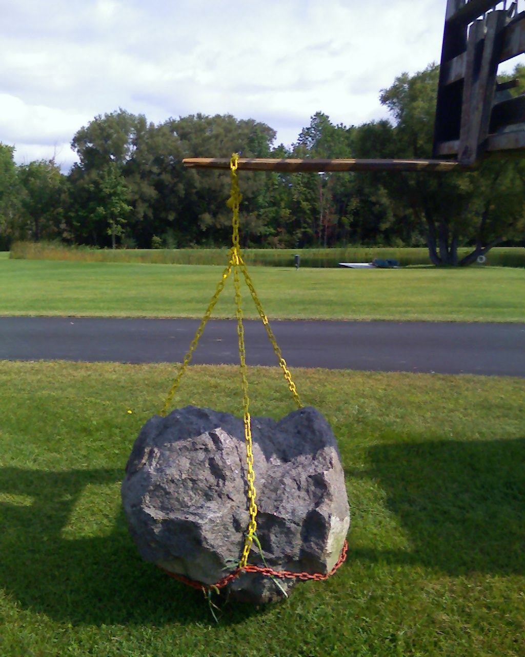

I made a boulder sling with about $10 in chain. Works great in setting large boulders exactly where needed. Not an original idea, I saw this somewhere on TBN in the projects area. One loop around the bottom (red), three lifting chains (yellow) to forks. Boulder is easily rotated while in the air.
Nice idea. I like it. The obama-conomy has hit very hard and expensive attachments (other than a Artic snowplow I am buying) are out of style for me for the time being.
I think forks might be the ticket. Relatively light, very inexpensive, adjustable and useful for other tasks. I like the fact that I can mount the forks and then chain my bucket to them for transport, too.
