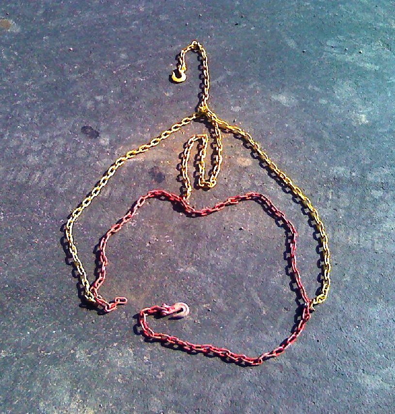

on the yellow chains is there some type of forks or is that the red chain wrap around
I made a boulder sling with about $10 in chain. Works great in setting large boulders exactly where needed. Not an original idea, I saw this somewhere on TBN in the projects area. One loop around the bottom (red), three lifting chains (yellow) to forks. Boulder is easily rotated while in the air.
   / pallet forks or grapple for boulders? #28
I painted the loops to eliminate confusion. Yellow lifting, red around boulder. Simple & cheap. 3/8" bolts at the connection points, shake the chains in a paint can & hang to dry.
