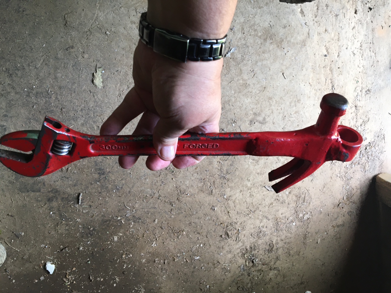

Tool I use to tighten the bucket pallet forks. The short thick wall tubing top of the hammer head fits the bar handle top of the clamping bolt. Rotates to always have a good angle on the tightening bolt. The extra leverage secures them better. Have the option to chain them down too but have never needed to.

Neat Swiss Army Farmer Tool. A tad big for the pocket, but one should have room somewhere on the tractor.
Love that thing Smokeydog. I have a small collection of multitools like that. They are always a bit compromised in function, but they can get the job done in a pinch. I carry a different one in each of my tractors, side-by-sides, etc; trying to figure out which works best and where. I would like to find or make the ultimate 3-point hitch tool.
