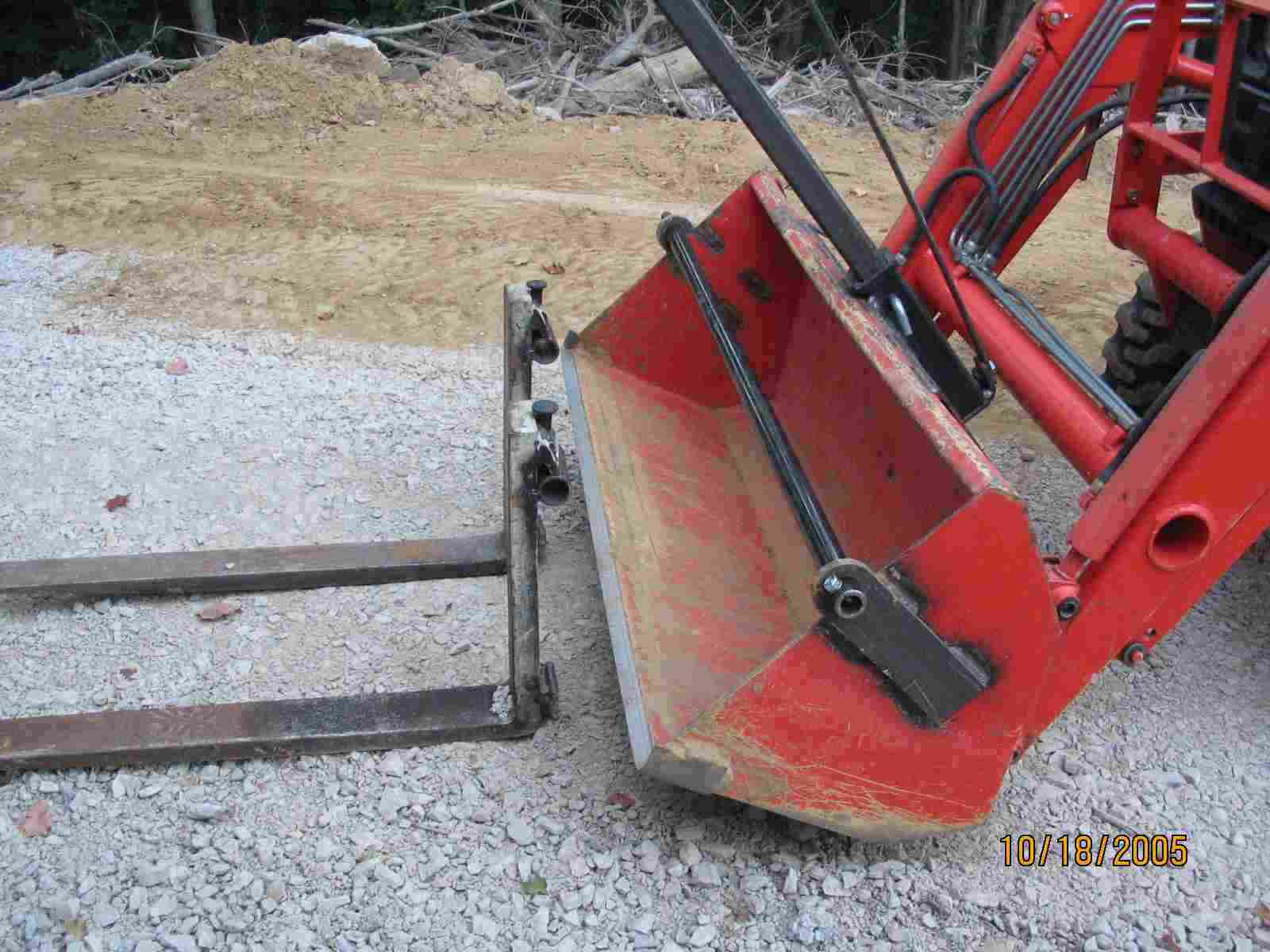

I too have a B7800. This setup has proven itself over and over. I leave the forks on all winter to haul in firewood. I have loaded tires plus a 500 lb box on the back and still can raise the back tires off the ground. I am amazed at what it will lift. It is nice to be able to unload a pallet off the trailer and deliver where you need it. Also very handy in the wooods for moving brush and small trees.
Here are a couple of pictures of them in action.
http://www.tractorbynet.com/forums/...871-bring-more-firewood-easy-way-img_5530.jpg
http://www.tractorbynet.com/forums/...4-bring-more-firewood-easy-way-img_5528-1.jpg
Here is an older picture of what I did before paint.
