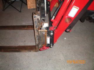

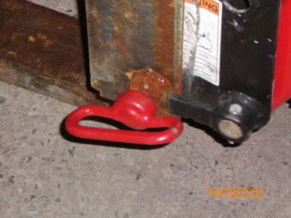

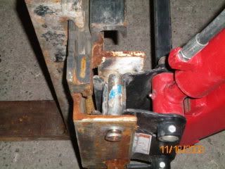

Here are a couple of shots of my home made pinstyle quick attach plates for my forks. They are made of 4"x4" x1/4" angle not 3"x3" as i originally thought.
