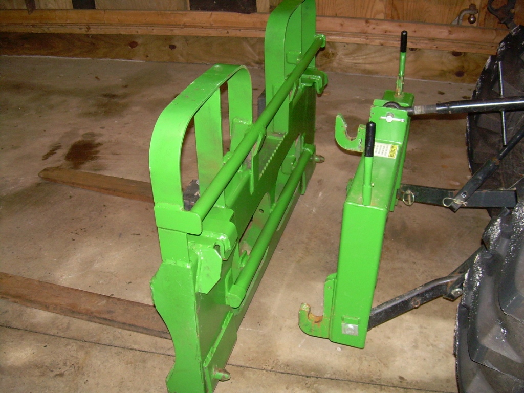

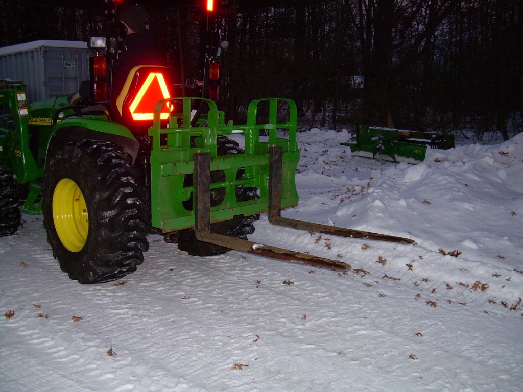

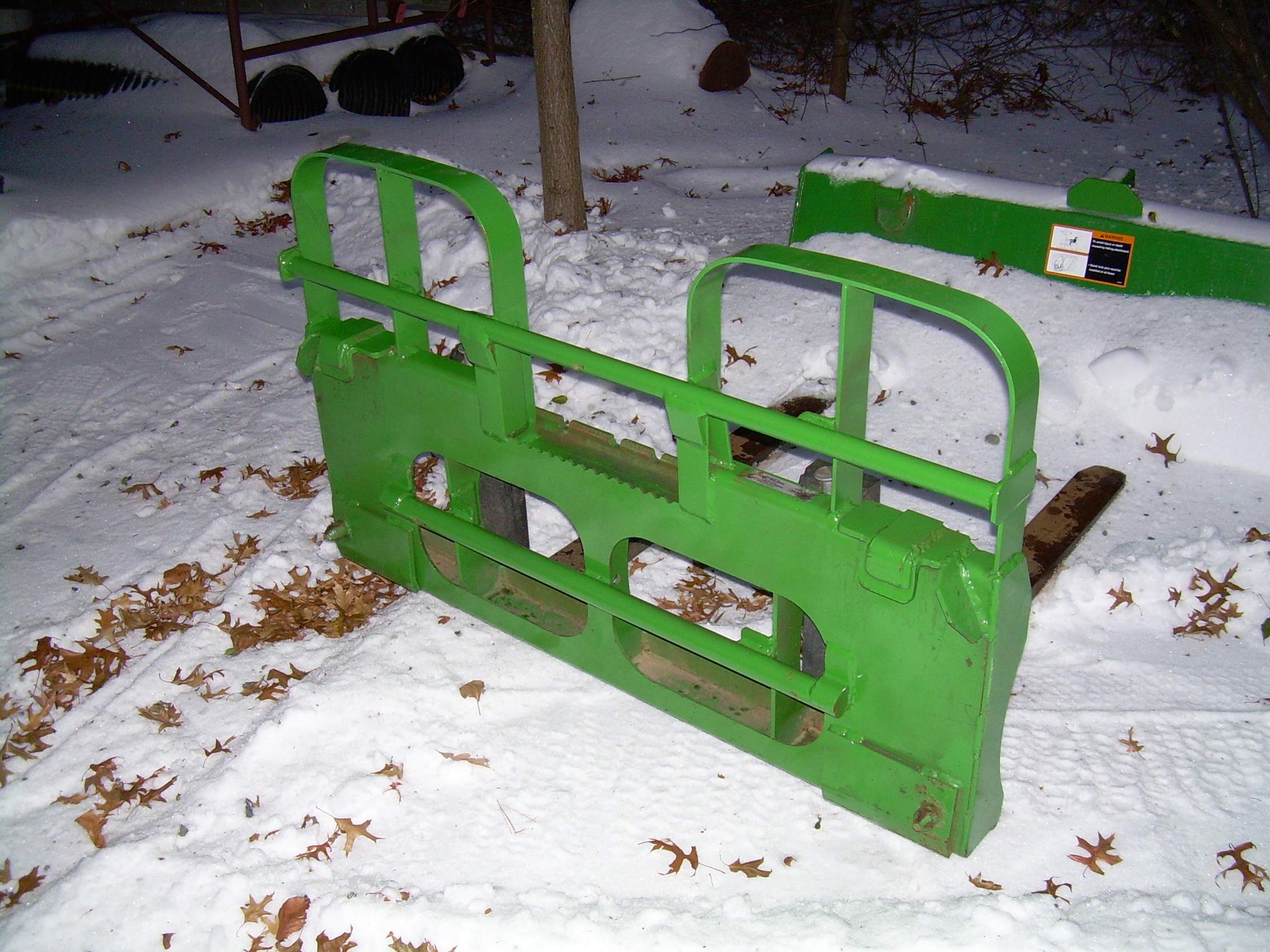

JB4310, any chance you could post pictures of your mods to make your Horst forks fit on the 3pth? I am thinking about doing the same thing. It's not very complicated, but if you learned something that I haven't thought of, I'd love to see it.
   / Pallet Forks #15
I welded solid steel round bar stock on, for upper and lower J hooks on the imatch. Can't remember the diameters but they are different sizes, I was able to find exact tight fit at a scrap steel dealer.
