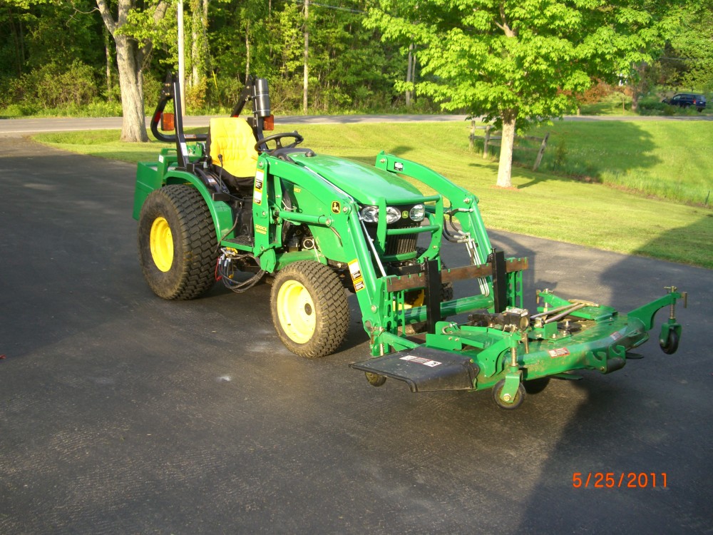

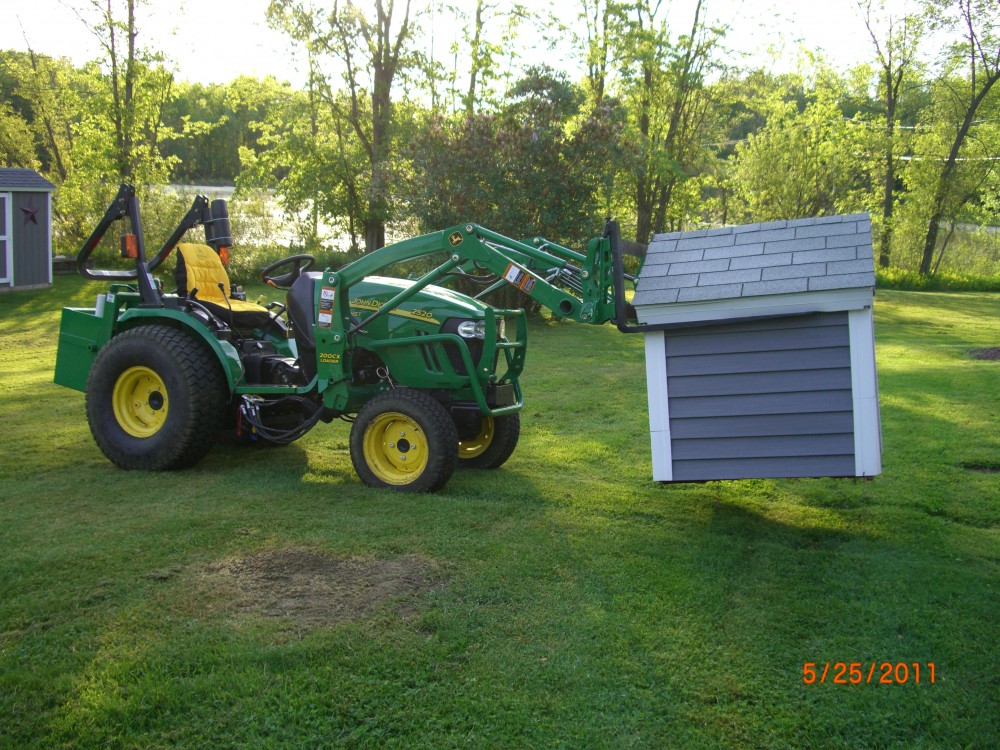

HINK10,
Just bought a set off ebay a few weeks ago myself to go along with Chris's fork frame. When you do unwrap your forks you will have to hit them with a round wire wheel to knock the surface rust off them and then wipe them down with some mineral spirits. I threw a couple coats of primer on them and then shot them with 2 coats of black rust inhibitor paint..
Have fun with the forks, I do !!.. They work excellent.. :thumbsup:
