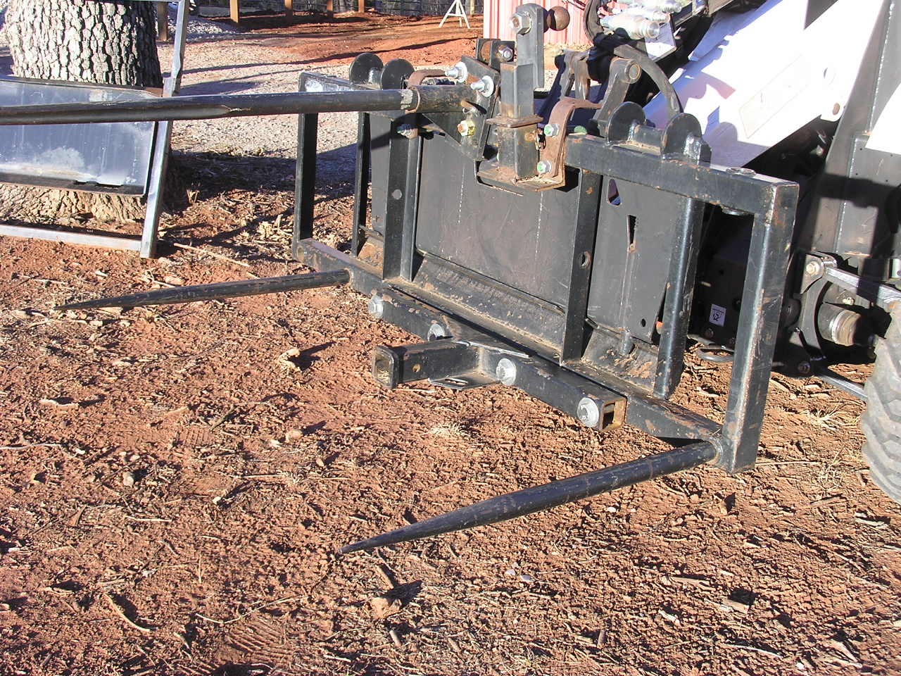

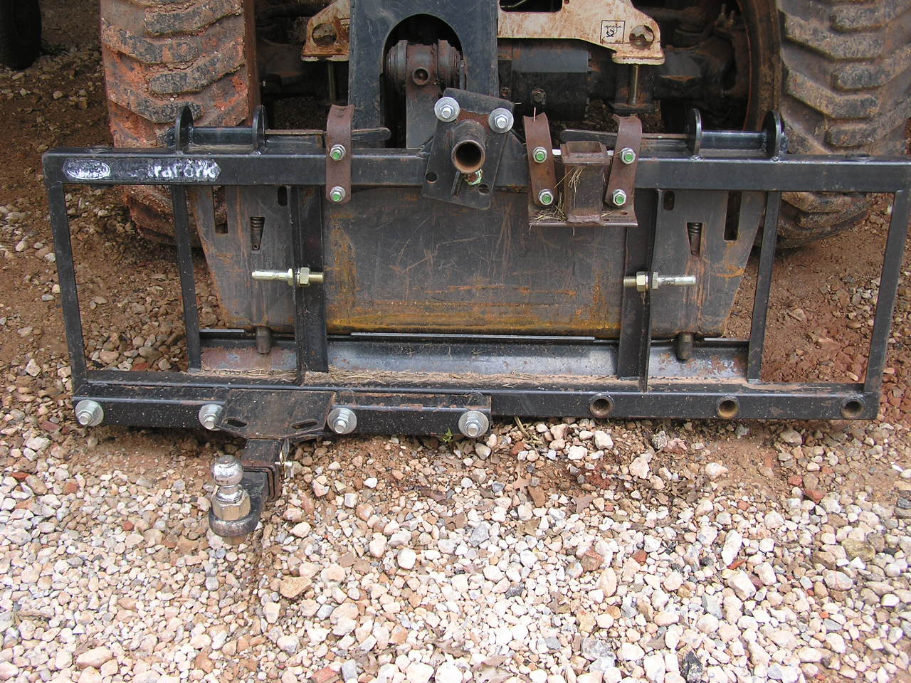

I was just showing how a fork frame can be made to fit on the 3 point or FEL QA.
I like the trailer receiver in the first pic. Very handy to move trailer around. Did you make that?
Yep, cut the ends off of a receiver hitch and drilled holes through it so it would bolt on through the holes in the Speeco UltraFork frame.
