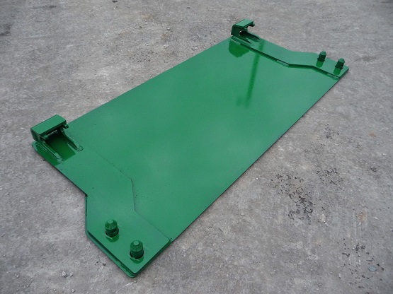

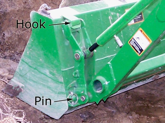

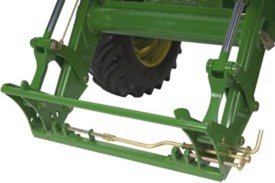

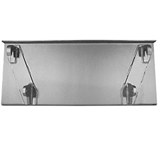

/ Pallet forks #7
The John Deere QA:
Global Carrier:
SSQA:
/ Pallet forks #8
Good pics of the various quick attach,
I prefer the global they seem easier to reconnect,
and safer to disconnect.
The global on the Puma and 5070 have a catch when you unlatch,
after you catch the top hooks and rotate up when the lower pins lineup the latches engage automatically.
One time disconnecting I unlatched the ssqa with the bucket tipped down, just reached over the bucket and unlatched
it fell off and almost got my toes.
The globals upper hooks stay engaged till you lower down out of them.
