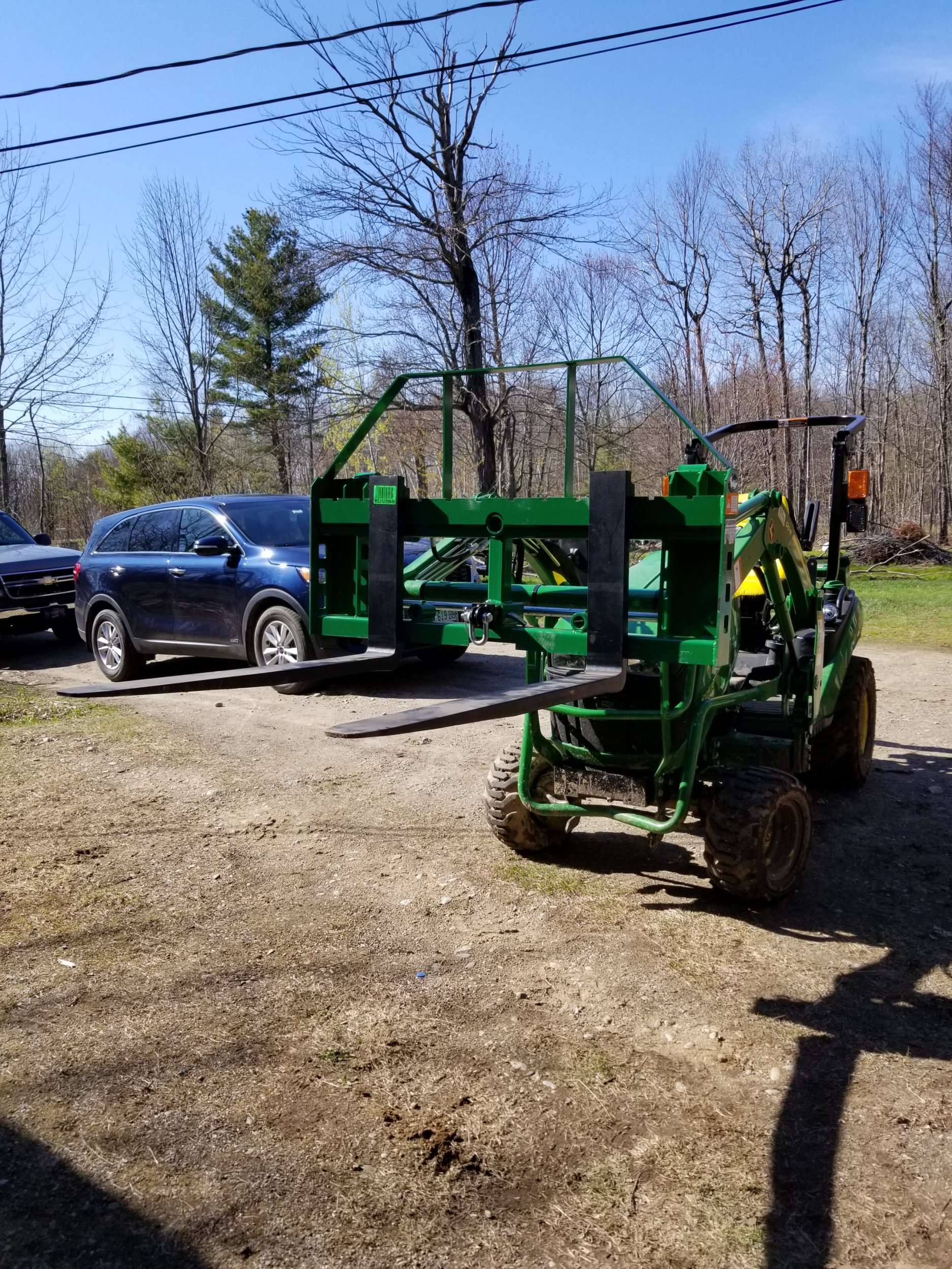

I'm a fan of my 42" forks from Titan; the fit and finish is ugly, but the build quality has proven pretty solid. Add to the versatility of the forks themselves, it's got a headache rack and a 2" receiver as well as spots for bale forks I'll never use. I've moved pallets, implements, metal sculptures, etc. They're not as cheap as they used to be, but still cheaper than much competition. If you're cool with a 10ft paint job and inevitable rust, I'd recommend Titan any day.
Obviously you're using a considerably larger machine, but these forks are rated for FAR more than my tractor is capable of lifting- something like 4k pounds if I recall correctly.
