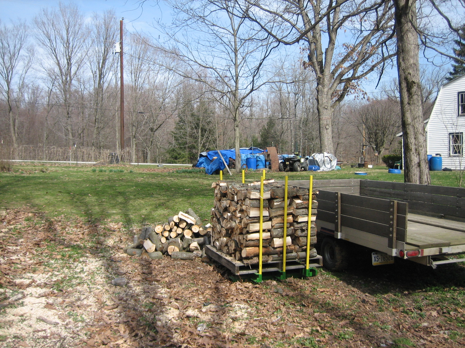

Since I am a newbie I need to show everybody the pallet/ holding fixture that I made for a friend several years ago. It works like this. Put a surplus pallet onto the fixture, I think I made it to hold one that is 48" 48 ". Load it with wood as shown. Lift it up the fixture with your tractor forks. The fixture has fork access from either side if I remember correctly. Use plastic banding on each row. Set the fixture and skid back on the ground. Pull out the pipe. Lift out the pallet. Put the pipe back in and start again. My friend needed to put the wood on his mother-in laws front porch for her kitchen wood stove. He would make up 15 to 20 of the skids for winter season. Just an FYI.IMG_0600.JPG
