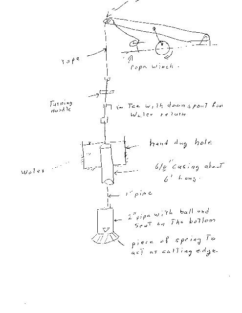

I have been looking at things to and the idea that seemed best for a DIY, looks like what I have drawn,
a beam with a rotating crank that would lift the beam pulling the cable down and then slipping off it dropping it,
the other was similar but with a arm that lifted the beam but had a pin that would catch it and when if over center the arm was free to spin
the picture is of the first idea,
the you tube is of the second, about 50 seconds in to the video you can see the pin and the arm work, (it looks like there using this for a driver in the video, maybe putting down the casing)

go look at the picture,
the cable/rope is threaded through a series of pulleys. and the "walking beam" the (teeter toter type arm), it purpose is to pull the cable up and then drop it,
by making, a crank (powered and geared down from the engine), the crank (with a roller) on the crank to reduce friction and wear, when the cable is down the walking beam is in the up position with the tail of it down, the crank comes around and catches under the beam and lifts it up on the tail end, moving the pulley end of it down pulling the cable up, as crank nears the top of the rotation, (in the drawing) it slips off and let the cable drop,
(the main draw back of this design is one will need to create a stop to limit the drop or watch it close so the crank can always get under the beam,
on the second, ( see video aobut 50 seconds into it),
the difference there is a swinging arm that is attached, to the crank and to the beam,( or directly to the pully) and the fixed section of the crank catches the arm at the top of the stoke (rotation of the crank), and then pulls/rotates it to the down position, and when it over centers at the bottom It allows the cable/rope to drop, or free fall, swinging up very fast, and as the slower crank comes back around catches the arm and pulls it down, and repeats the cycle.
(the idea is to pull the cable down and drop fast it so the bit can do it work of digging the hole), by letting the bit pulverize the dirt or soil in the hole,

That should work. You may consider having the cable on the lever arm going around a roller or shiv and then down to a winch so you can lower the tools while pounding.
A different way of drilling the well is to keep all the topside stuff you have shown but discard the drill bit and replace it with one to one and a half inch pipe with a chisel bit and check valve on the bottom. You'd have to rotate the drill stem by hand.
The bit is just a piece of pipe with a steel ball and seat in it with a piece of truck spring welded to it that is the length of the diameter you want the hole to be. Also some holes below the ball and seat in the pipe.
One digs a sump about three feet deep and then uses a post hole auger to go down another six to eight feet or so. Put a piece of steel pipe in this hole as casing that comes just below level to the surface of the ground. Fill it up with water and start drilling. The chisel point loosens the soil in the hole and the ball and seat with the drill stem moving up and down make a pump which brings up the cuttings and leaves them in the sump to settle out.
When you hit water the sump starts overflowing.:thumbsup:

Here is a pretty rough diagram.:eek:

Did some watching on you tube and found these. Similar in method but slight differences in construction. The one my Father and Grandfather made was very little actual work as the drill stem was raised by a walking beam driven by a small motor. All the "Driller" had to do was turn the drill stem by hand.
The last one will give a very good idea of how it is done. Note the clay they dumped into the hole. This acts as a sealer as the hole gets deeper and prevents the loss of water to the soil layers in the well bore. :)
