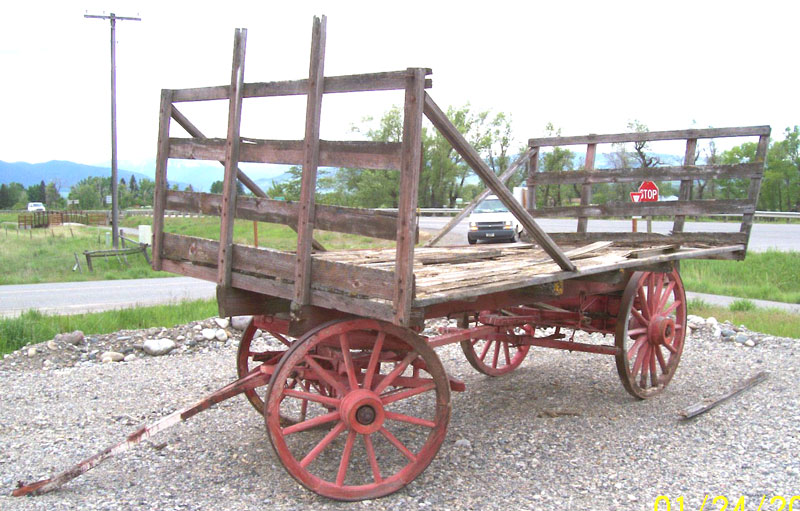

Just an oppion,
My FIL had a IH cub, and it is more than a lawn tractor in size, and to keep a scale,
I would consider a wagon bed at least 6 foot wide and 10 feet long, for the scale aspect of the wagon,
I know hay wagons designee have changed to what type of hay is being hauled, over the years, but my idea is the classic loose hay wagon, with up right front and back of the wagon bed, http://www.desertclassics.com/image3/HayWagonRedWheels1.jpg this is a old wooden wheel wagon but the type of designee I think of,
I would probably strive for some thin like this,
Amish wooden hay wagon
most old hay wagons were wood beds and I think easily made,
most running gears were bought, (I have to say the idea of the link above of the modified rims with the spokes for the wood wheel or steel wheel look) Chats Custom built wagons for parades homecoming advertising hayrides for sale
