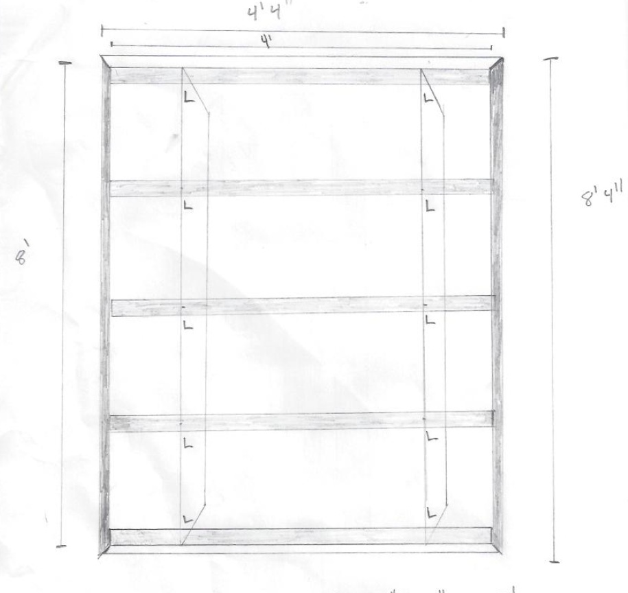

Bill,
I looked at Kory & EZ Trail -online- but there is no local dealer. Kory running gear is very nice. My sub flooring is doubled 2x12 stringers with pressure treated 4x4's for cross members. Its considerably heavier than the plans recommended but I do not want anything breaking. The flooring is 5/4 T&G exterior plywood. I can still pull the wagon - empty - around the yard with my ATV. Since the front wheels are steerable it is a bit of a bugger to back up. I going to make a clamp on hitch to put on the bucket of the FEL to make the backing up operation easier.

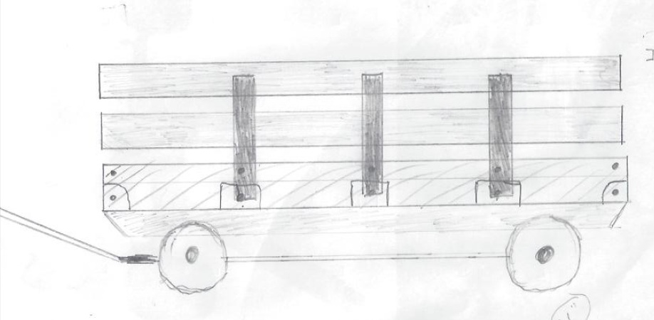

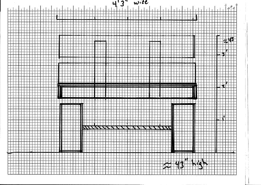

#26

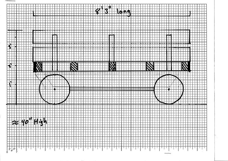

One guys comment on the Farmall Cub forum was that the drawing was not to scale. So, he sent me a grid image, as I could not find any off hand on the bridge, so...I have made them to "scale" using his file...It did not scan as well as I wanted...or in color, but you should get the idea. This is also based on the wheels being +/= 18" high and using a 2" X 10" high stringer. I did not want to have the bed too close to the wheels. Thoughts?? Side View.JPGRear View.JPG
   / Parade/Hay Ride Wagon
#27
I also could not tell, from the Kory website if the 72" wheelbase was from the front of the front wheel to the back of the back wheel...so, I drew in both...cannot really see the shorter wheelbase. But my thoughts about moving the bed back, so I can lift the tongue where that I would rather have symmetry and limited tongue mobility than an off center bed and tongue mobility...I am not too concerned about the space. It will be kept in my back yard.

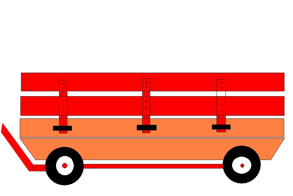

#29
That was one other thought that I was not dead set on yet. I do not know where to put them. If I put them on the middle three, then there is 2 feet at the end, unless I put a support there too. I think, then, that it would look too cluttered with side posts. I do plan on getting the corner bracket connector pieces, shown in the link below. Not sure if they will be enough to support the dangling 2 feet though.

   / Parade/Hay Ride Wagon #30
Easy to add a couple of extra crossmembers to put posts wherever they look best.
Bruce
#31
This is true and I was just figuring where they would go. My thoughts are: The side guard is not that high. It will be 1" X 8" boards on a 2" X 4" stake stuck into a pair of stake holders...I am not going to trust one stake holder. Those stake holders will be through bolted also (the screw holes for the holders are wider than the cross member). So, if I used something like this DekLok piece to connect the crossmembers to the 2" X 6" that will be wrapping the bed, that should hold the 2" X 6" wrapping from warping too much if someone were to lean against the guard. And I still want to be able to remove the side guards too. So, the wrappign is supported by Dek Lok type hardware and the stake holders are through bolted into the wrapping. Can you visualize what I am trying to explain?
   / Parade/Hay Ride Wagon #32
And if at least one bolt goes through all the parts, it will make it even stronger. Visit a Lowes, Home Depot, etc. and look over their framing connectors. Some are thin sheet metal and others may be 1/8 to 1/4 thick. There may be something that will work better in your situation.
Just imagine a 300 pound rider falling against the rail, and design to hold that strain without breaking. :)
Bruce

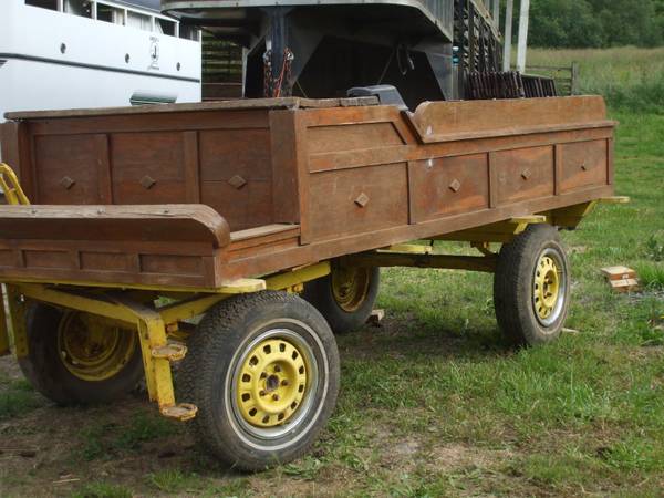

   / Parade/Hay Ride Wagon #34
Be careful not to "overbuild" a wagon. It's not needed and makes the unnecessary mass more awkward to handle. Same with building one too short since it is too limiting for a parade wagon. A better way to make a wagon look smaller is to use a lower profile car tire that puts the whole unit closer to the ground.
A wagon is a simple build as the thread referenced in my earlier post here illustrates. The wood should cost no more that a couple hundred dollars. You really don't need 2" flooring for a small trailer and 3/4" plywood or 1" boards more than sufficient. I've built a number of hay and parade wagons and learned that style and technique make a better looking and more functional wagon as opposed to sheer mass of overbuild. Stringers of 2x12 put the body too high relative to the frame and wheels. And your placement of 4x4's is affected by the relationship to the wheels for clearance.
As well, a used hay wagon frame would work fine--just clean and paint and grease the wheel bearings. If you could find a spoke wheel one with good wheels that might be worth a look. The whole wagon shouldn't cost more than maybe $500 for wagon, paint, wood and lights. Just my two cents here.

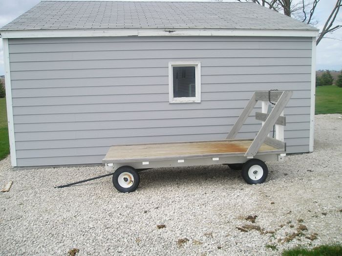

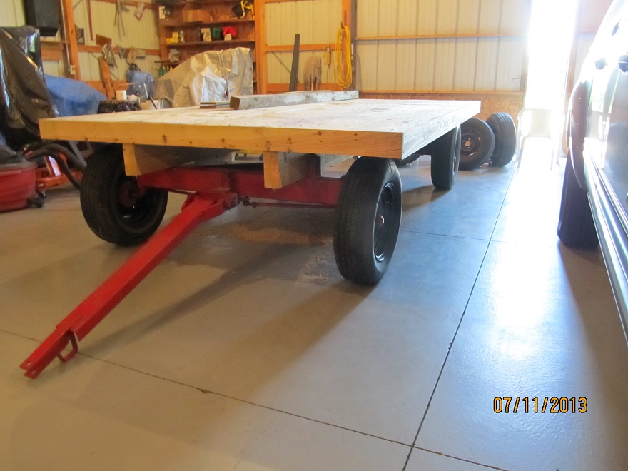

   / Parade/Hay Ride Wagon #36
Kory will be a great gear and 2x8's will likely look the best for stringers. For your 4 x 4's it looks best to have one on either side of the tire and not over the top. You can have the same clearance but it looks more balanced. If you want a plank flooring take a look at the 1" pressure treated boards now sold that seem to have a less-rounded edge than the old style. If you use these I would nail down fast before they warp and leave no gap since they shrink a goodly amount. A problem with any plank floor is they can be somewhat uneven and people can pick up splinters or trip. I really think a plywood deck with a framed edge looks and feels better, shrinks less, and is easier to frame out for a quality look. Spend time picking out 4 x 4's with very little wind and nail/bolt everything together FAST/same day before things warp and wind.
All this is subjective personal opinion but I've built a number of wagons and think I understand the look you are going for. Here's one that's 7' by 12' I recently built that is just for storage of some awkward equipment but will likely double as a small parade wagon. Good luck.
The tire size that seems to look the best is a 7.60-15 rib implement farm tire or the passenger size equivalent of 205-75x15. I have the 205-75-15 on the wagon shown.
Also, if you use 2x8 stringers and 4 x4 posts you will need 1/2 x 12" carriage bolts to put them together. A 9/16 spade bit works best and drills the easiest. The bolts can be hard to find but Rural King Farm stores carries them for a ffair price. Hardware stores occasionally do but the price is often higher.

For anybody that is still following the thread...
I have decided to go with the Kory 3000 model without the additional metal bed. I felt confident in the construction. Chris at Kory was more than helpful too and was able to get it shipped to me with a 1 7/8 hitch modification for under 1K.
I was delayed gettign off my rig an extra 4 days, so I won't be getting to work on it for another week and a half though
But, I will document my building of it wth many pictures from bare frame to finish, so it can help anyone else that is interested in this.
My '49 Cub is getting fully restored by a local guy who does them for people all over the east coast and will not be done until Mid-november...so, I am goingto take this time I am home to build my wagon to my liking. When I get home next time, then the tractor will be done and hopefull they will be a ncie combination. I wil be sure to take pitures of the pair as well!
