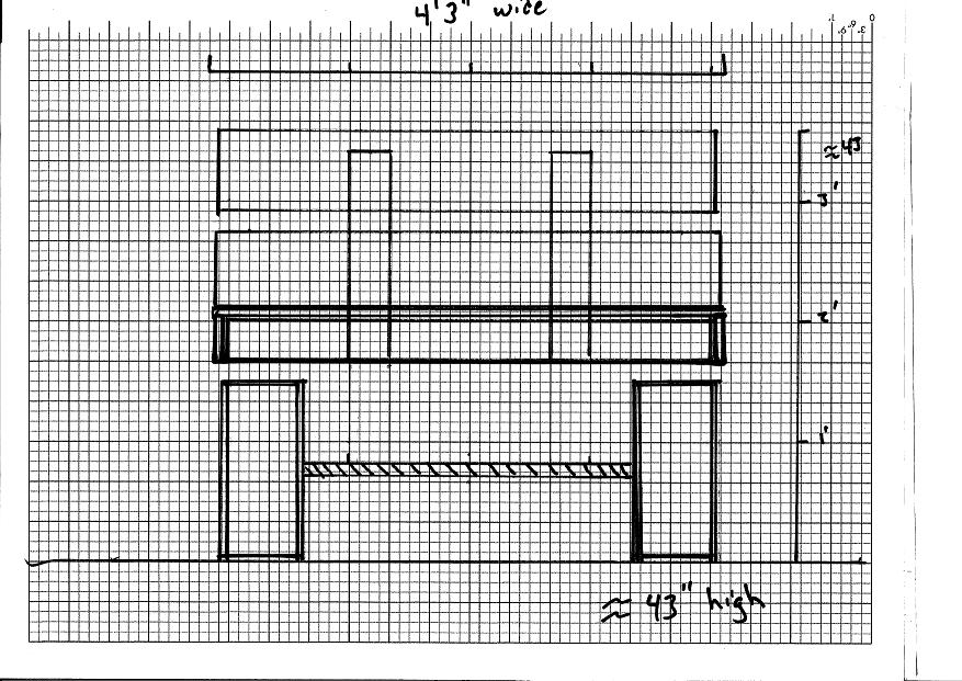

One guys comment on the Farmall Cub forum was that the drawing was not to scale. So, he sent me a grid image, as I could not find any off hand on the bridge, so...I have made them to "scale" using his file...It did not scan as well as I wanted...or in color, but you should get the idea. This is also based on the wheels being +/= 18" high and using a 2" X 10" high stringer. I did not want to have the bed too close to the wheels. Thoughts?? Side View.JPGRear View.JPG
   / Parade/Hay Ride Wagon
#27
I also could not tell, from the Kory website if the 72" wheelbase was from the front of the front wheel to the back of the back wheel...so, I drew in both...cannot really see the shorter wheelbase. But my thoughts about moving the bed back, so I can lift the tongue where that I would rather have symmetry and limited tongue mobility than an off center bed and tongue mobility...I am not too concerned about the space. It will be kept in my back yard.

#29
That was one other thought that I was not dead set on yet. I do not know where to put them. If I put them on the middle three, then there is 2 feet at the end, unless I put a support there too. I think, then, that it would look too cluttered with side posts. I do plan on getting the corner bracket connector pieces, shown in the link below. Not sure if they will be enough to support the dangling 2 feet though.

Easy to add a couple of extra crossmembers to put posts wherever they look best.
