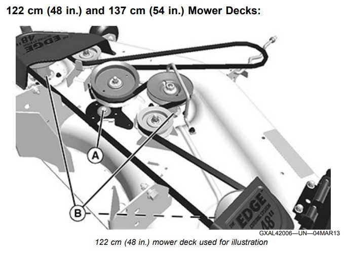

Both my JD riding mowers have three blades, middle blade if set a bit forward so its rotation does not interfere with two outer blades..... Believe this to be true with most belt driven mowers.... So perpendicular is not a valid thing....
I think that this is the norm. I generally mount mine (Kubota) with the center blade in line with the sides of the mower and the two outside perpendicular to the sides. As long as I don't cause the belt to slip, it is usually pretty close when I next pull them off for sharpening--but only pretty close! The design of the mower should make it avoid contact. Don't try it with a two-bladed mower, though, it might not end well.
   / Parallel or perpendicular blade orientation when mounting 3 blades to a mower deck? #17
As previously stated , some decks are manufactured to be more compact. Timing of the blades is important on these to prevent them from coming in contact with each other, the result of that can be very expensive. These decks have "cogged" belts that allow you to set the blades "timing" to prevent them from hitting. Check the belts on your mower, if they do not require "timing" you will most likely have a standard V type belt, smooth without notches. The larger decks have enough space the blades can be positioned without concern of hitting .

A multiple spindle mower deck belt pattern shows the middle spindle has much less belt to pulley contact than the outside spindle pulleys, making belt slip on the center one easy to understand.
