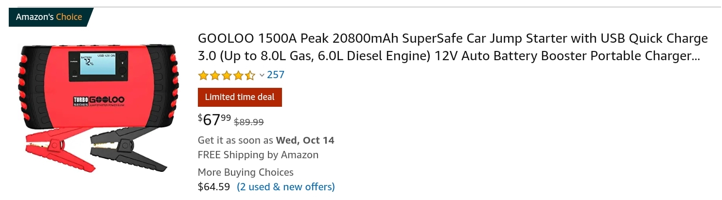

I also bought one of these and carry in truck. They're very small and stay charged a long time. New battery technology. So far started truck, zero turn and 4 cyl Kubota. Two thumbs up.
