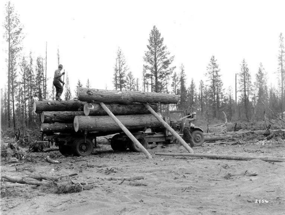

For the small operation that doesn't or can't use spar tree loaders.

That's how my Dad did it 60 years ago with an 8N Ford. :)
Necessity is the Mother of invention.

Maybe there's a bear charging off-camera?

Again, I see a truck sitting on about $10,000.00 worth of planks!

Depending on the situation, I still sometimes parbuckle logs onto my trailer. I mean why do I need the Gov. to tell me how to do or not do something, when COMMON SENSE will already take care of that!
I've also parbuckled logs off my trailer too,

Parbuckling! So that's what you call it. Back in the days when Woodmizer was one of the few bandsaw mills available, their ad literature often showed a cable hooked to the mill at two points going under the log and being winched up a ramp by a different cable attached to it's middle. I never knew that system had a name.
Thanks to Sawyer Rob for the pix.
