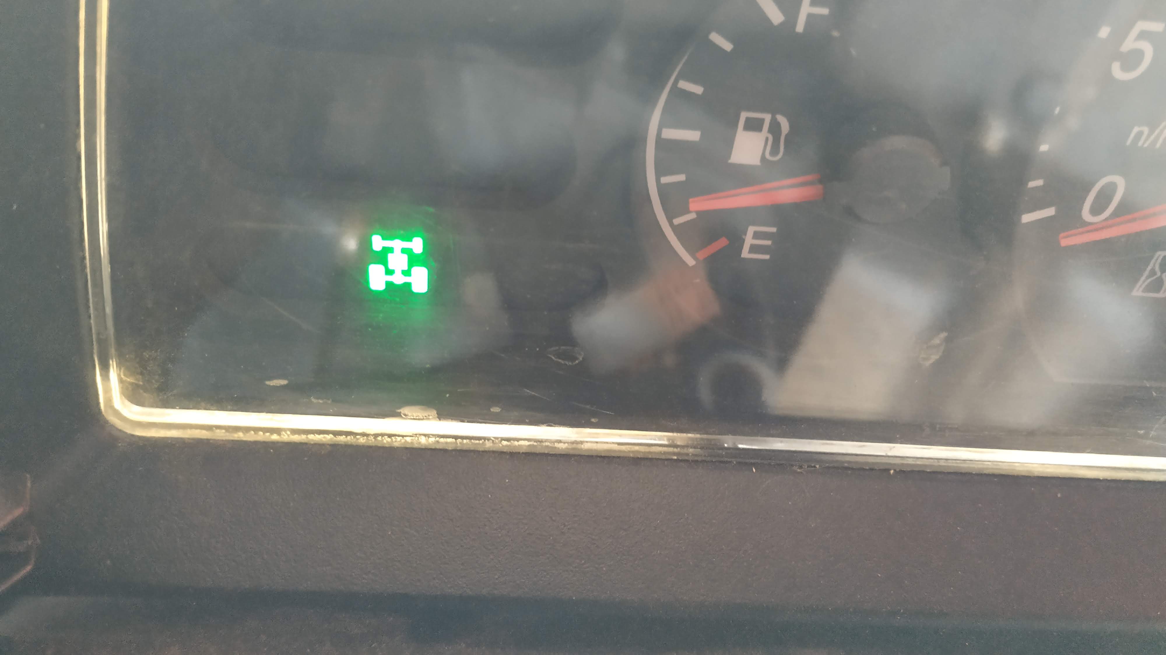

   / Parking Brake Light? #38
Took the covers around the dash off, figured out the right pin on the plug, confirmed with the multi-meter that it needed indeed a Positive wire, rigged a wire from the pin to a 12V source and Bam! Smoke all over the place. :D Joking, got the green 4WD light working!
Now, on this quarantine times we'll have ahead, I'll find a sealed switch, build a bracket for it and do a proper wiring job. I do need to find a 12V source that works with the ignition. The fuse-box does have some spare spots but I don't have the right terminal to put it there.
   / Parking Brake Light? #39
That magic smoke is always fun to make appear!! :shocked:
Nice work guys!
#40
Seeing green, now I'm jealous!!! I'm going to look into seeing if I can get the 4WD indicator working too. Let us know ptsg if and where you find the right terminal for the fuse-box, and I would also like to know what "they" use to connect the wires into the back of the instrument cluster. I jerry-rigged mine so expecting a smoke show at anytime, looking for a good place to mount a fire extinguisher lol!
